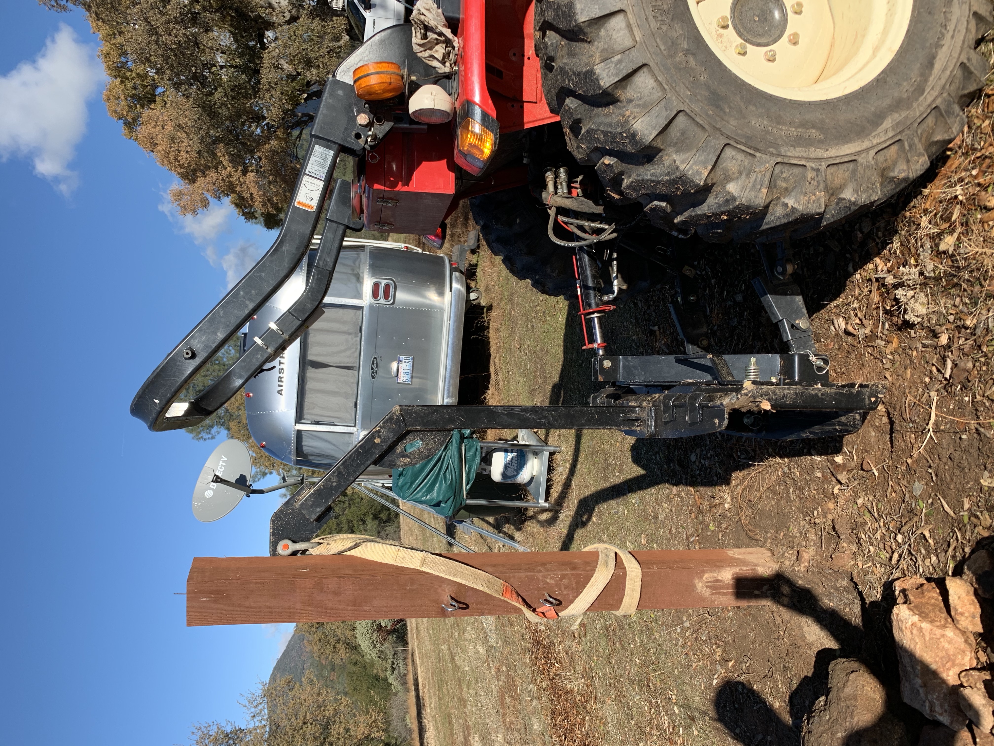

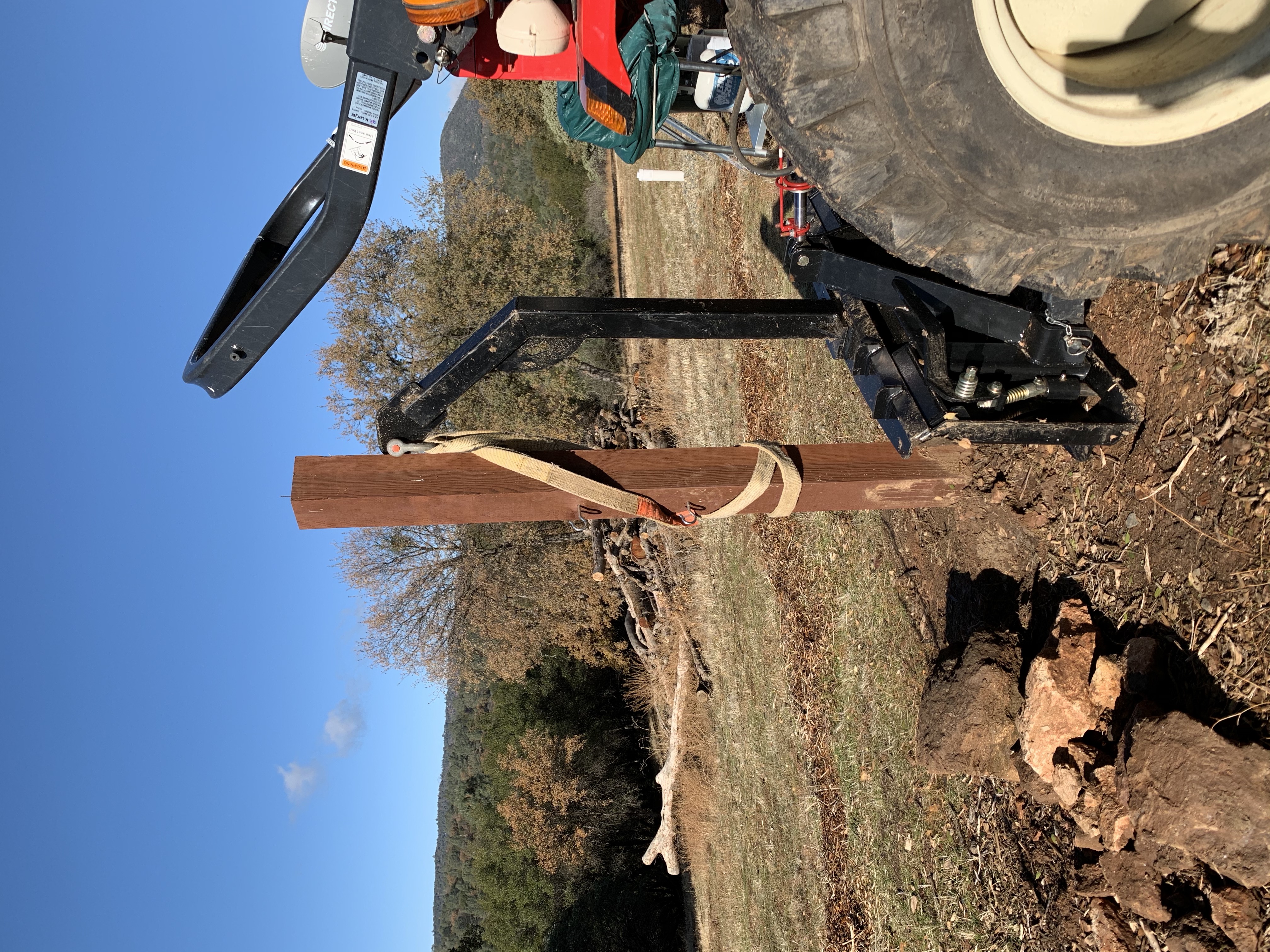

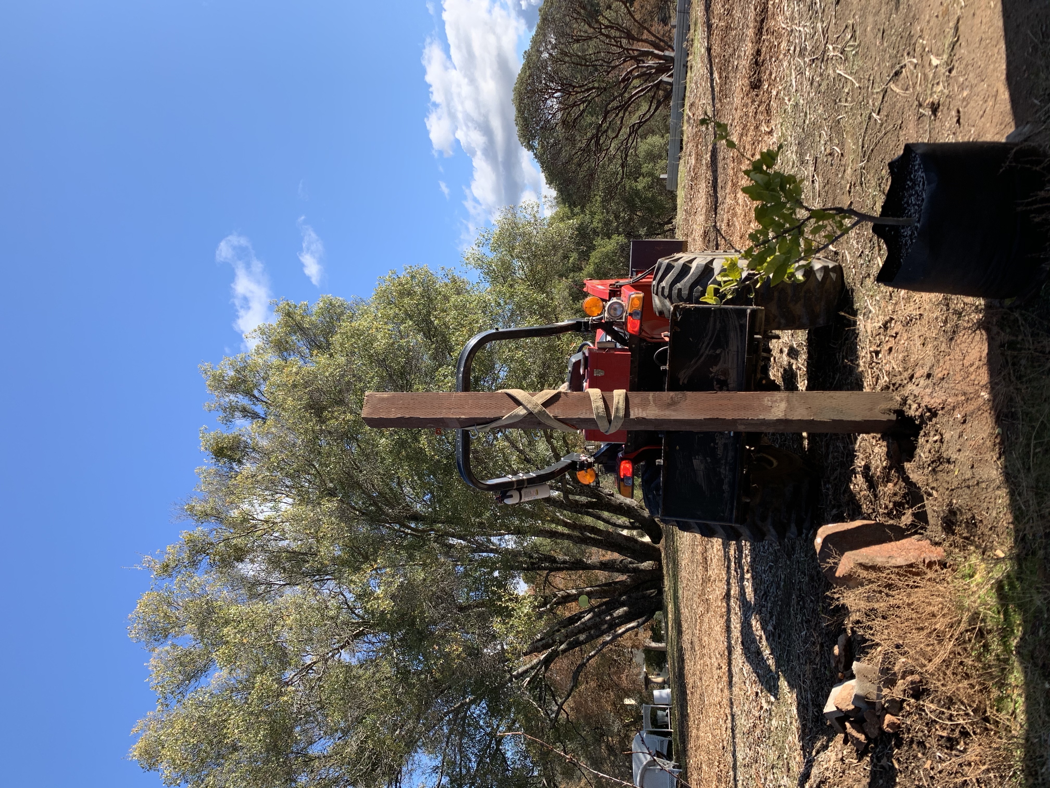

Pulling 6x6x8' posts out of the ground. Shoulda set 10 footers in the first place so re-doing it. Mostly I wanted to show you guys the:
1) 3 Point to Universal Quick Tach Adapter and
2) 60" Tree Boom Attachment.
I purchased both from Titan attachments for about $600 including taxes and shipping.
