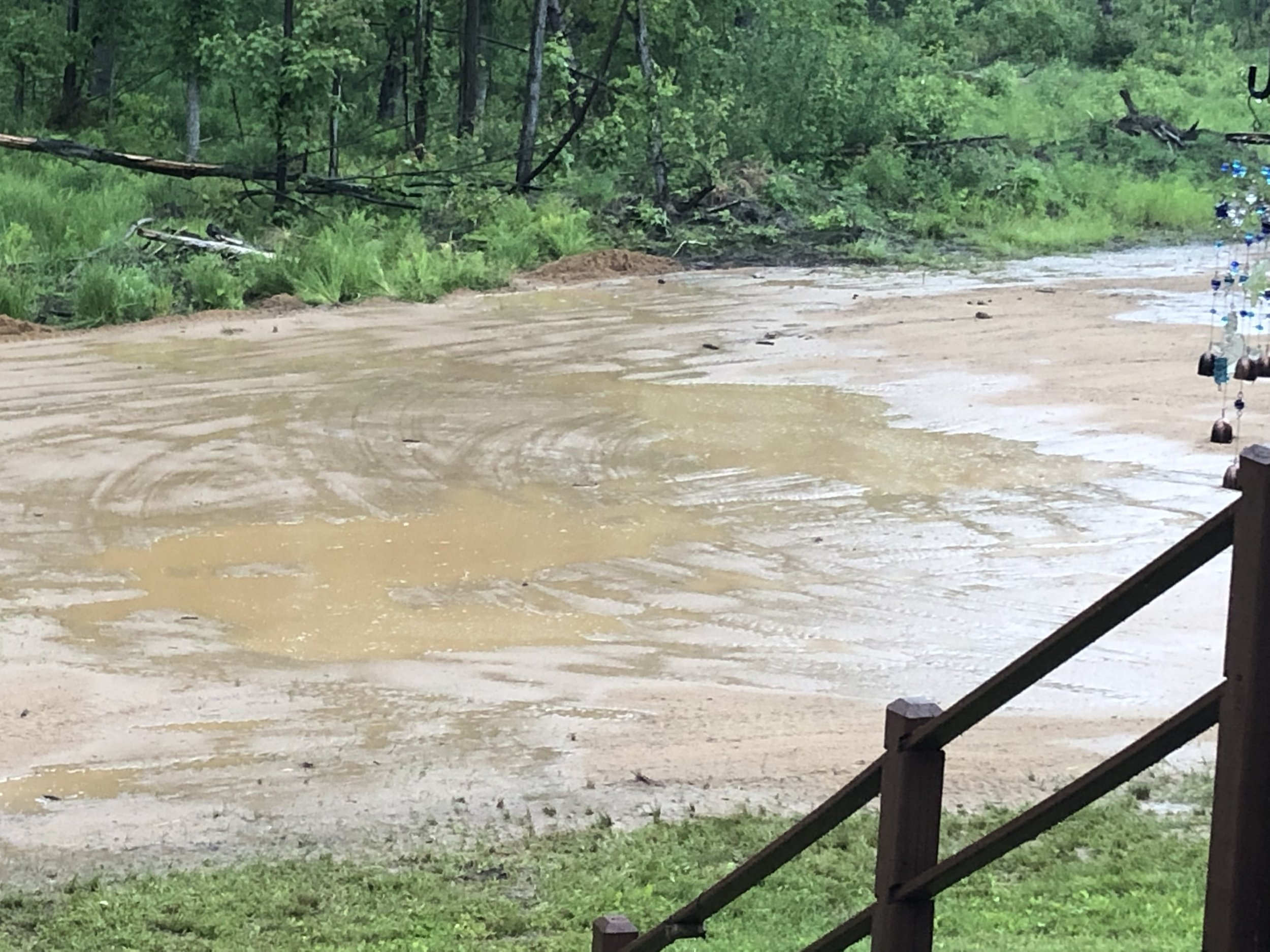

Well rained very heavy and puddles have formed . We shall see how long it takes to dissipate.

Looks like it held and did not wash out at least. We could use some of that water down here if you want to send it our way. (y)

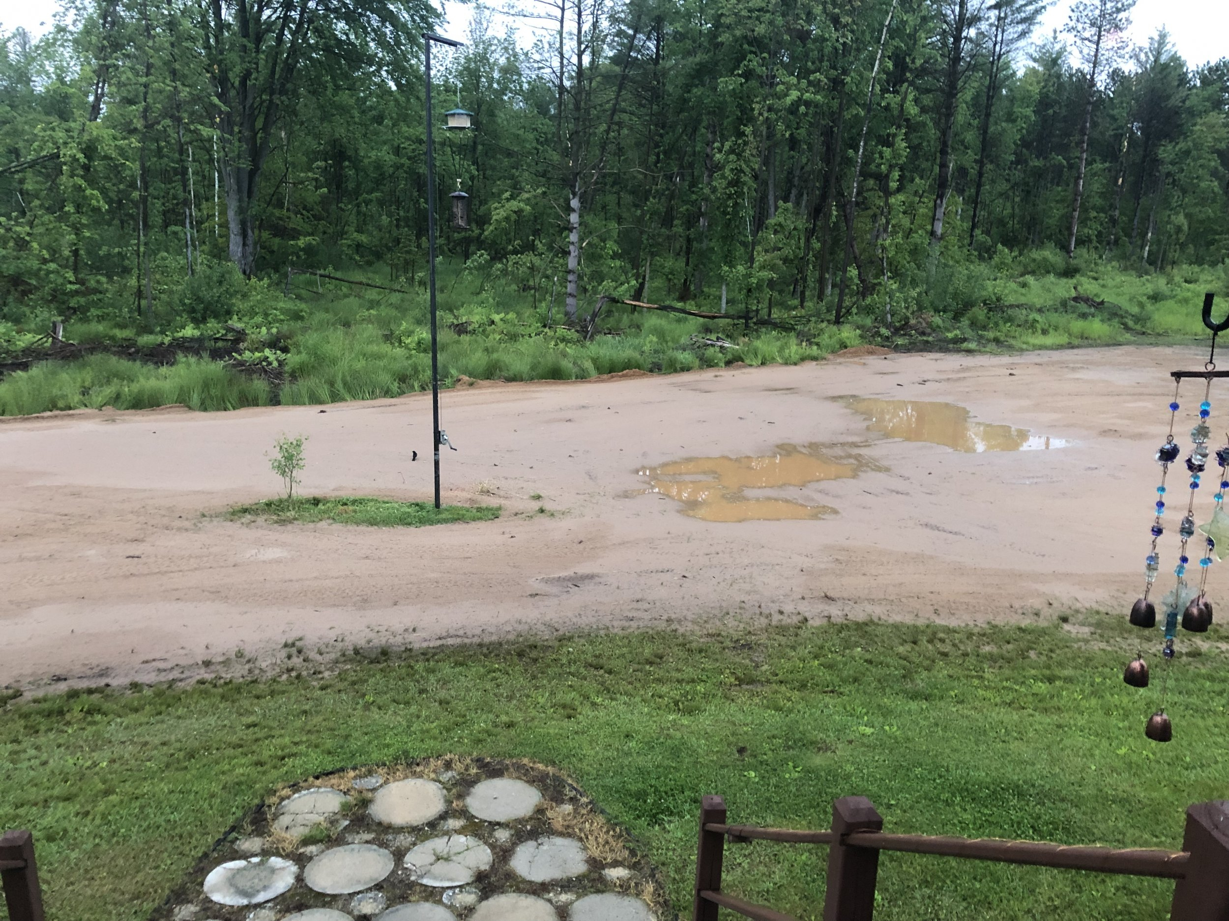

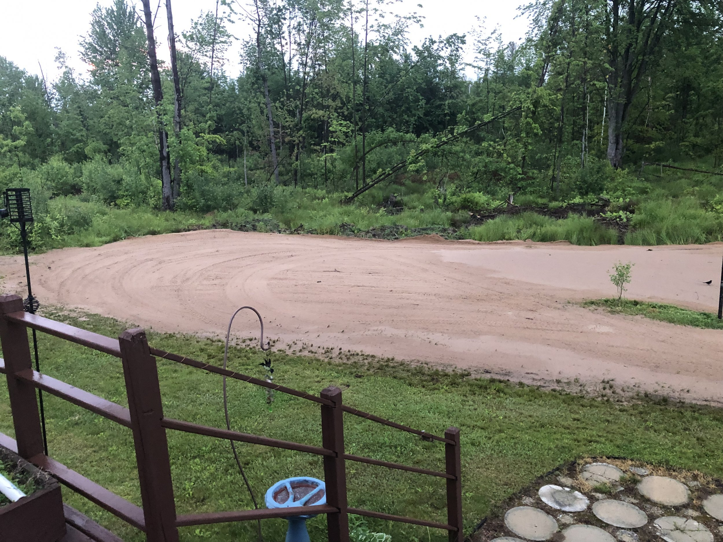

Well less than 2 hours and a lot less water 👍. The upper section turned out great .

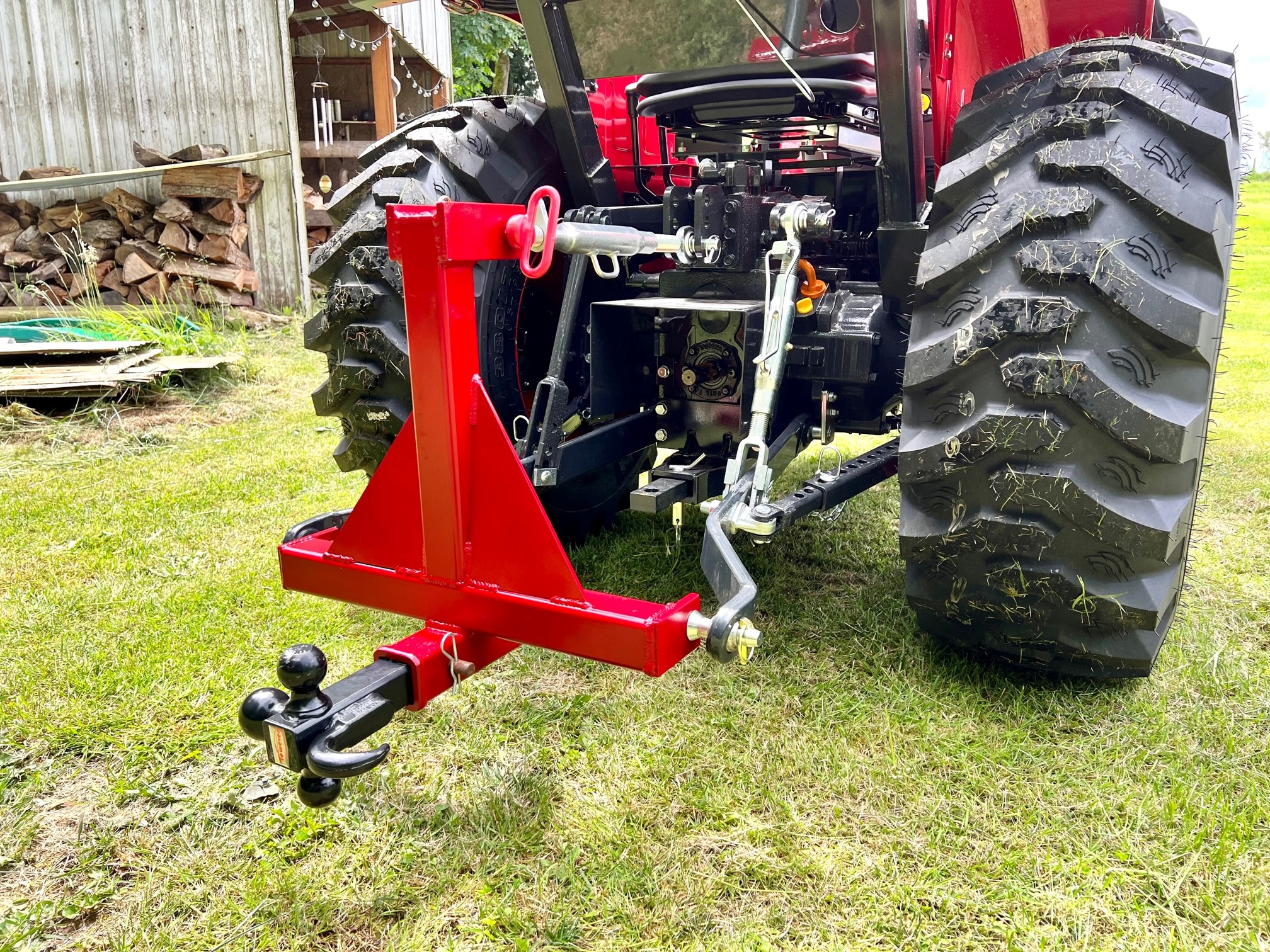

built my own 3pt hitch to move trailers and stuff around my yard.
Looks nice, I made mine to be able to handle goosenecks as well.
I also use a saddle mount for my pins to pass through. One of my concerns was the chance of trailer tongue
getting light either while loading or going down grade so I have limiter chains going down to the drawbar.

Those indeed are nice looking trailer 3 point hitches, Deezil, Lou, They both look professionally built. I made one for my tractor, not nearly as nice, but functional. It works good for going forward quite well, but for some reason I find it is extremely hard to back a trailer with a tractor. I am guessing it is the closeness of the hitch to the back wheels, I am not sure. I am pretty good with backing a trailer using my truck, but have a much harder time using the tractor to back a trailer up as the trailer easily jack knives. (Maybe its me??)
As a solution I made a hitch that quickly mounts to my FEL bucket. I can push a trailer extremely accurately into a tight parking spot using it. I use that device much more often.
