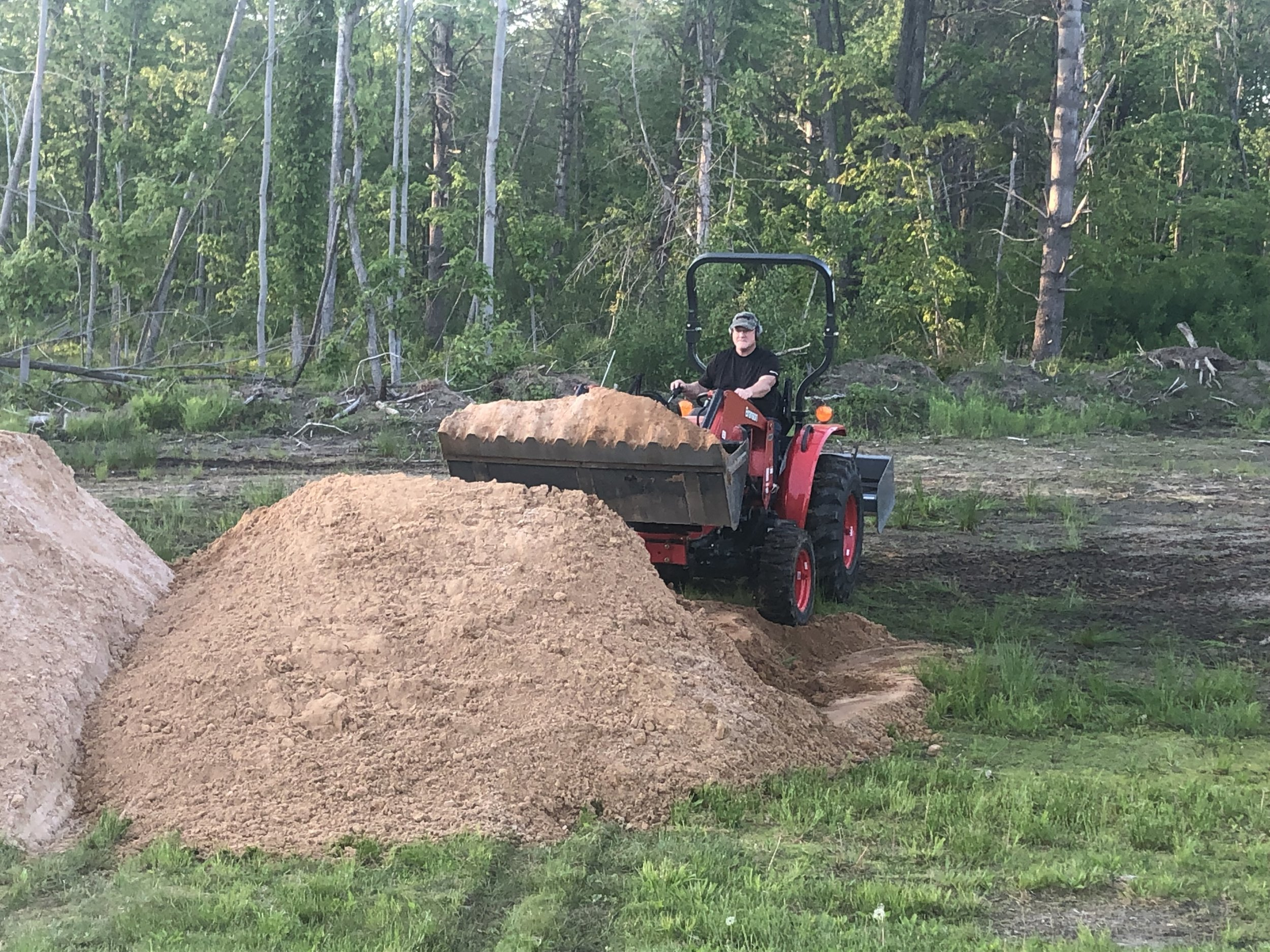

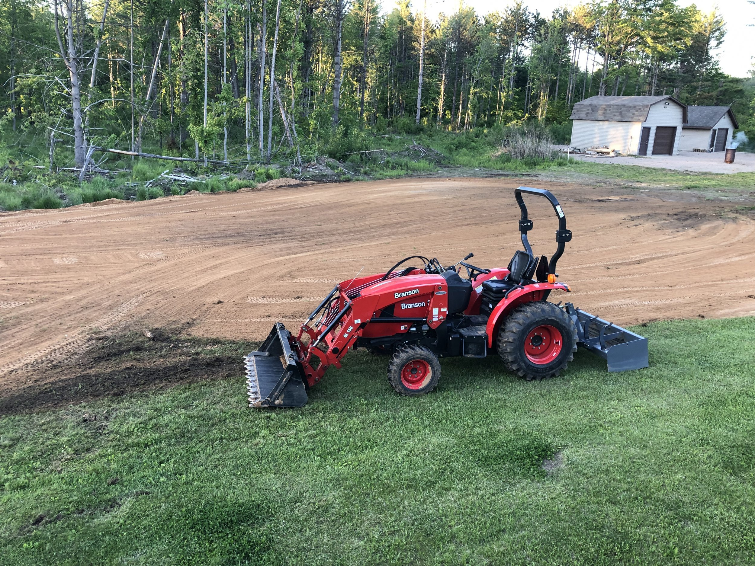

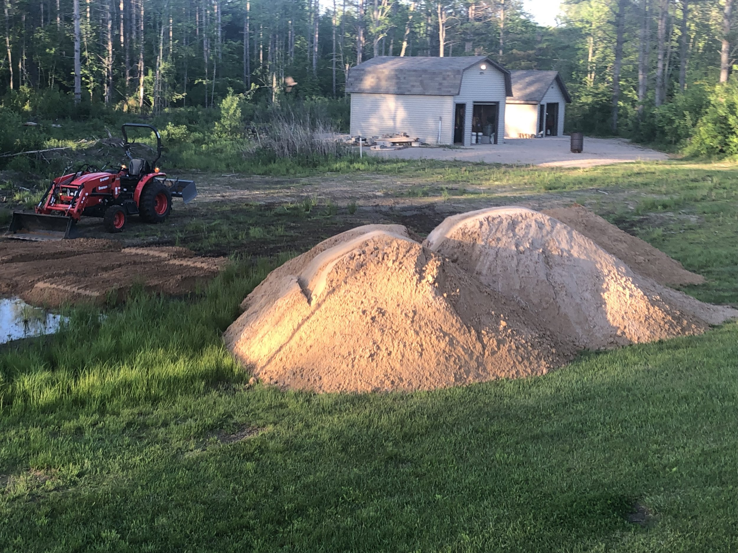

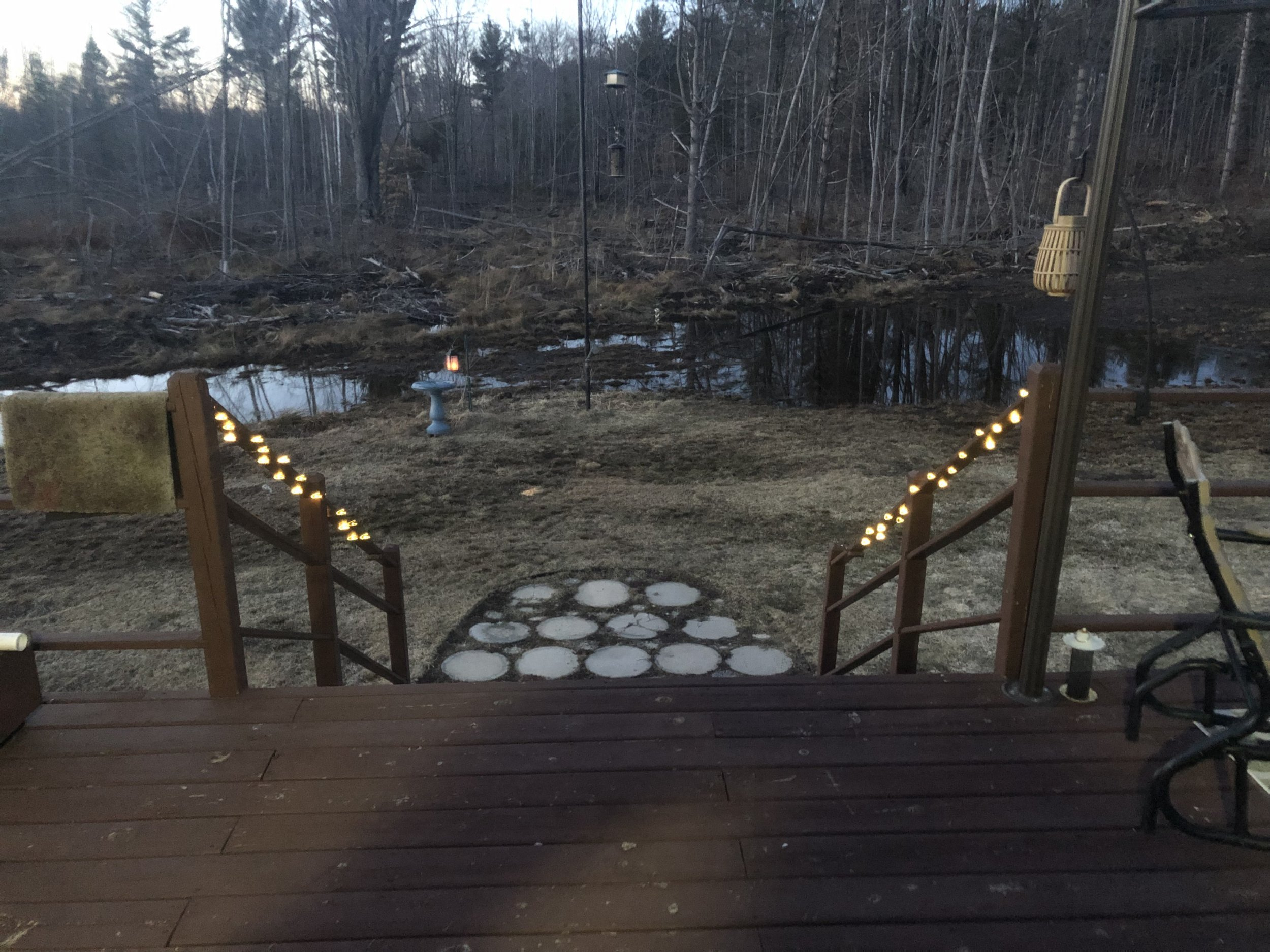

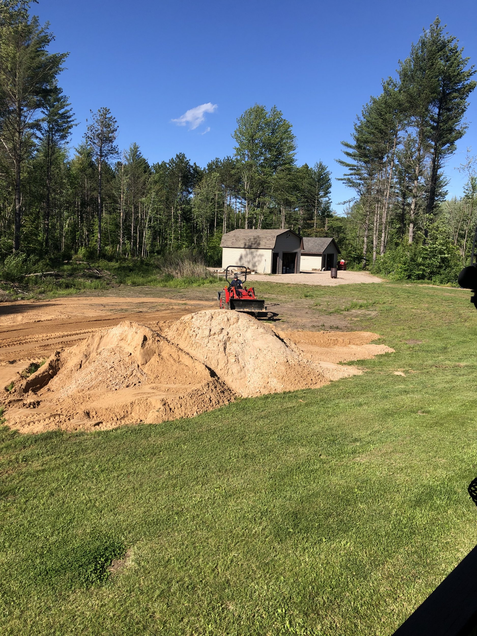

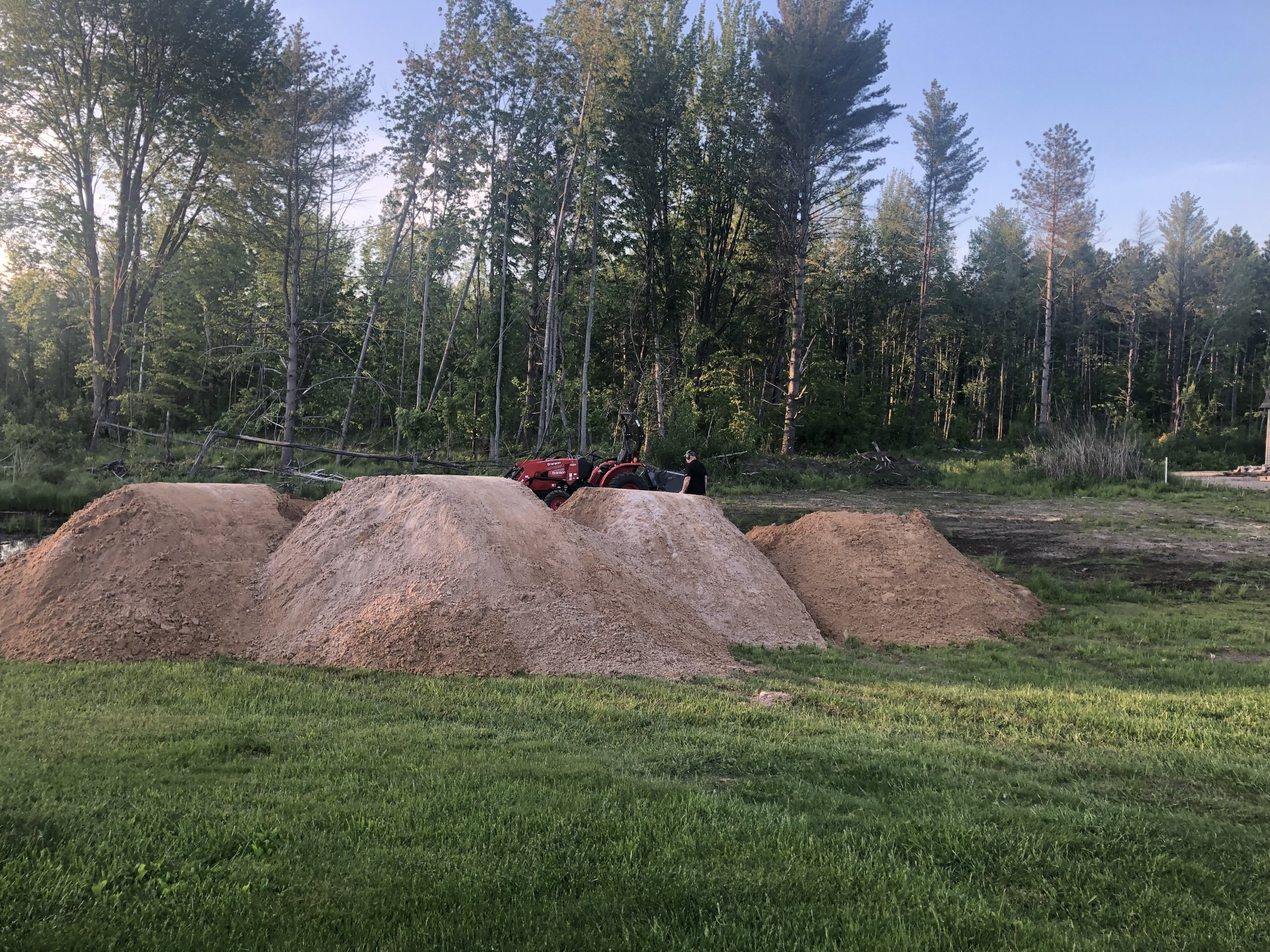

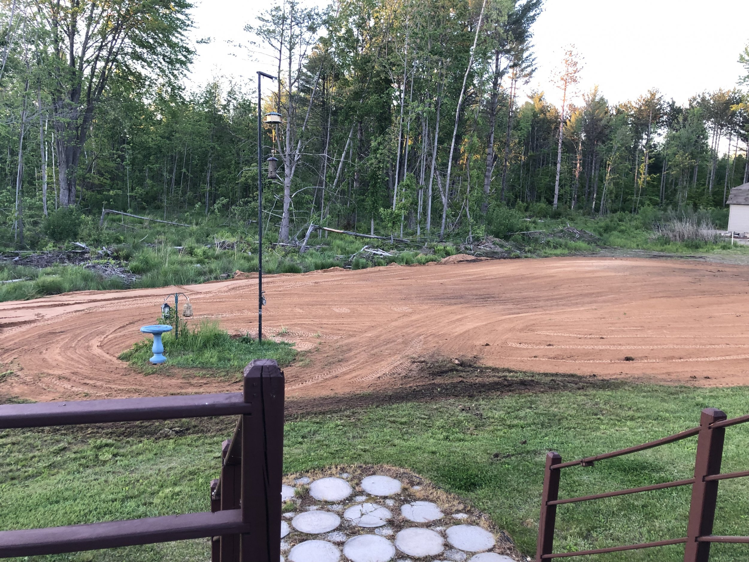

Well this spring was really wet !! Our back yard at the cabin basically turned into a lake 😁. We finally got some time and five Quads of sand . So far I’ve built it up over a foot .

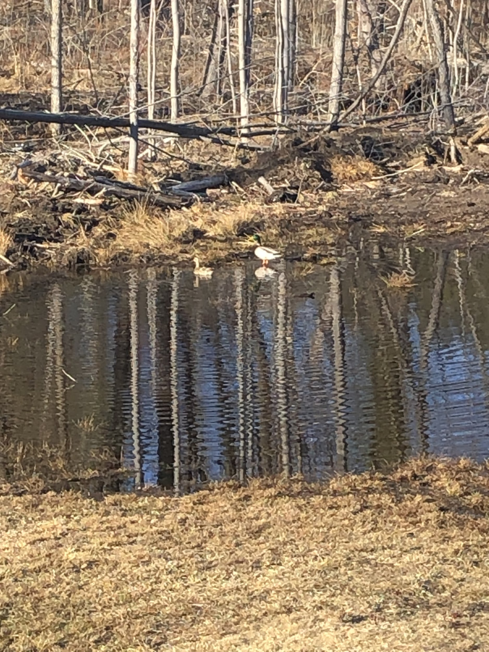

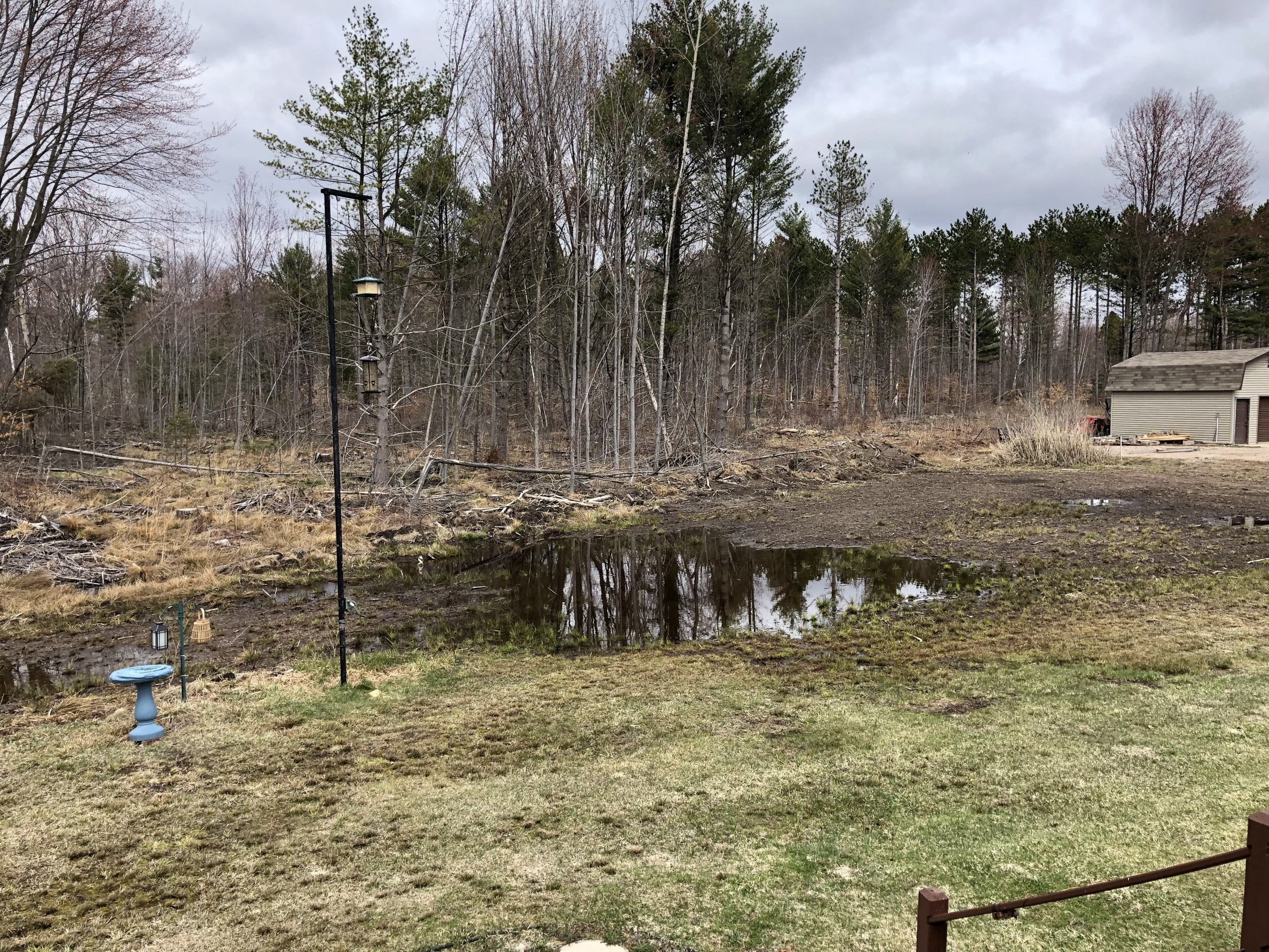

We Nicknamed it Webster lake ha ha .

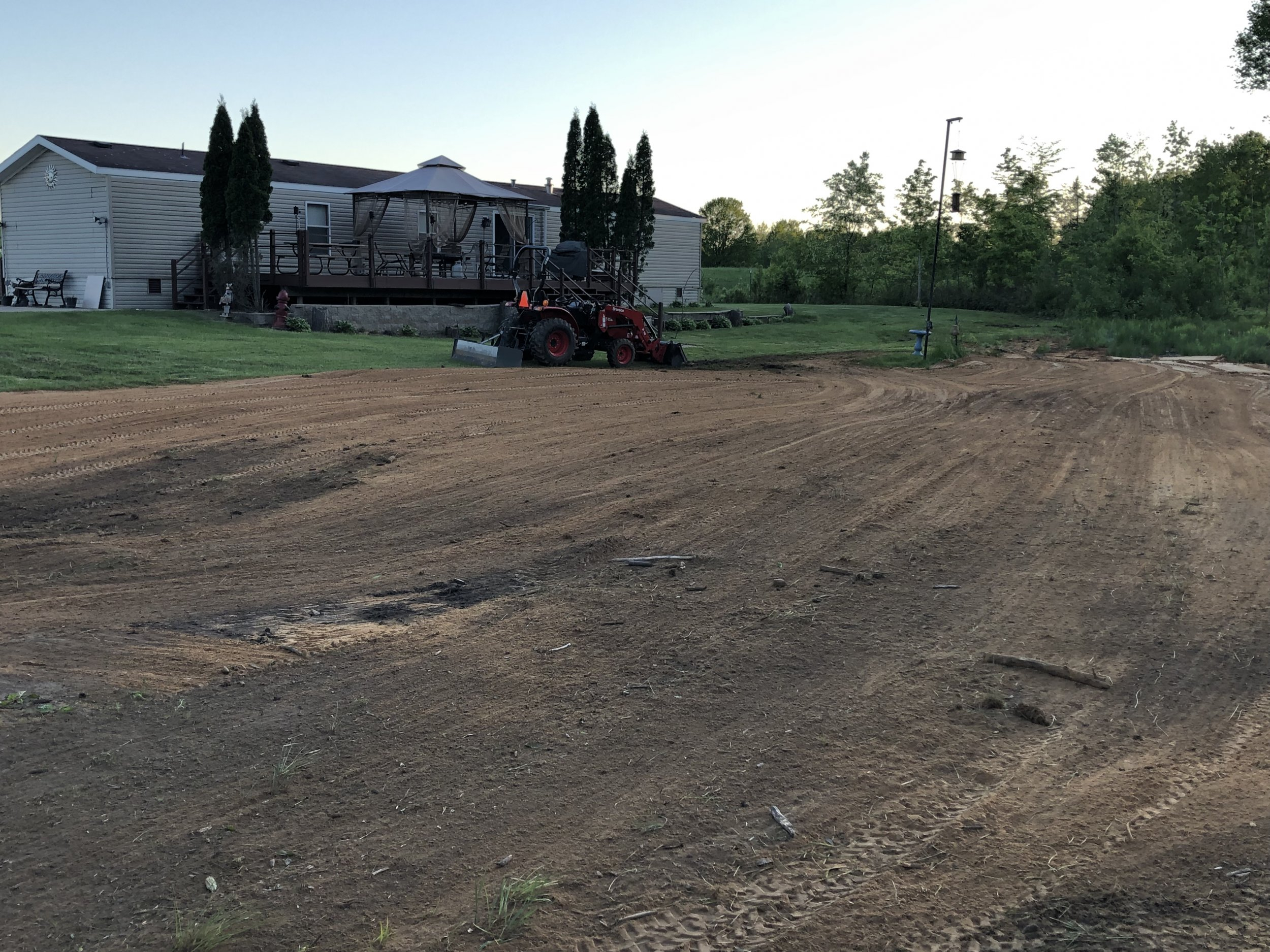

I think it turned out great !
