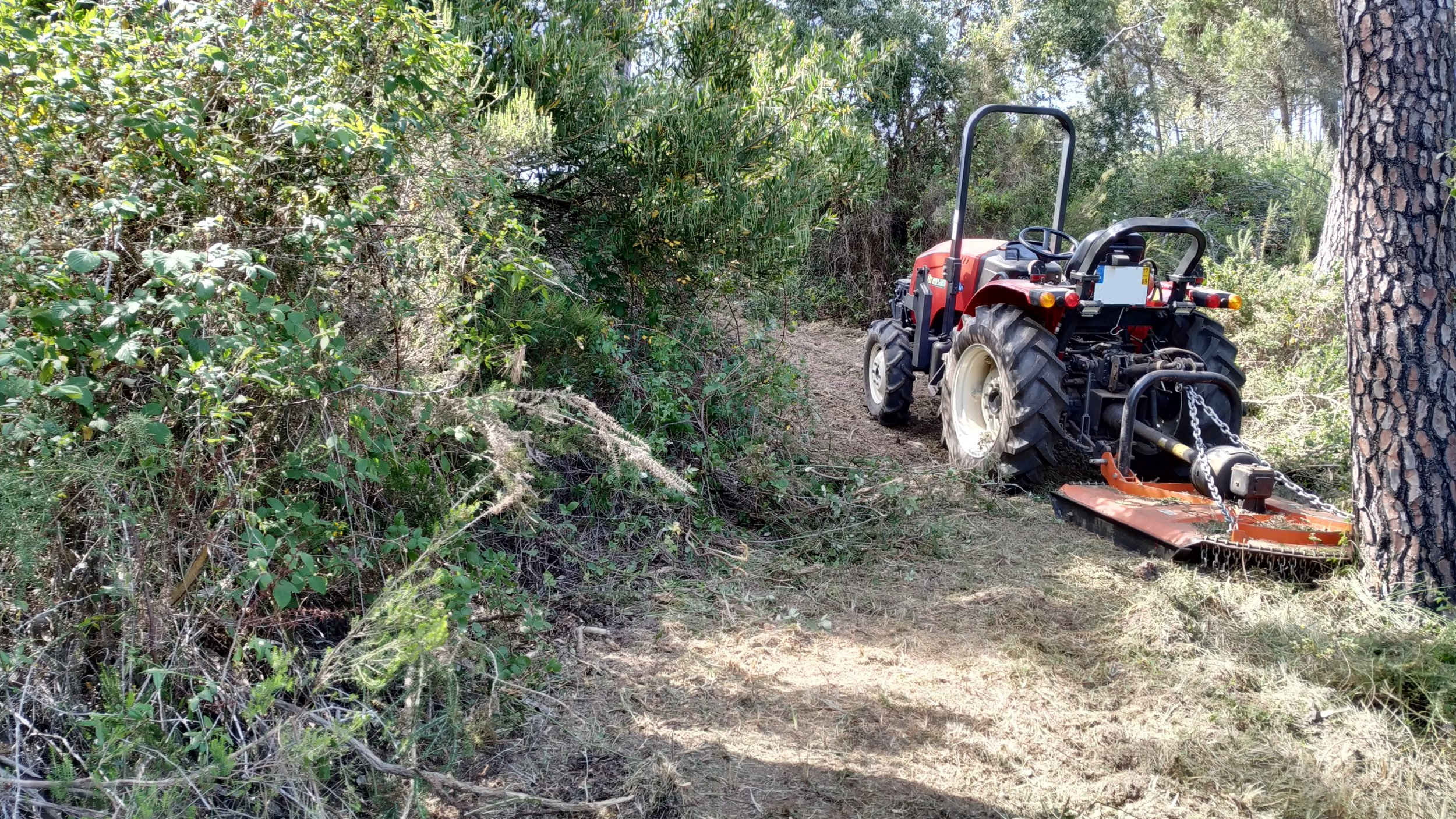

Today I was mowing another place we inherited recently that is severally overgrown since, well, since the almost the entire mountain burned on a massive fire in 2005. This place is a 20 to 25 degree slope, so very tricky to work on, specially when there hidden holes from the stumps that burned on that fire, along with fallen rotten trees from previous storms. Extreme care and attention is required to mow it.
Anyway, the place is somewhat dislocated from the village but has a paved road to it which only means one thing. That people will go there to dump all kinds of trash. Turns out I found a piece of broken glass that cut right through the front tire but somehow didn't reach the tube.
Now, do you guys know if this can be fixed somehow, or should I start looking for either a new tire or an used one? The cut it about 1 1/2" long.

I would break it down and put a boot patch in it and see if it would hold. I have had good success with that before. I even had a buddy use CA glue on a gash in the sidewall of his pickup. He wore that tire out and never had another flat on it. Lol
Something like this.

I would do the boot patch like the previous poster, but I would also sew the hole together. Use an awl and some bailing wire. Or perhaps fill the hole with some kind of liquid rubber that hardens

I have used superglue to fix cuts in bicycle tires. You need a way to spread out the cut to get the glue in there. On a bike tire I can pinch the tire and flex the casing to open up the cut. That's probably a lot more difficult with a tractor tire, especially if it's still mounted on the rim.
If there's a chunk missing then the superglue won't work.

Thanks for the ideas guys. I'll see if I can source some big patches locally and work something out. I have a couple tire shops within 2 or 3 miles, maybe they have something like that.

Some of the older tire repair shops could vulcanize sidewall and tread areas. I've also seen tires sewn up with heavy cord and light wire. I was not impressed with the light wire it actually cut it's way through the rubber.
A heavy boot on the inside for strength then rubber cement and sewing for the gap.
Unless you can find a shop that will vulcanize it.
