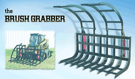

I have owned both styles, clamshell and L bottom. You can carry more brush with the L bottom.
Here is a good thread on the different styles: http://www.tractorbynet.com/forums/kubota-owning-operating/372194-enjoying-new-grapple.html
Here is one with a very large opening, but I don't know what it weighs: Brush Grabbers | Young's Welding, Inc.
