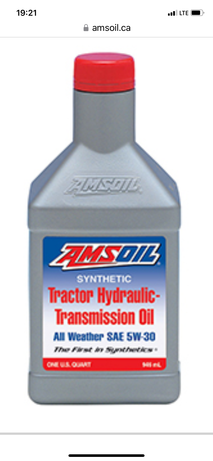

You mentioned hydraulic fluid in your original post. You have an HST tractor. I also have a CK30HST, albeit a MY 2014.
Is the oil in your tractor hydraulic fluid? If so, It needs to be Tractor Hydraulic-Transmission Fluid, as the same oil is providing hydraulic AND transmission operation. Picture is what I’ve installed at the first service.
Currently at 640 hours on my tractor with good results. This isn’t intended to turn into an oil thread, but I just want you to confirm that the oil “type” you installed is the correct oil for your tractor, irregardless of brand.

Hello Robin,
THANK YOU for your post. What I did was literally call Kioti and asked "What type of hydraulic oil can be used in my CK30H. I was told "Any synthetic hydraulic oil". I took my manual to a local NAPA store and asked them if they could cross reference the list to some of their oil. That is what I used.
I supposed what you suggested could be the case, which I have NOT considered. So my tractor is now at a Kioti dealership having ALL fluids/lubricants replaced with filters, etc.
I told them about the issue and asked them to figure out why this was happening. My pump pressure is within spec. My flow rate is a little under the spec. They said, when they tried it out, the front wheels did lift off the ground "MOST" of the time. My question when I called to see where they were was "Why not ALWAYS". They really didn't have an answer.
BTW...I did use the Amsoil in my Ferris Zero Turn I picked up from another Kioti dealer who stated that is what they always use for HST units. Seems OK.
So I wonder, can a slightly low flow rate cause this? Anyone have any ideas?
