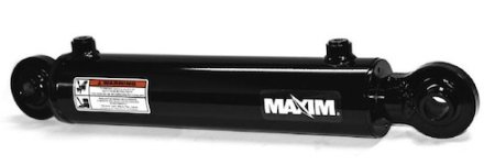

I'm putting together a hydraulic system that uses a GM automotive power steering pump to run industrial valves and actuators (one rotator and one cylinder). I've been trying to figure the best fluid to run that will be compatible with all components in this system. Will standard hydraulic fluid upset the automotive p/s pump? Can I run ATF? What would be my best bet?

This is exactly the crux of my dilemma. I have a hodge podge mix of different parts in this system. To clarify, I am running a new GM Type II power steering pump. It is feeding a pair of solenoid proportional valves made by Wandfluh. Downstream is an Intermercato RMR3 rigid rotator and a cheap 1x12" DA small cylinder. The valves were $1K each and the rotator was $3.5K, so I really want to be careful not to run something that will upset the seals or whatever in those units. On the other hand, I'm weary about running something that will disagree with the automotive p/s pump. However, the pump is one of the 'cheaper' parts in this system, so I suppose it wouldn't be the worst thing if it became damaged and had to be replaced.
For a while I was thinking about trying Mobil1 Syn ATF, but now that I've learned about JD Hy-Gard and similar fluids, I'm quite curious about that. It sounds like 'performance' hydraulic fluid, and seems like a great fit for the most part, but that's a totally non-scientific gut feeling. It's a bit less expensive than most premium ATFs as well which is nice.
To summarize, here's what comprises my system. All parts are new.
- GM Type II automotive power steering pump
- Wandfluh solenoid proportional valves
- Intermercato RMR3 rigid rotator
- Generic DA cylinder
What would you run?

All kidding aside, it sounds like I can just about run any decent quality ATF or hydraulic oil as long as the viscosity is in the right range. Factors such as cost and availability may be what ultimately steer me to the right choice.
