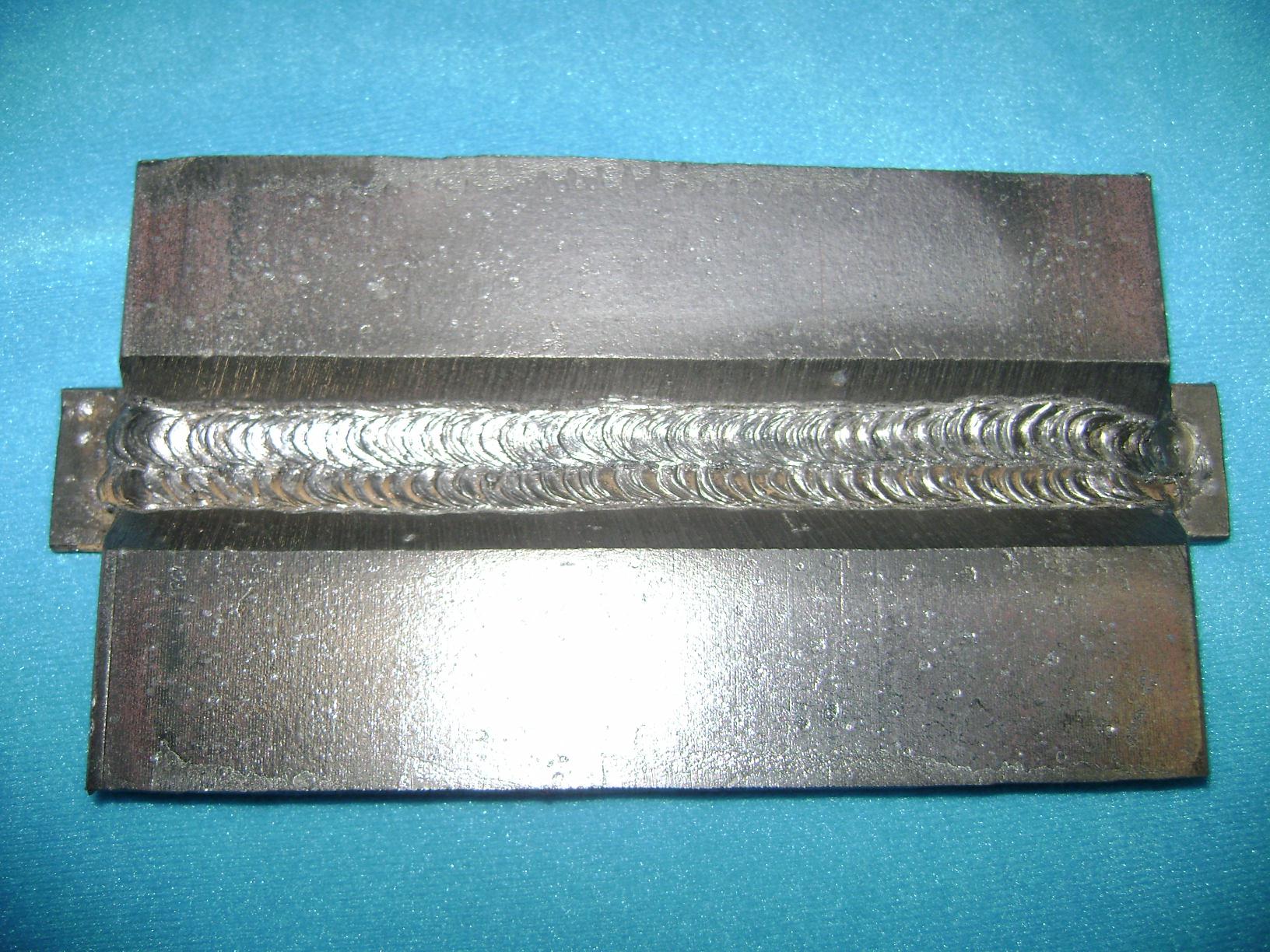

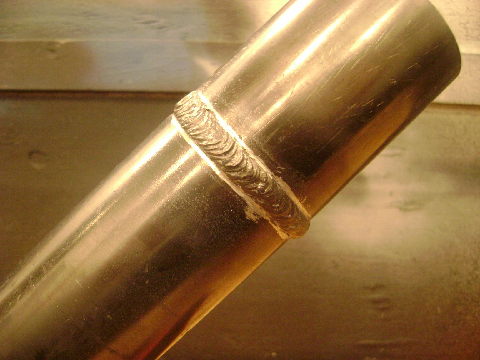

3/32 6010 or 6011 has it's place, but with you just starting out I wonder if you might have a hard time seeing what's going on. Might even be hard with 1/8, (for now) I wonder if you pickup a few pounds of 5/32 if it would help you to see the very sought after "stack of dimes" look?
I was afraid that 5/32 rod might need too many amps for the metal I have to play with. If that's not a problem, I'll have another look.
Are you guys finding 6010 to be more expensive than 6011? Tractor Supply could order it, but for $7 more for 5lb than the rest of the common stuff. $20+ per box.
I've read that 6011 doesn't work as well with DC as it does with AC, something different in the flux. Is the difference enough to hinder me learning on it or does it make sense to put out the effort to find the 6010?
thanks,
Ian
if you go to any big box store that sells the minimum of welding supplies, you'll find 1/8" 6011 and 7018. that should tell you something. it doesn't mean that they are always the best choice for any given application, but they are certainly the most common. i grew up around a farm, and it was always an old ac only welder, and an old box of 6011 rods. the very non-technical reason (from an old timer) was that 6011 will weld steel through a quarter of an inch of cow****. it's pretty true really. it will strike and maintain an arc on all manners of rusty and coated metals easier than most any other rod.
you can do perfectly acceptable repairs and fabrication with them, though another rod (and/or dc welder) may allow a skilled operator to produce a more aesthetically pleasing weld. i've used 6011 on dc and it works fine. i think the best thing you can do is to try a box of each of a few types and see what you you like best for the work you do. rod and polarity choices will not make you a better welder instantly. if you have trouble making a good weld with 6011 on ac, then you won't magically make a good weld with a different rod on dc. it's the technique you pick up along the way that will allow you to make the good welds. certainly, once you have some practice, you will probably find that dc is slightly easier to work with.
