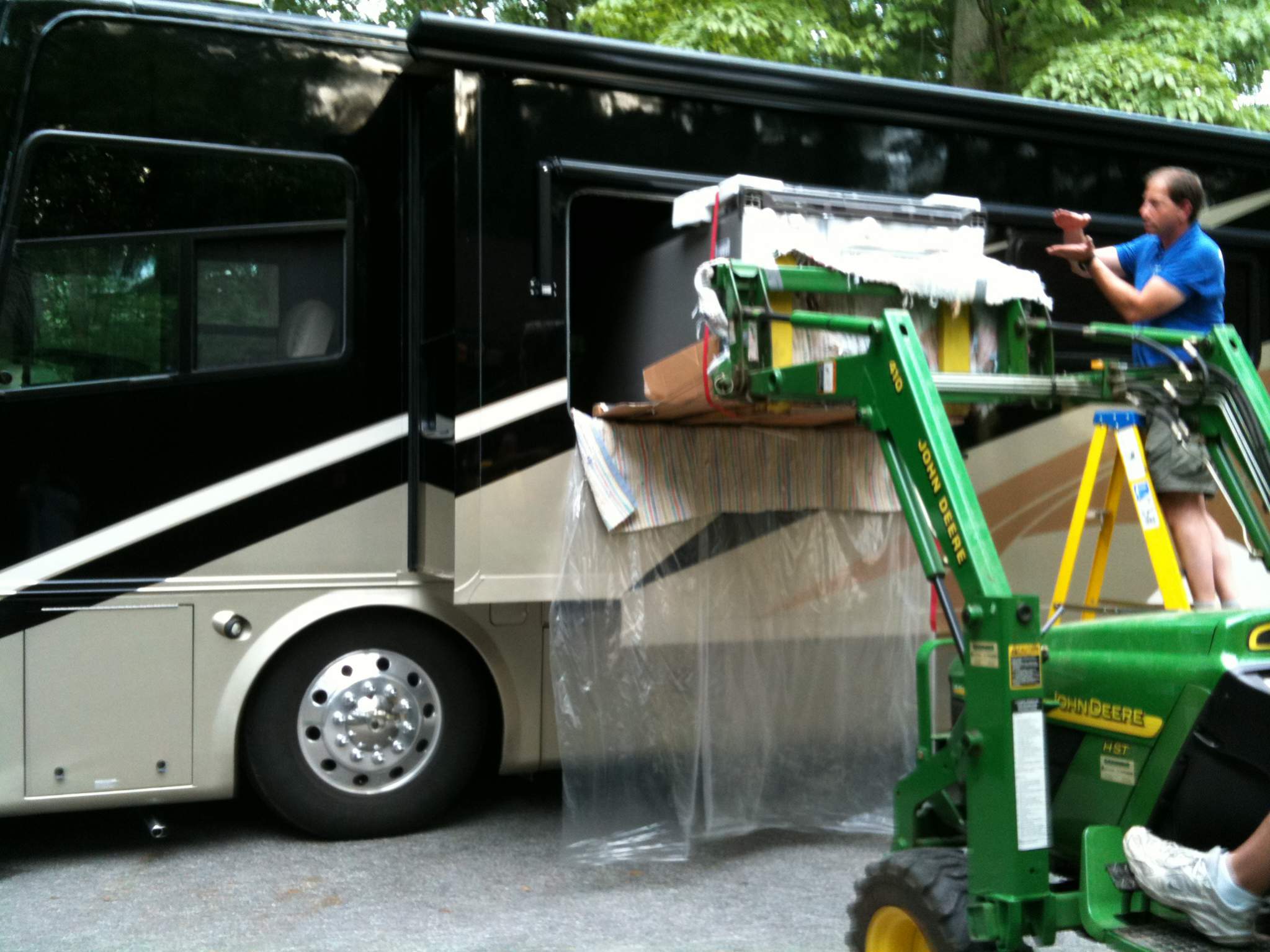

Helped my friend/neighbor unload the old, then load a new fridge into his bus a few years ago:
This was my older heavy homemade set, now I have the Artillian ones that are much lighter so I can lift more.

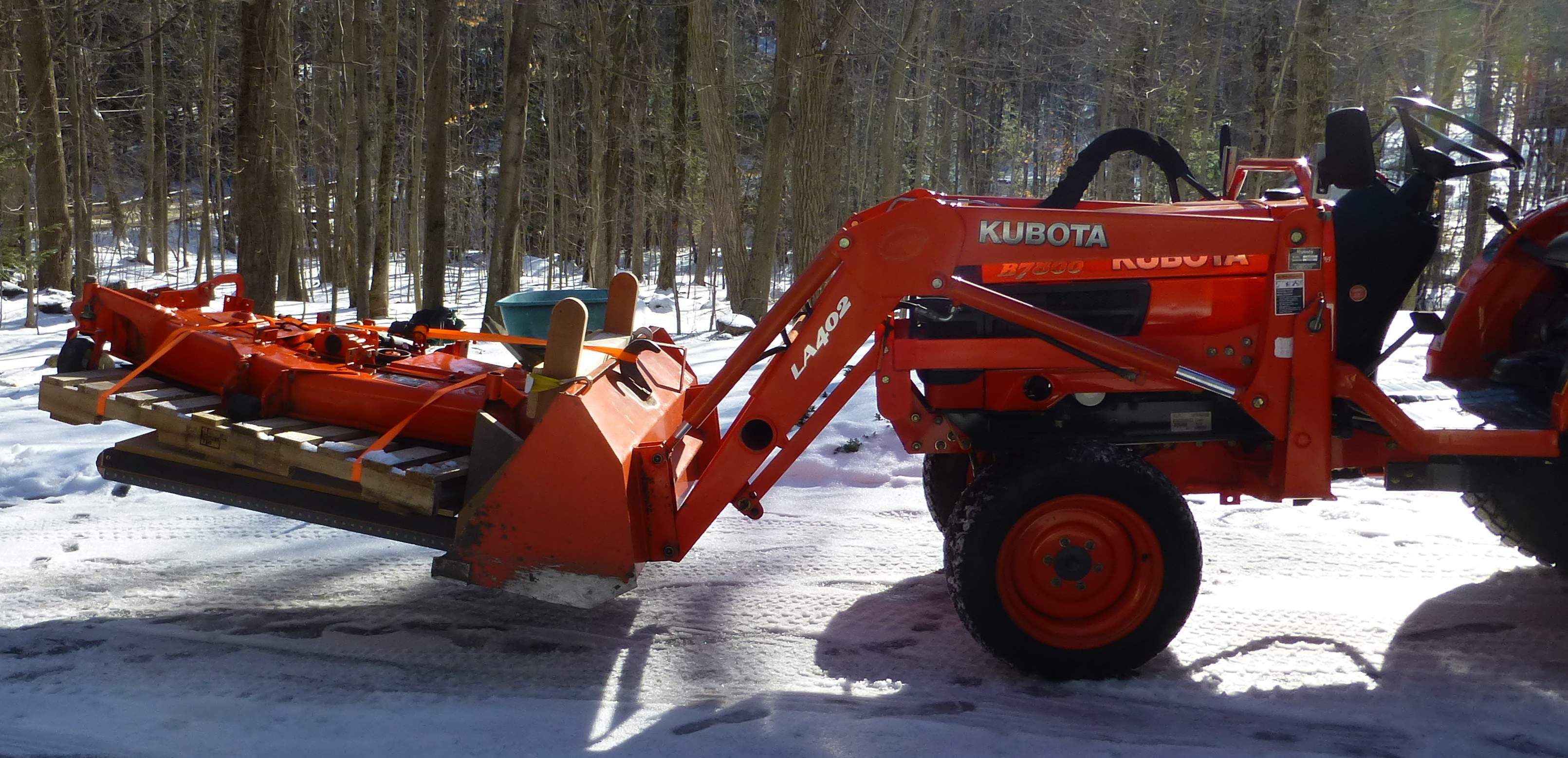

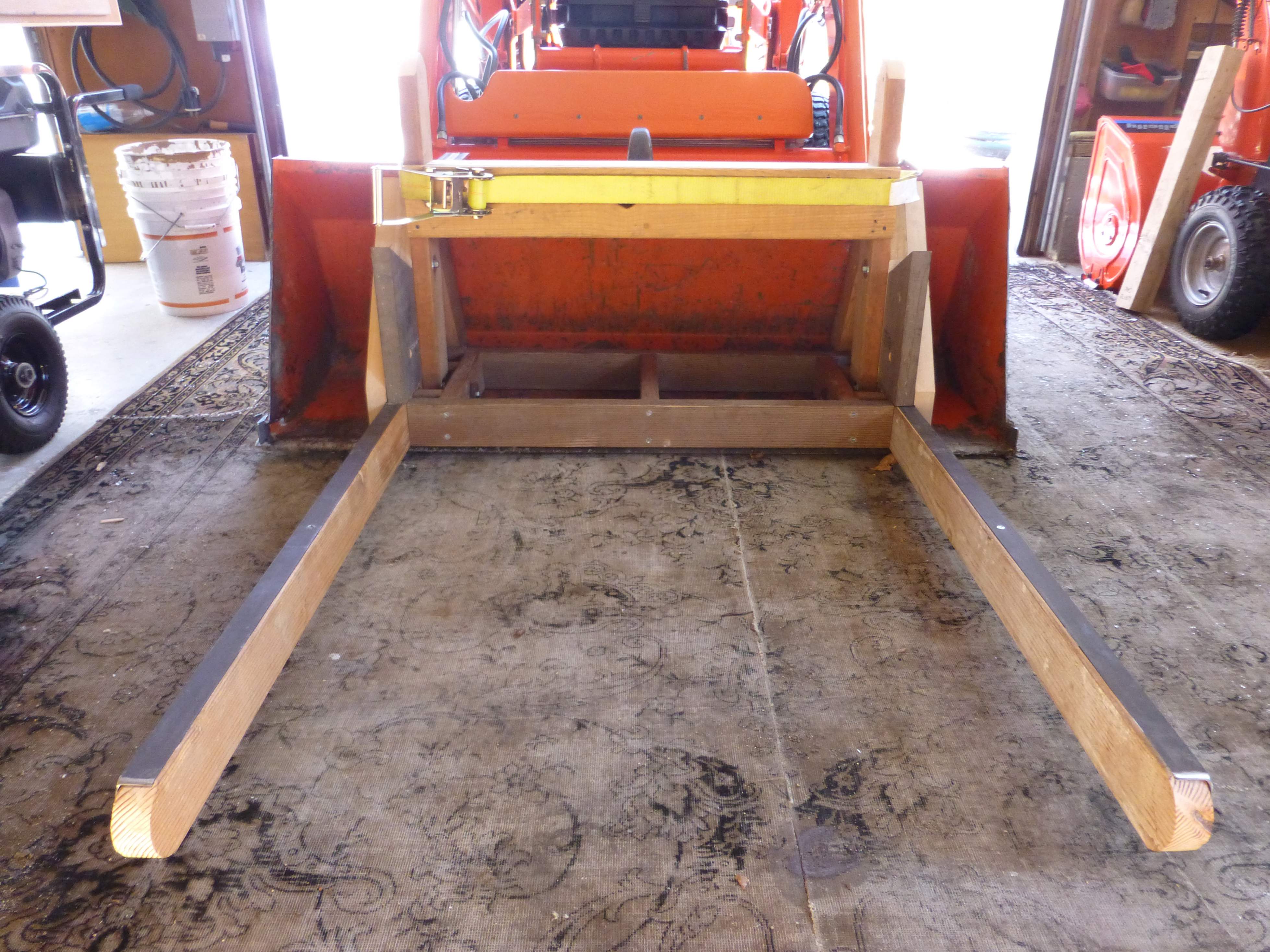

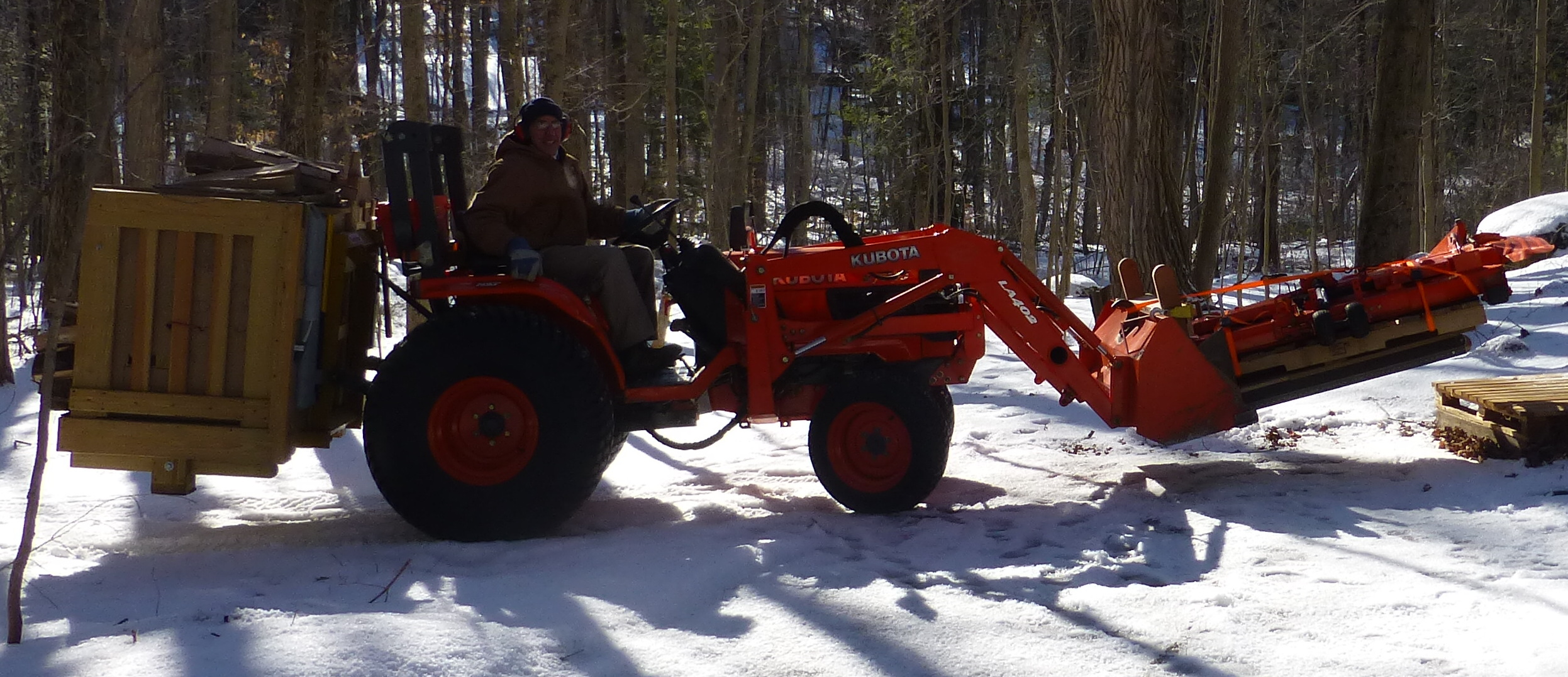

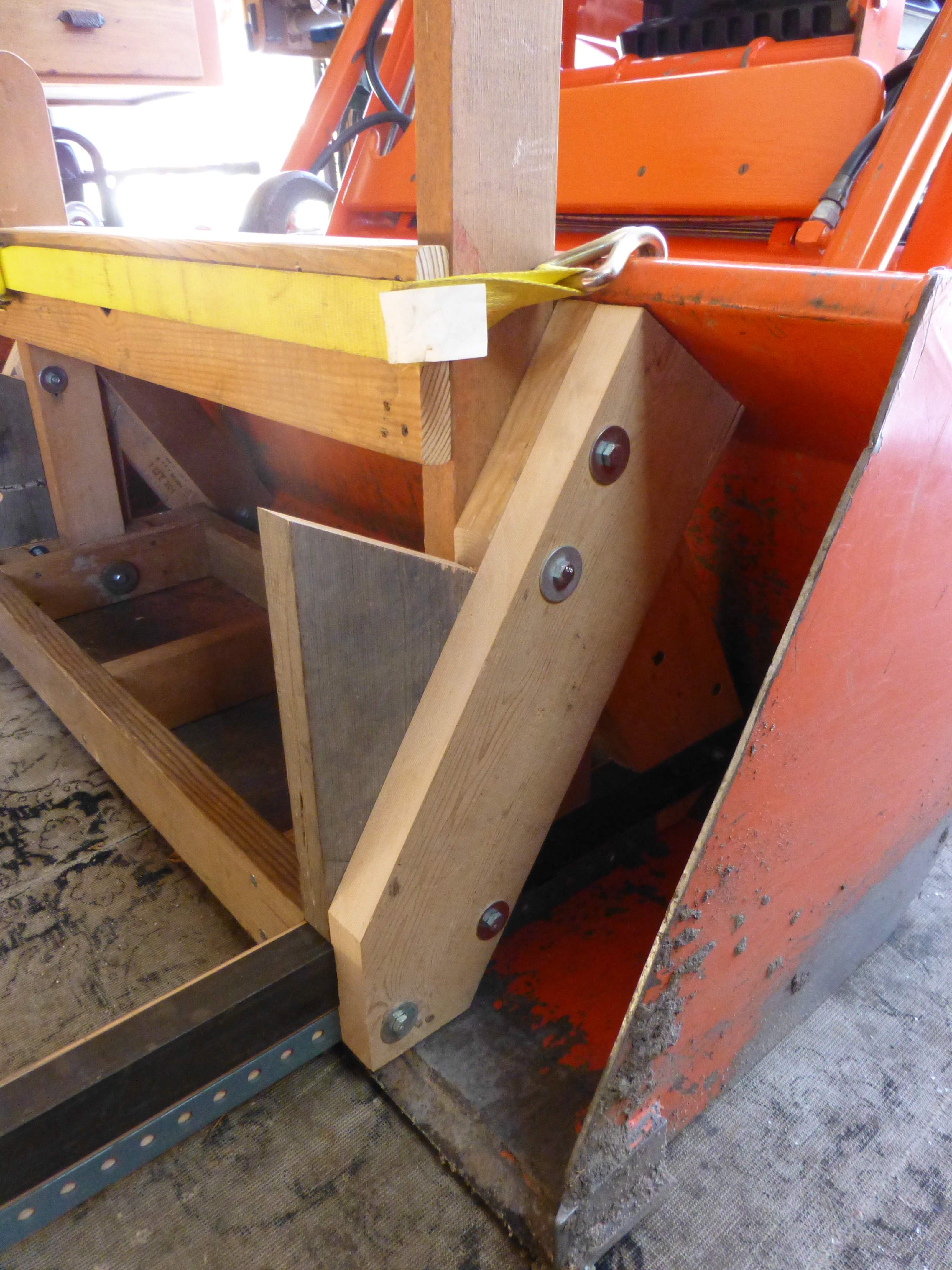

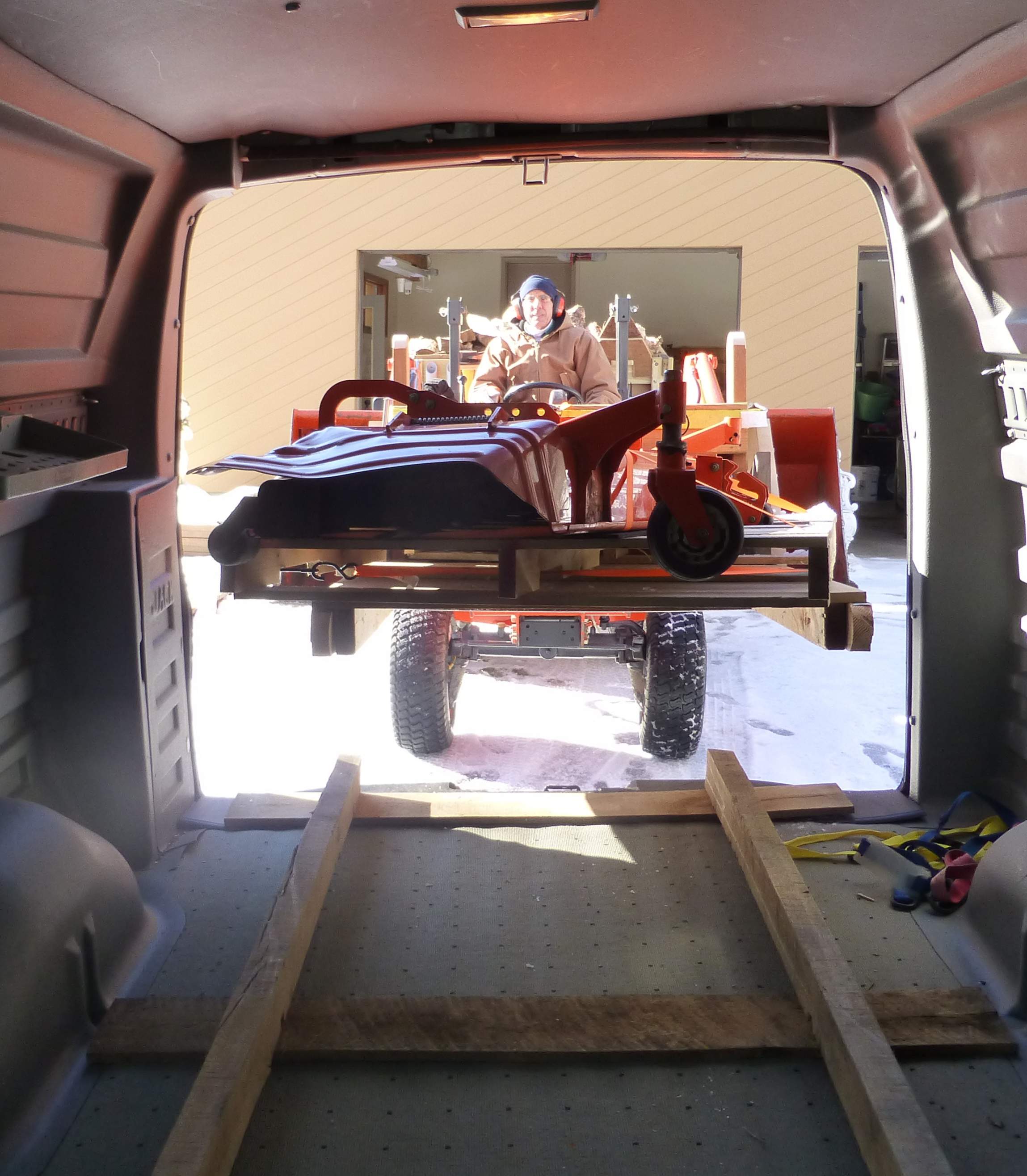

Wooden forks did the job today.
Sold my MMM to a fellow TBN member in Arkansas and needed to move my it from storage in the icy woods, to inside my cargo van.
Not owning a set of forks, I had to fabricate a set out of wood.Today was the test run and they did great. Easily lifted
the mower with it positioned perpendicular to the bucket. Use one HD strap to secure them to the bucket, placed a scrap
piece on pressed board over the forks, slid the pallet on, P1040954.jpgP1040950.jpgP1040953.JPGP1040956.jpgP1040957.jpgP1040946.jpgP1040947.jpgand off we went. Posted some photos below.
