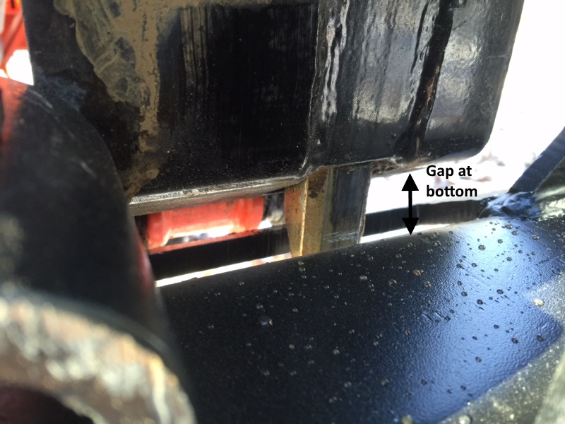

   / What do you do with your forks? #166
That is way too much gap, it will allow the frame to slide up and come off the top of QA.
If it only comes off of one side it will likely bend the QA, as there have been many threads here on that problem.----------------------
Xfaxman, correct on all accounts. When it popped off the QA, it was from the bottom, though. That's how much gap there is. They bounce like crazy when going up my driveway. I'll take a look at the thread you supplied. Obviously will be calling Titan tomorrow as well.
If it came off at the bottom while pushing down with the tips of the forks, a flat shim will not fix the problem. The latching pins are spring loaded and can move up even with the lever down.
The shim would need to be made with an angle notch to surround the pin and be in full contact with the flat surface of the pin visible in your picture.
Fwiw, the forks are extremely tight and difficult to slide on the frame. All in all, I'd say this hasn't been my favorite tractor related transaction.
Yes, the lock pin was removed. They were very difficult to get on the frame as well. I've dealt with forks before, just not manufactured this poorly.
For those who may encounter this thread with interest in Titan forks, I'll supply a brief update. Several emails have been made with no resolution reached. Titan has offered $30 to have someone weld a "shim" to correct their obvious flaw. For reference, I live in SE Pa where $30 can barely get you a meal, let alone someone to weld anything. The response was underwhelming and not at all indicative of a company interested in customer support.
Given that I do not have the time nor the inclination to deal with this, my offer was simple - full refund or a new frame. The guy I talked with actually had to get approval for this. Needless to say, Titan will be removed from consideration for my future backhoe purchase.
