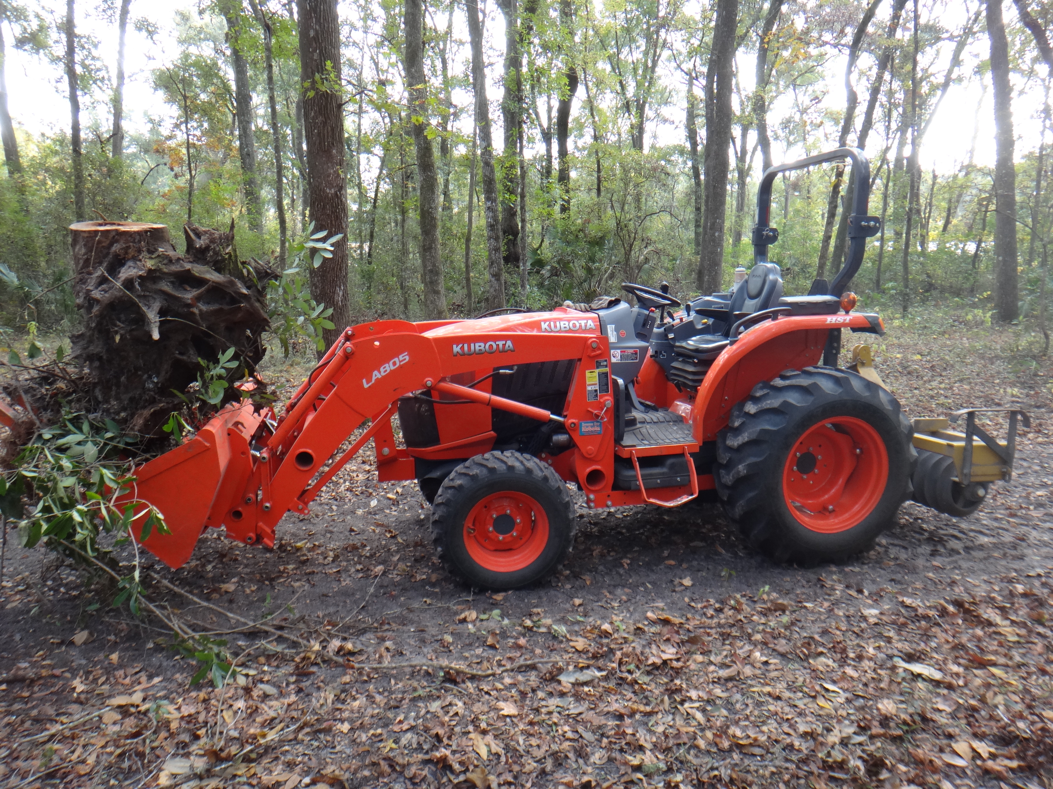

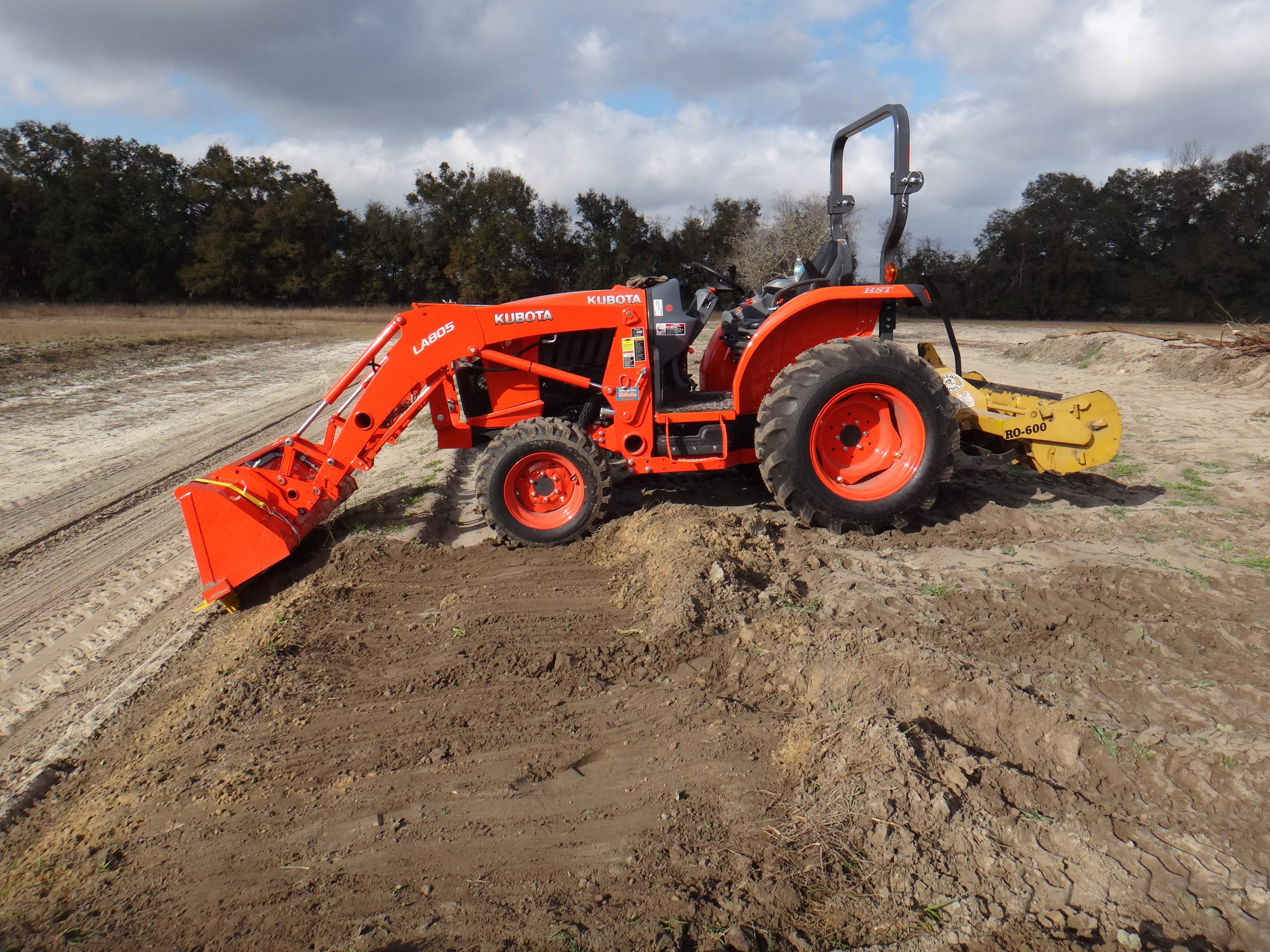

I have only air in the R4/industrial tires on my Kubota L3560. I carry a 60"/700 pound Cultipacker as counterbalance to FEL loads most of the time. 1,000 pound FEL loads are stable. If I see are rare need to lift a ton, I mount my 965 pound Disc Harrow, which protrudes far to the rear, providing a great amount of counterbalance via leverage.
