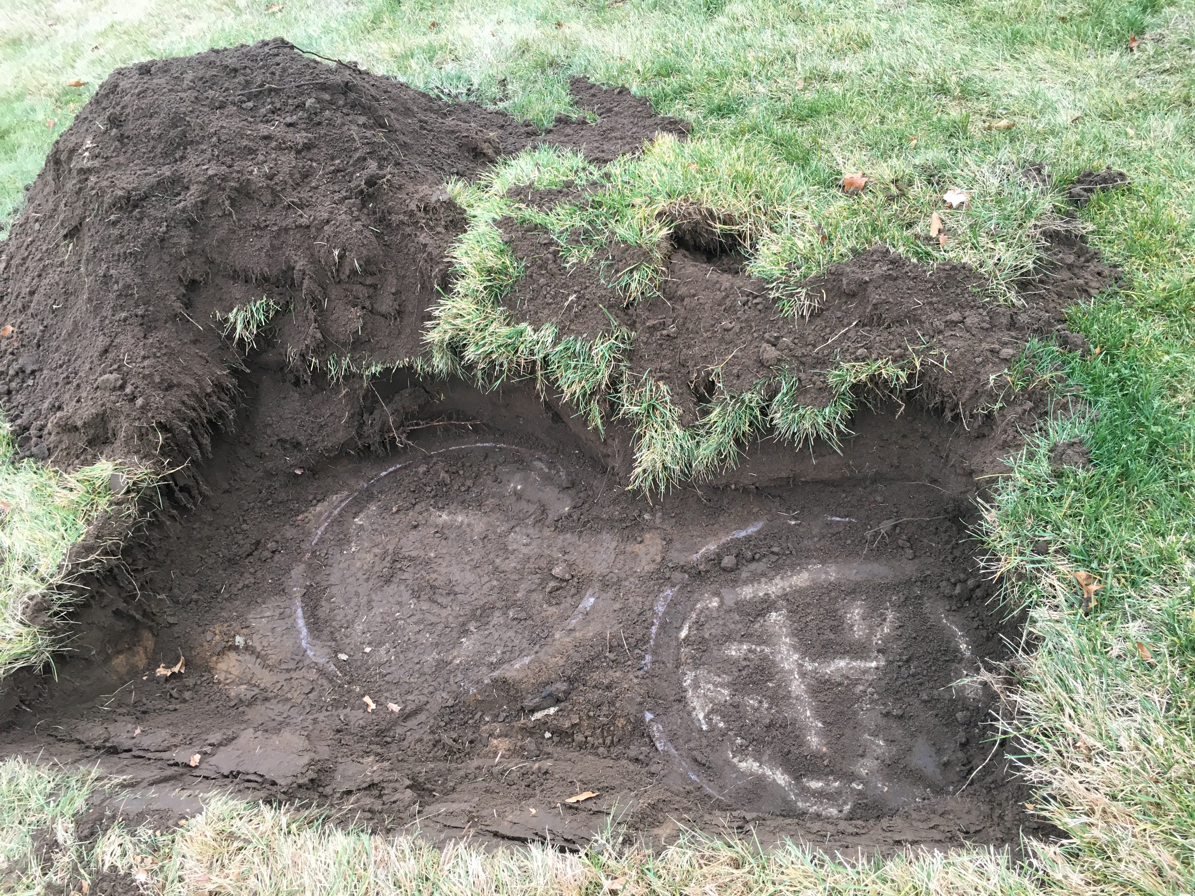

My PT425 is going to dig out the two septic tank lids after lunch so I can get them pumped before the ground freezes.
Hey Mossroad, are you going to use the bucket for removing the ground above your septic tank lid? I didn't know if you had a mini hoe or not?
   / What did you do with your Power Trac today? #38
First, I used the small bucket with teeth to push down into the sod and take out two scoops of sod about 42" wide by 18" deep by 6" thick, leaving about a 7' by 18" hole 6" deep.
Then I switched to the wider light material bucket and scooped out the hole down to the tops of the tanks, about 18" down.
Finished off with a hand shovel.
Whole process took about 10 minutes from garage to garage. :thumbsup:
