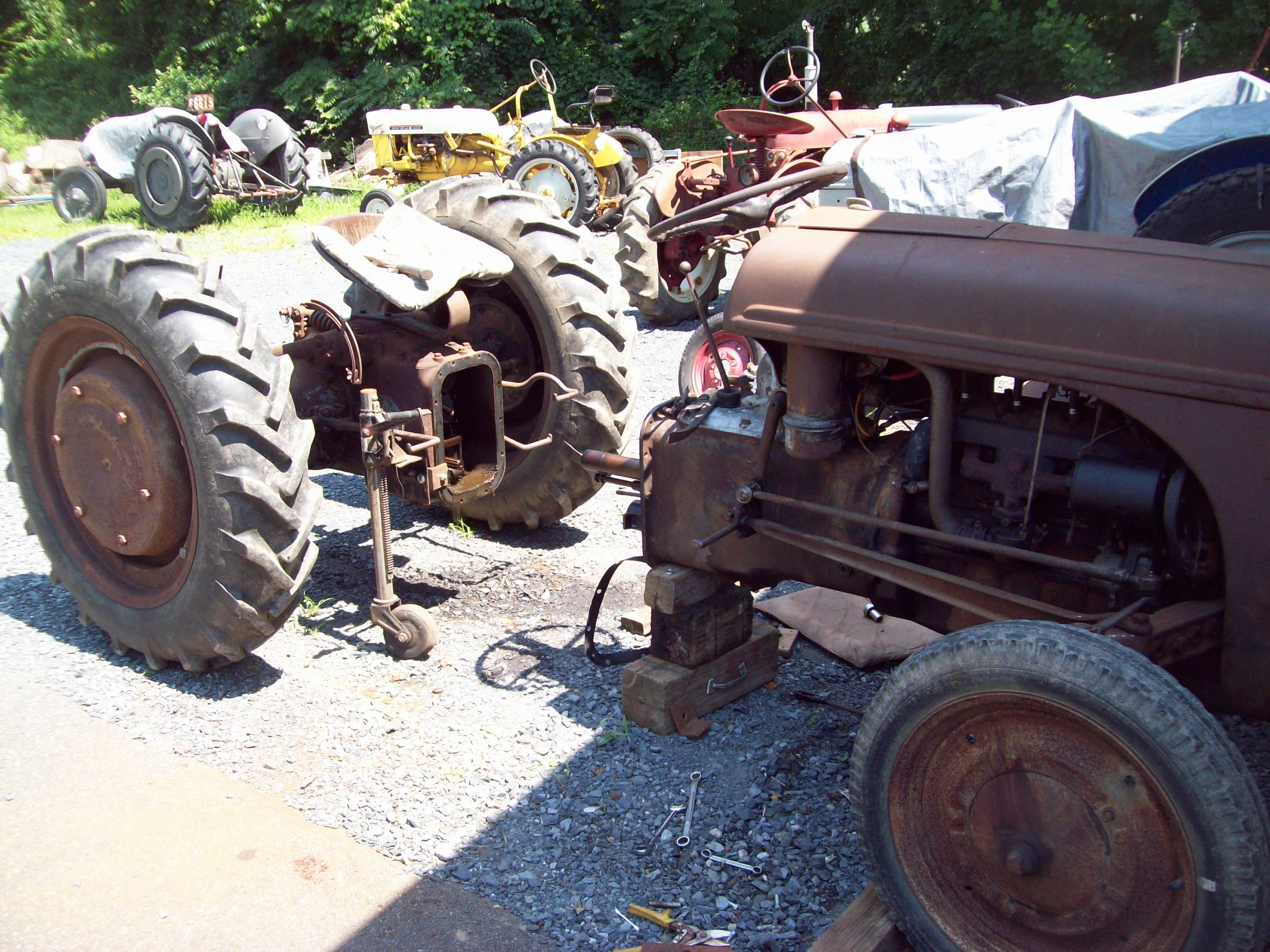

Not what I did with but more of what I did to my ford tractor. Split the '40 yesterday. Friend came over so we hunted up an axle carrier in my "boneyard" for his 601. While he was here we pulled the hydraulic piston and the cylinder had a nice score in it, which is why when the tractor was running the implement would hold up but if you shut it off the implement would hit the ground in under four minutes. Upgraded to an 8n cylinder and an NAA piston. Because he was here and had the extra hands we were able to do it without pulling the top cover.

Kirk I can't even imagine what kinda treasures lurk in your boneyard! Good to have an extra set of hands there yesterday huh? Heck, sometimes it good to have them even when we don't need 'em.
Nice use of that trailer jack to support the rear half, got any close-ups or a thread on how you constructed/adapted that? Pretty cool.

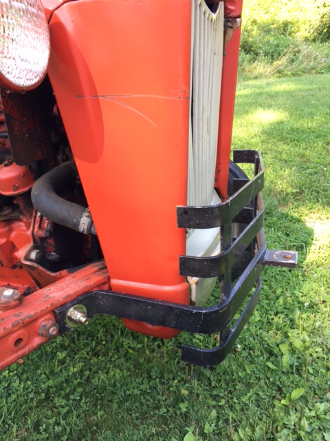

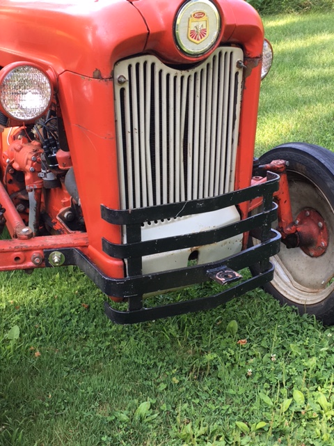

Found this on craigslist this morning - a bumper to use until the right one comes along. Hit up Fastenal for some hardware and we're in business. Heck, I may have a couple uprights welded into the corners to stretch some expanded metal between to further protect the grill and radiator, I don't know.

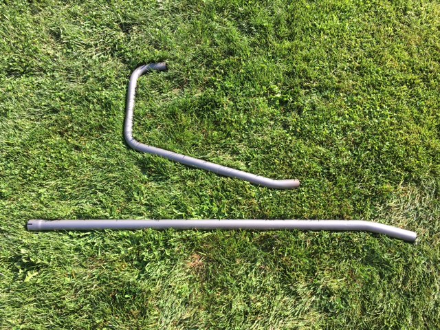

Had just about given up on YT coming through with those exhaust pipes we've been waiting on when just as we were sitting down to Supper the big brown truck rumbled up.
Can't comment on fit, but the wall thickness is a heckuva lot meatier than the old more-than-likely original pipes that are on her now (which are burned through in a couple spots).
Now to get some new clamps, find a shady spot and see if I can sweet talk the old stuff off without too much trouble. Supposed to rain heavy here the next couple days so we'll see how far I get.

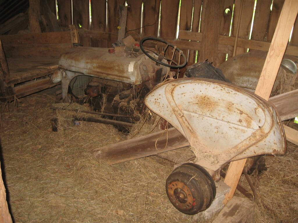

20100516_OH_momdads__6674_tractor_8N.JPGthis one is in pretty bad shape.

#20
Bah, that'll buff right out. :)
I can see how you'd feel like that old girl's too far gone though at least she's been kinda sheltered inside, and I'll bet it'll make for a good "chip away at it" project one day.
