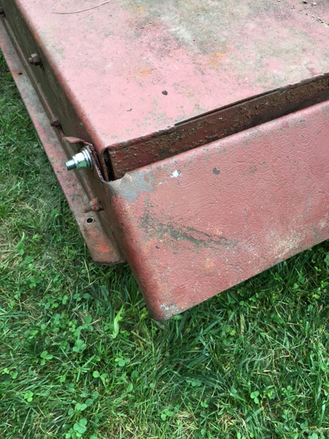

Though not technically the tractor, removed the rear shield from the 90I/901 brush hog which was dented up pretty bad apparently from having been backed into stuff over its' life. Beat up bad enough so the thing would barely raise or lower.
Hammered it flat and squared the corners back up.
New hardware, greased up the ears, bolted it back together and VIOLA! Functioning rear shield that lifts easily and drops back down under its' own weight.
Before:
After:

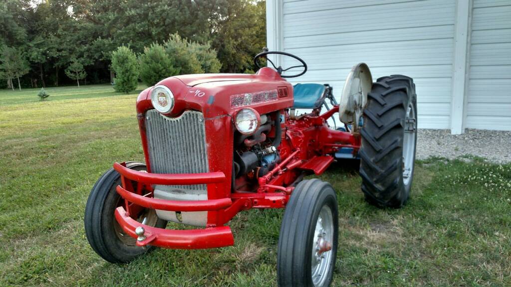

Dang I'm having a heckuva time locating the original 3 horizontal bar front bumper correct for the 641. If anyone has a line on one - either new or used, please let me know.
I understand that's the one we should have.

"Dang I'm having a heckuva time locating the original 3 horizontal bar front bumper correct for the 641. If anyone has a line on one - either new or used, please let me know"
The correct bumpers for your tractor are getting harder to find and when you do find them they are usually bent up. Something to keep in mind when looking for this bumper is that they also made the same style bumper for the later square nose model. It is wider than the earlier model to accommodate the wider square nose tin and the bar spacing between the top and middle bar was wider. The reason for the wide space between the bars was so you couldn't mount the pillow weights on the top. Even though the bumper is wider you can still mount it on you 601, as seen mounted on my 4000, but it's not the right one for the tractor.
