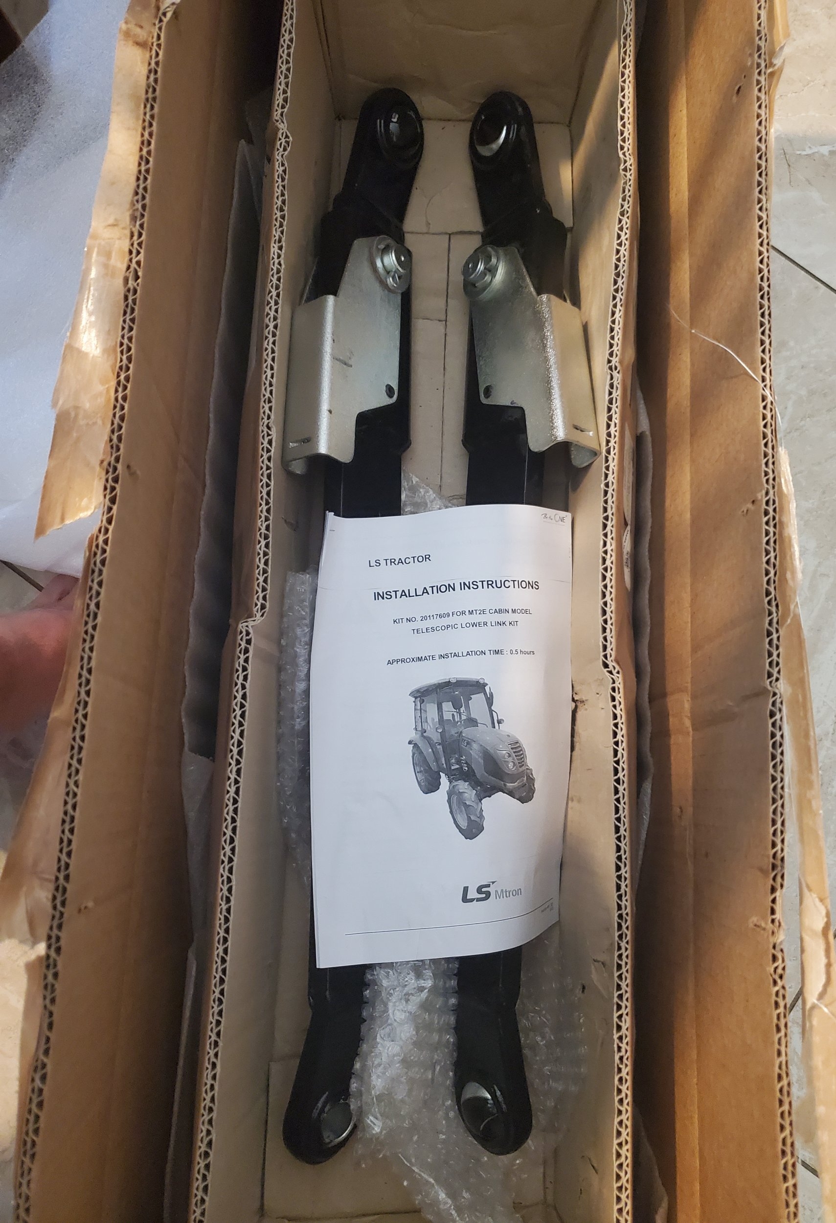

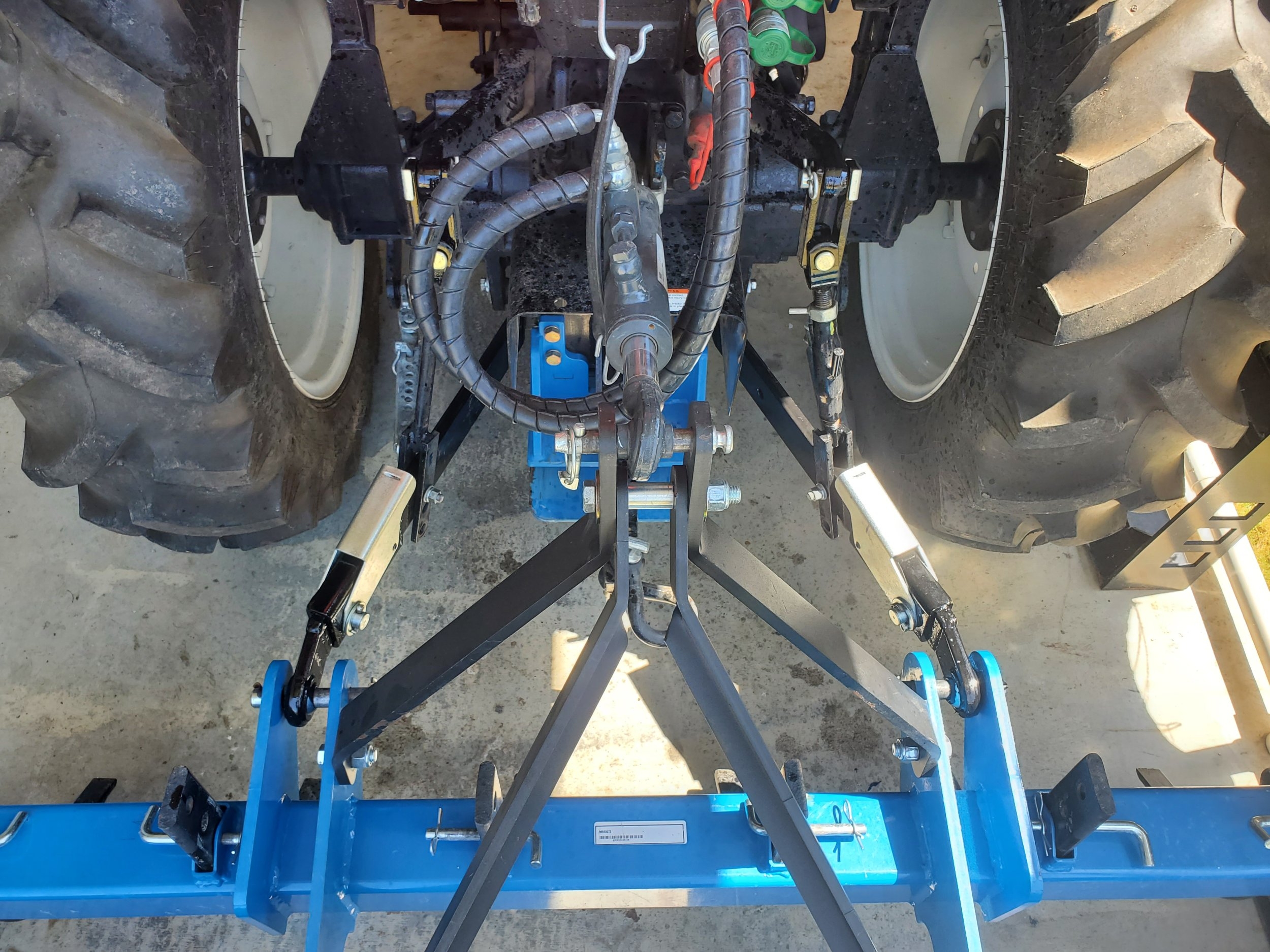

Did this several days ago, Haven't really used them to hook anything else up yet but I'm sure it will be much easier now. Boxblade was already on the tractor so I just swapped them out one at a time.
I didn't really want to add "Pat's" as they add about 4-5" of length, then the hydraulic top link I have would effectively be too short.
The Brush hog PTO shaft would have been ok, but not the tiller, it has a really short PTO shaft that I had to cut down to make it fit.

Telescopic links are just great, such a simple, useful feature.

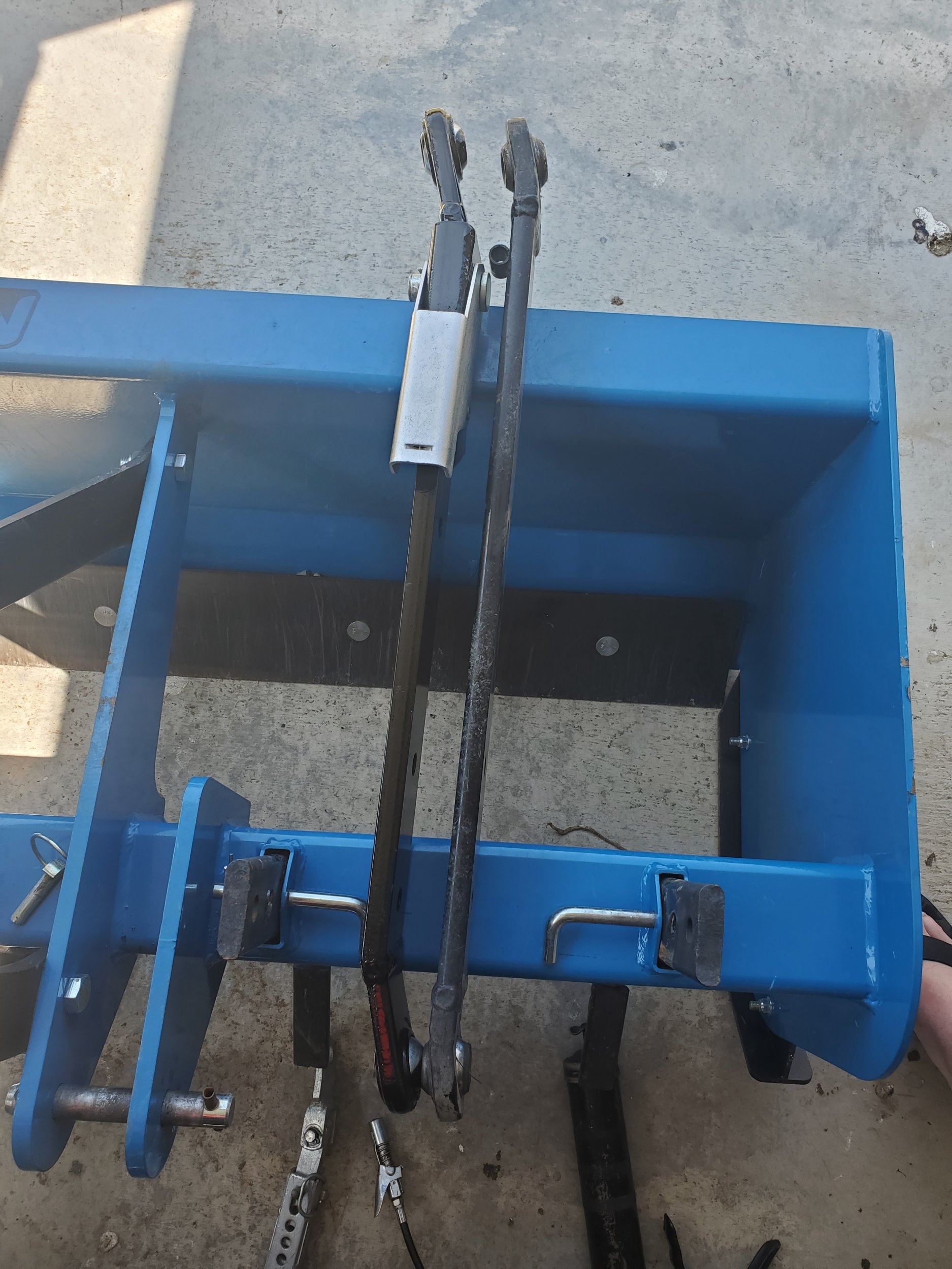

View attachment 823622View attachment 823623View attachment 823624
So you switched to extendable 3 point arms ? I wasn’t aware that the smaller LS tractors were not equipped with extendable links from the factory. Yes they can be very helpful when hooking up 3 point equipment.
   / What did you do on or to your LS Tractor today? #2,425
With the proliferation of Quick Hitches you're seeing less and less standard telescopic links.
They're still an option for most tractors, but they'll be just that, an option.

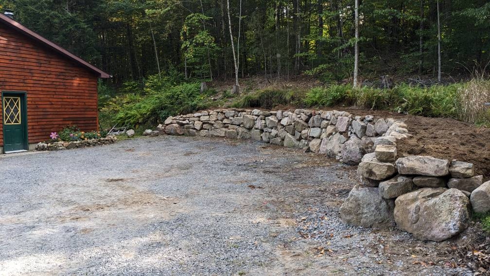

I finally finished expanding my driveway and putting in a rock retaining wall. It started as this.
It ended as this.
If you zoom into the middle picture you can see a shovel leaning against the wall for scale.
The rocks used in the wall were all dug out of the ground when digging/moving back the hill. Sadly, I still have many, many more rocks left over.
