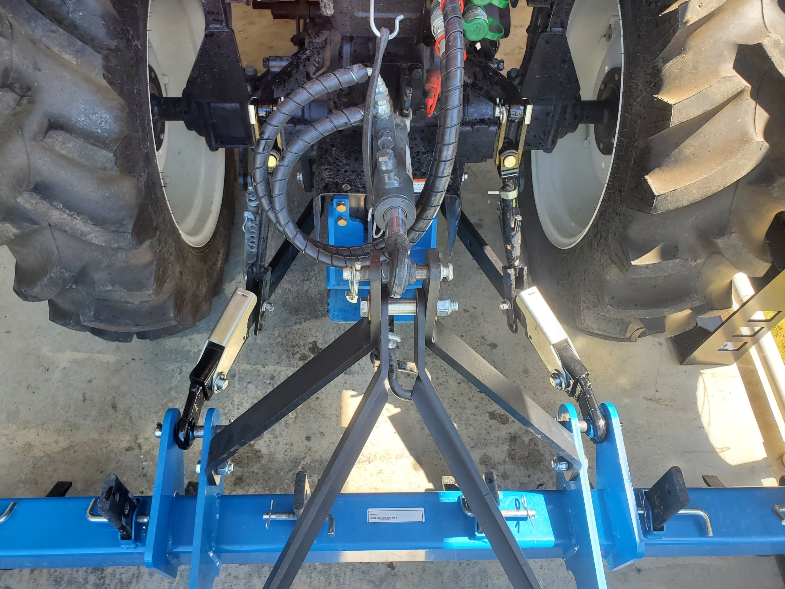

Did this several days ago, Haven't really used them to hook anything else up yet but I'm sure it will be much easier now. Boxblade was already on the tractor so I just swapped them out one at a time.
I didn't really want to add "Pat's" as they add about 4-5" of length, then the hydraulic top link I have would effectively be too short.
The Brush hog PTO shaft would have been ok, but not the tiller, it has a really short PTO shaft that I had to cut down to make it fit.
View attachment 823622View attachment 823623View attachment 823624
A very worthwhile mod,
