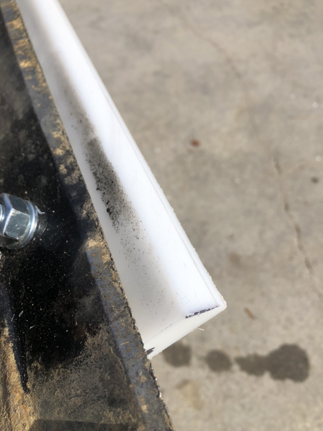

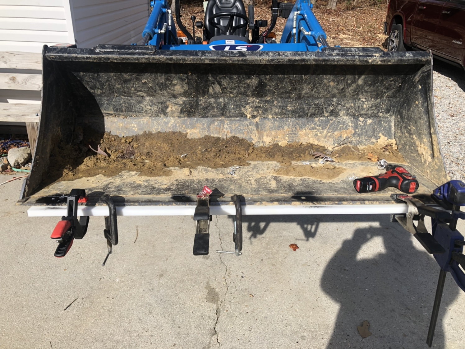

I made a snow blade for my FEL. Bought some UHMV poly from Amazon. They were supposed to be 48in long but it was 47 and 3/4. They were 3/4in thick. I bolted it down by using a Forstner bit and a 1/2 drill bit. I also beveled the edge. I’m making one for my grader blade too. All this means is that we will not get snow this year.

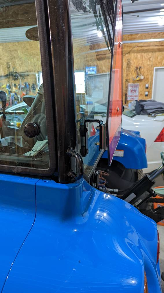

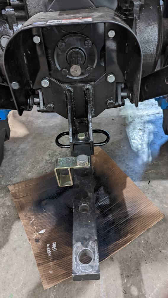

Moved the SMV and put on an implement chain support and hook loop.
   / What did you do on or to your LS Tractor today? #2,127
Nice move but can you still open the rear window ?
   / What did you do on or to your LS Tractor today? #2,129
Thanks for the picture ! Looks pretty slick, I might have to try the same thing because where my SMV sign is now it interferes with the hoses for the hydraulic top link.
   / What did you do on or to your LS Tractor today? #2,130
I’ve been trying to figure out where to relocate mine too ( it’s off right now) for the same reason ( interference w/hydraulic lines for T&T). Never looked at the strut attachments-great idea.
