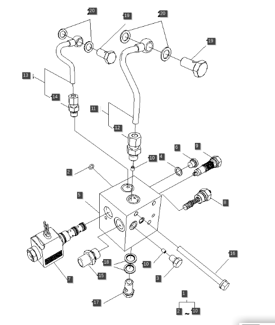

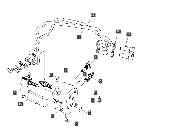

My dealer provided me with all of the manuals. Not sure if web site or what. I know I have them all on my computer.
   / What did you do on or to your LS Tractor today? #2,112
These help? HST is on the right.
