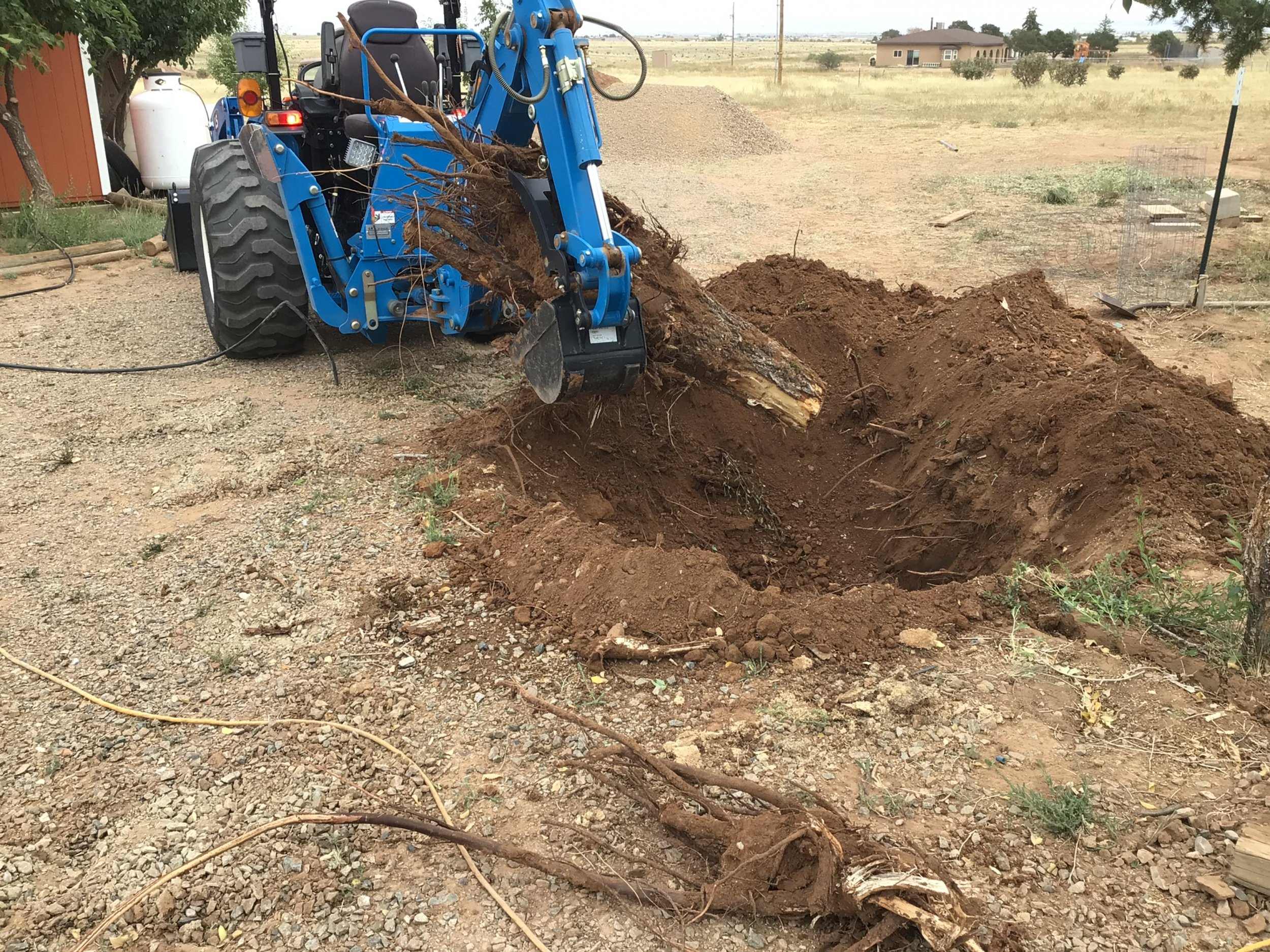

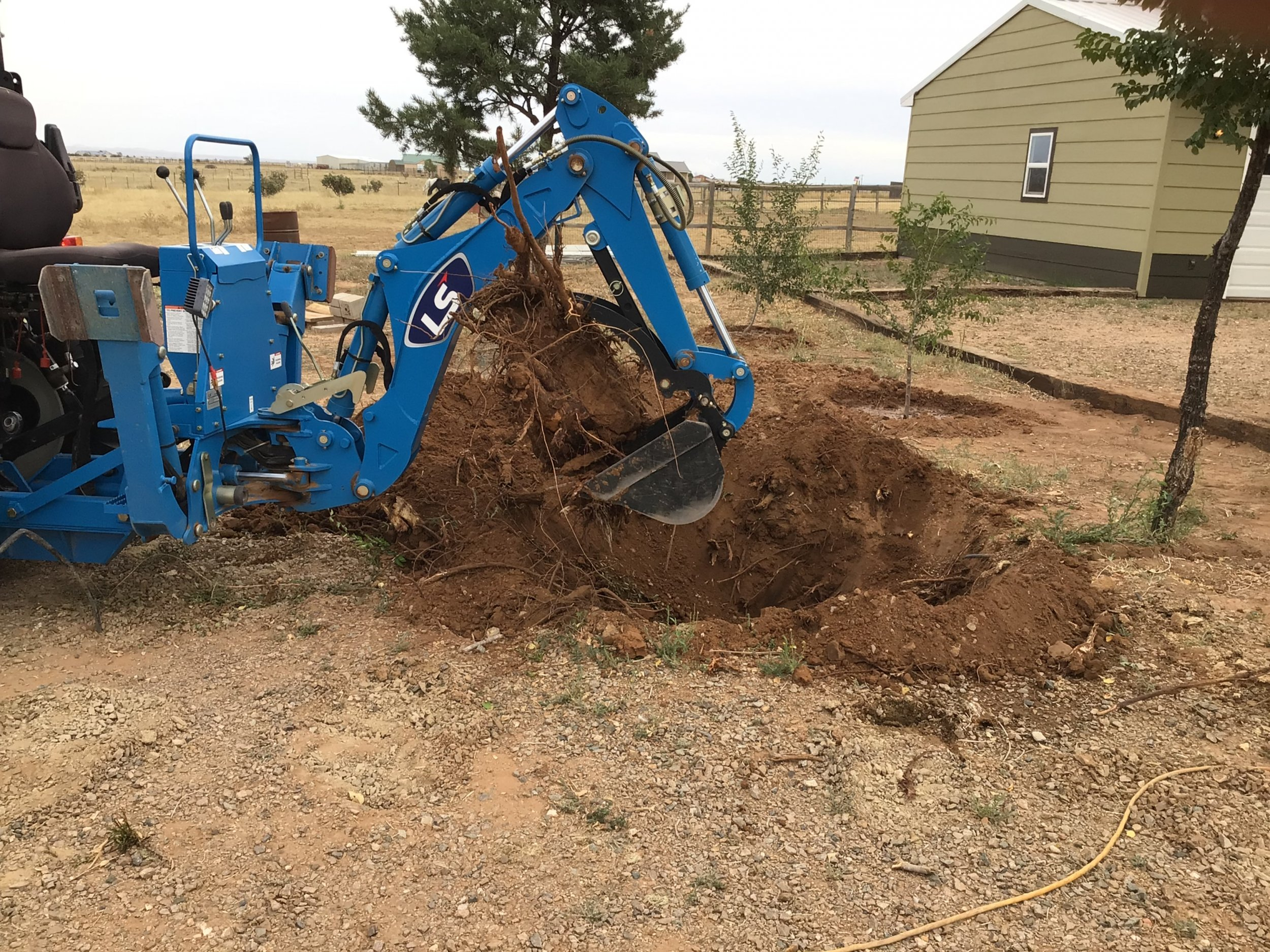

Dug up a stump today, only about 10" in diameter, but was still fresh.... actually started growing new sprouts around the outer ring. At least the roots were easy to dig / rip out. I was expecting a few hours for the job, but start to finish was only an hour! CA0FF412-29EA-417E-83D3-118F798EFFB8.jpeg1A347D32-3C6C-4B7E-8C8B-09C1CEC7AD66.jpeg

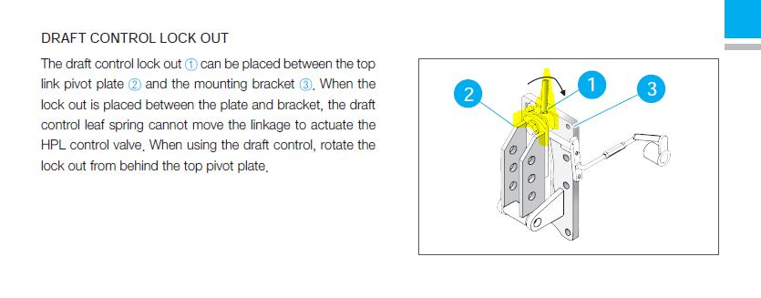

Recently noticed that sometimes the outside control for the 3 point system doesn’t want to start working until I futz with it and when the outside control starts acting up so does the inside control, then after a little futzing around everything goes back to normal. Has anyone else experienced this issue and actually figured out what’s causing it to happen ? So far it hasn’t caused any big problems.
   / What did you do on or to your LS Tractor today? #2,026
Well I had recently moved the draft control lever and locked it in position so I couldn’t accidentally move it, yesterday I moved it back to where it had been previously and so far everything seems to be back to working properly again, so I’m thinking maybe the draft control lever might have been what was causing the issues ?

Sorry, I dont have a photo. It's a little upside down U shaped block that is hinged on one side. It sits right behind the top link where it connects to the tractor. The block should have a small pin handle thing that allows you to move it over. This allows the draft control to 'sense' how much pressure is being applied to the top link. Its confusing.
I did find a photo, in the service manual. Its the draft control lockout. Basically the mechanical on/off switch for draft control.

yes it does also seem weird to me as well but I never did fully understand exactly how that draft lever thing is supposed to function.
From Google: Draft control senses the extra strain on the hitch and allows the plow to raise just enough to get through the hard spot, immediately returning to the desired depth.
My MT240 doesn't have draft control but our IH's back on the farm had it and I used it to control the plow depth. With the draft set to "Heavy" I would lower the plow and slowly start moving forward and as it reached the correct depth I would start pulling the draft lever up towards the "light" setting until the plow just started to raise and then leave the draft lever there.
If We were just using 3pt sickle mowers or other non ground engaging equipment, we put the lever all the way to Heavy so that it was simply controlled by the Lift lever.
So if you moved your draft lever to the "light" setting, then yes your lift control would not respond.
