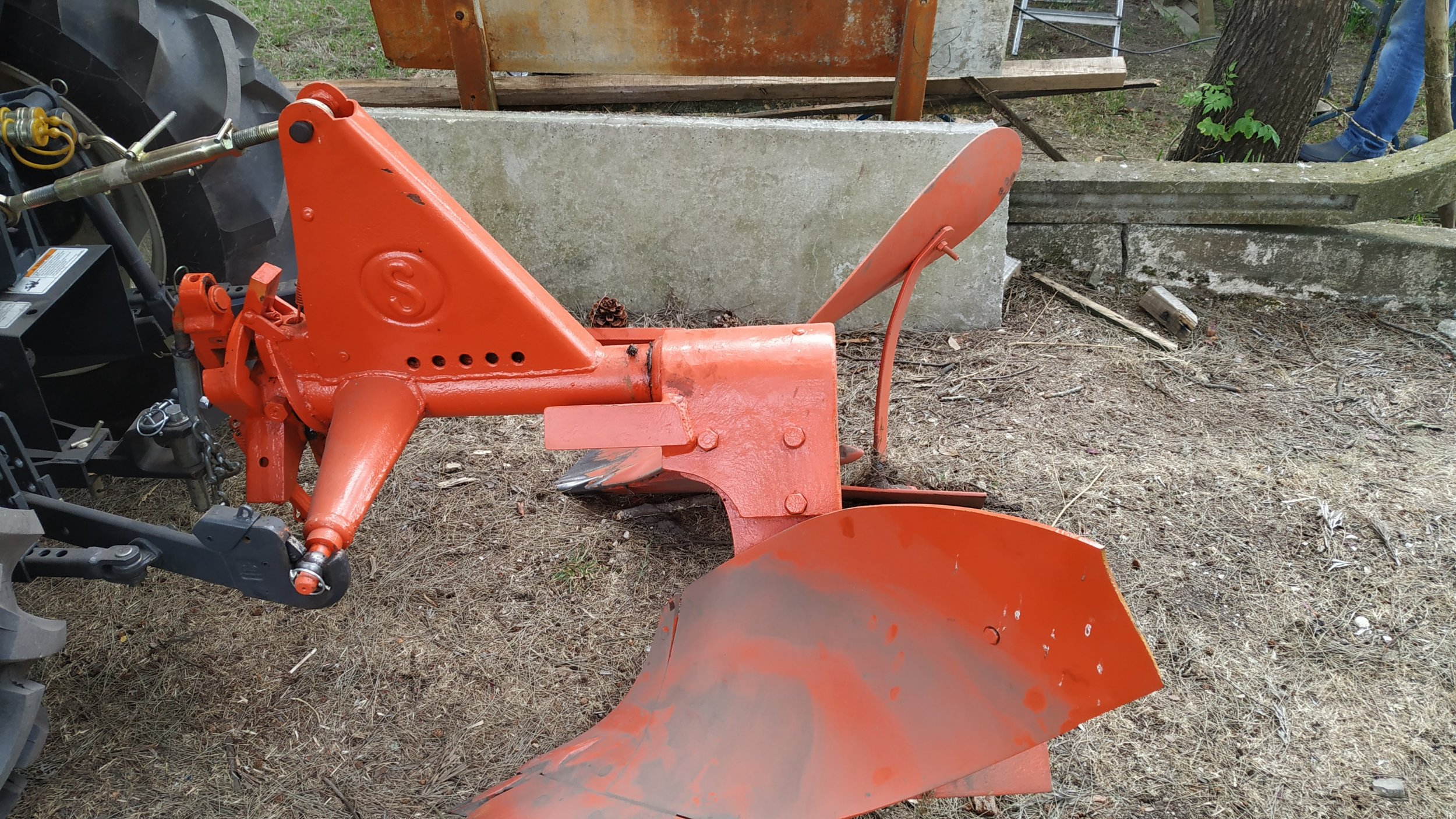

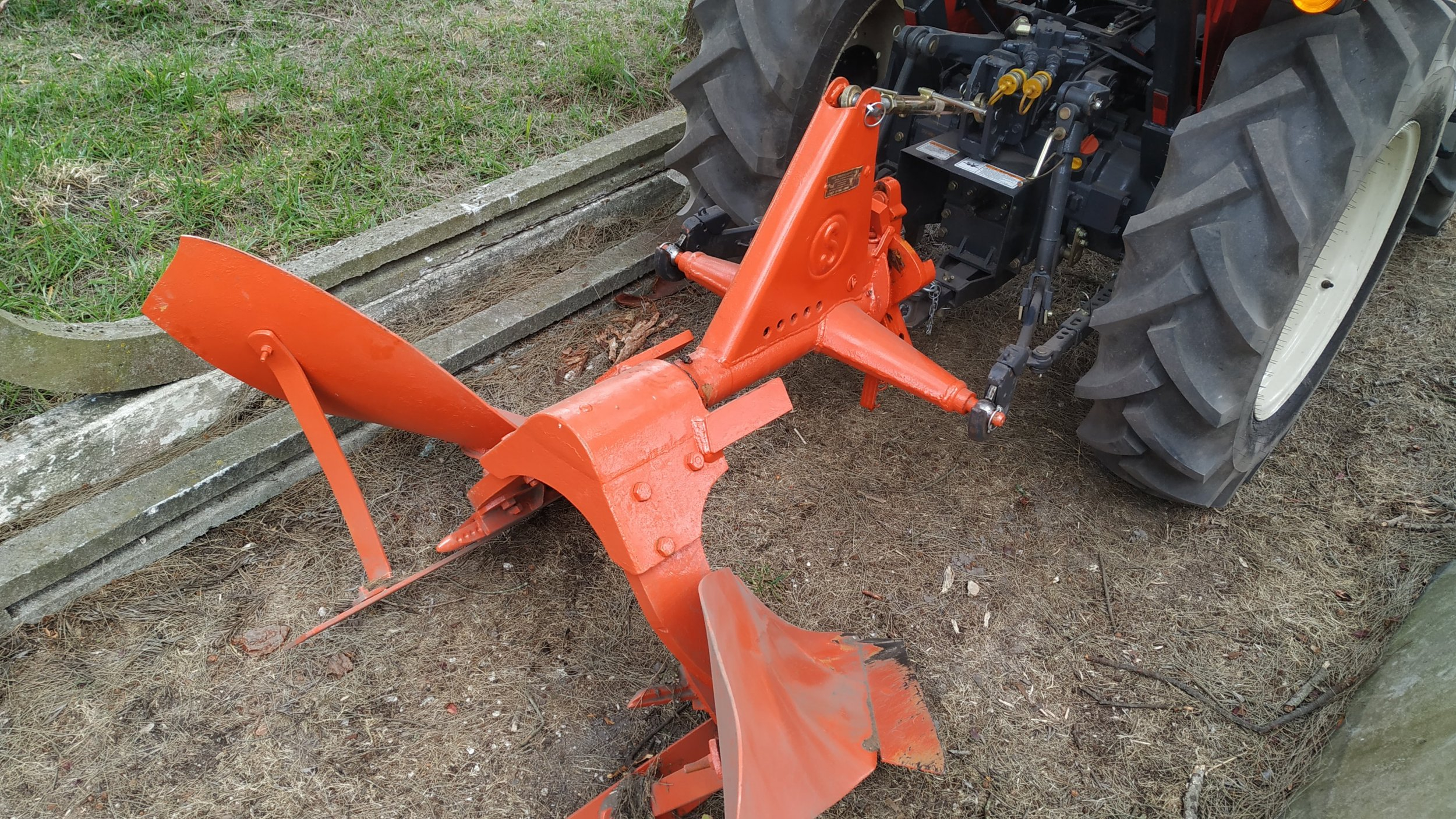

This is a 16" bottom plow I received as a trade in for an homemade trailer. It's pretty much the same as the video but from another maker.
I'm not that much into plows, just the basic stuff for the most part, so I don't know if our 16" plow means the same as the ones in the US.
View attachment 714451 View attachment 714452
Interesting. Do you have to get off the tractor to select which moldboard/direction is down?
   / What did you do on or to your LS Tractor today? #2,019
Not at all. It's fully automatic. You basically, lift it up and it will flip on it's own. Pretty cool system and works very well. You can also lock it, so it won't flip to the other side if you don't need it to.
