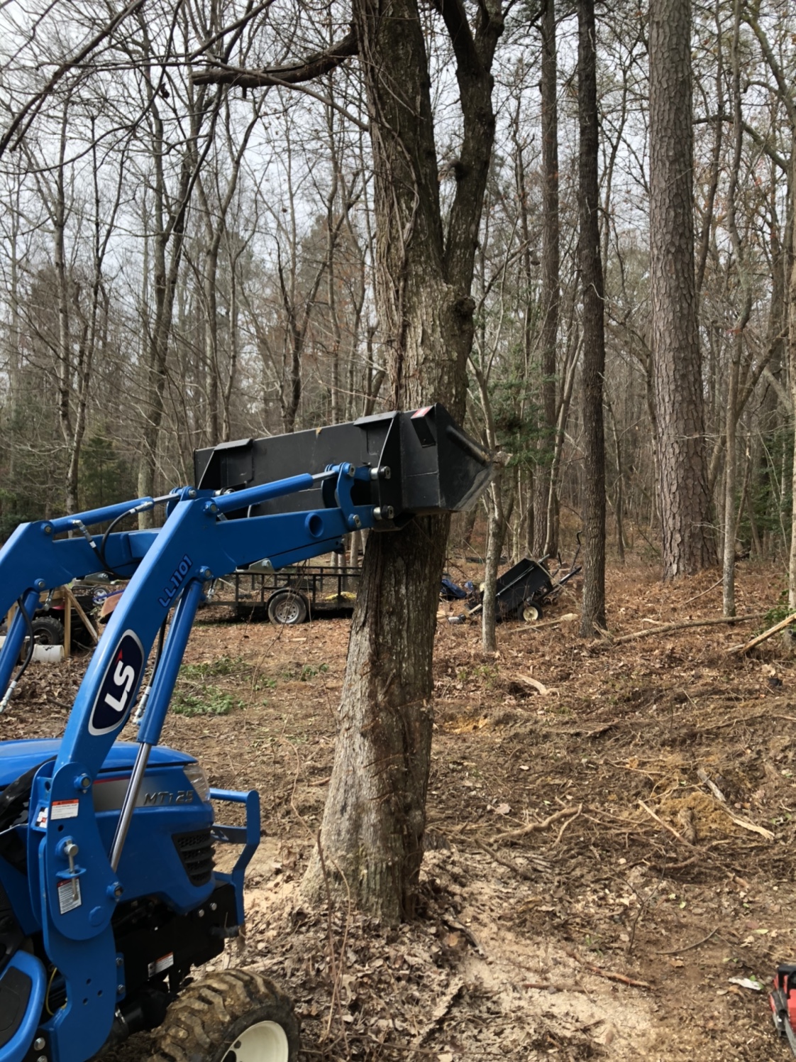

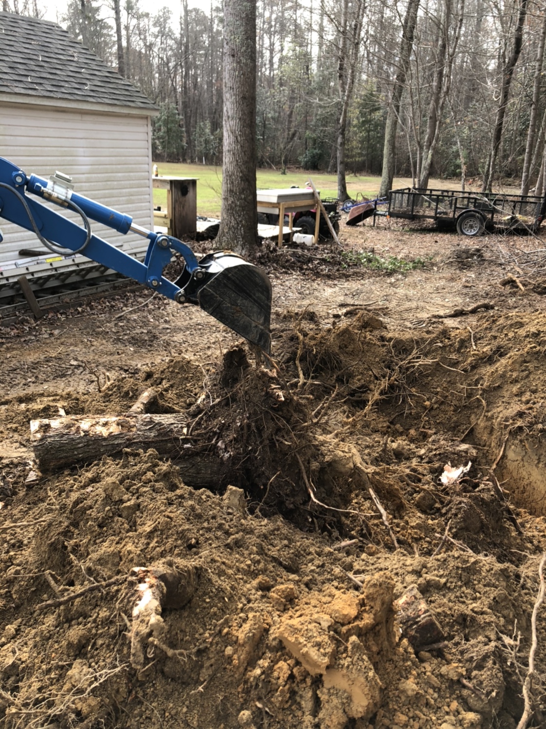

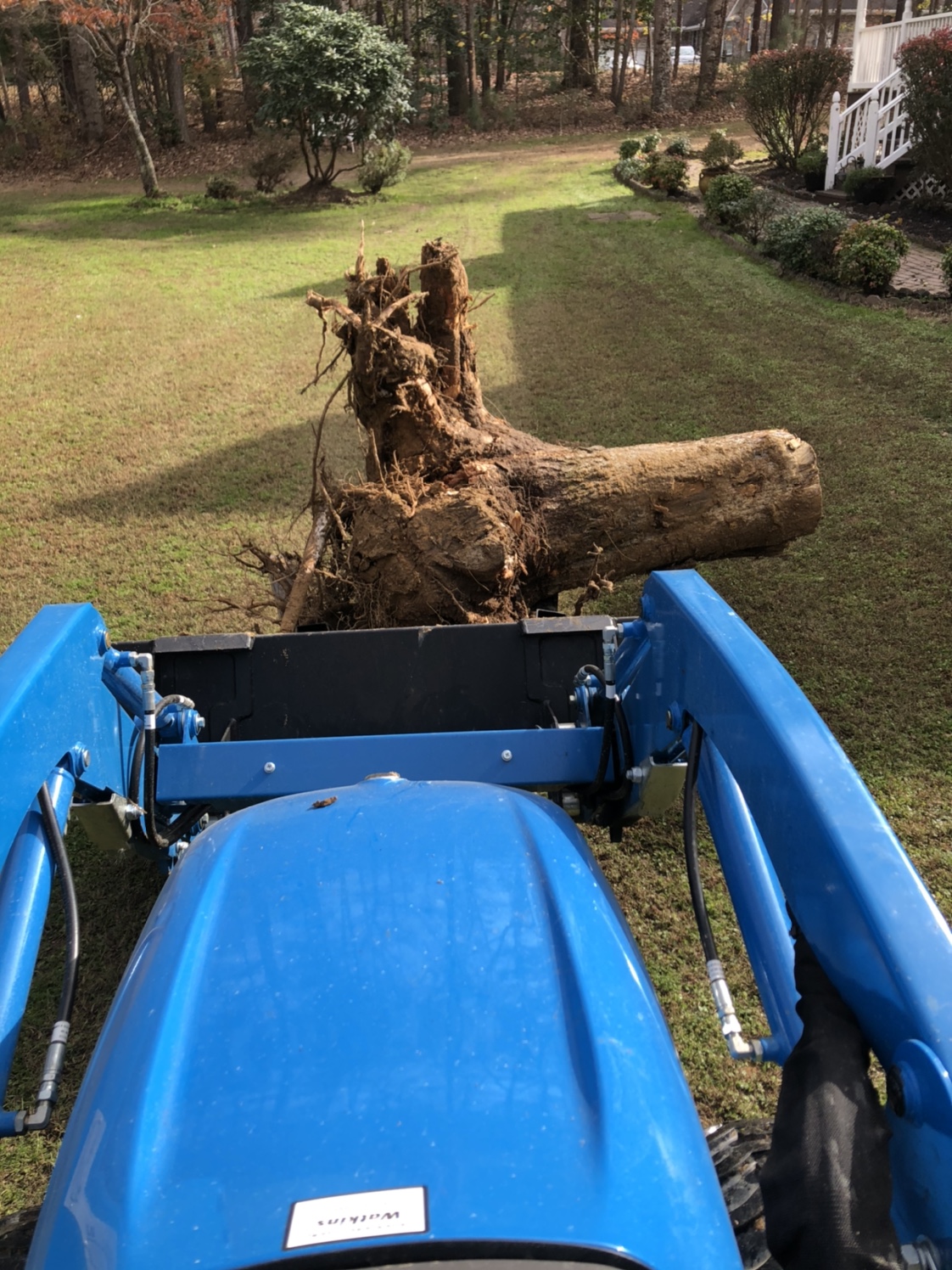

Took down a tree and removed a stump with my MT125 (The Beast)IMG_0827.JPGIMG_0830.JPGIMG_0831.JPG

And people say that SCUTs are just lawnmowers.... yeah right!.... you got some work done for sure!:thumbsup:
Anyone that says small utility tractor is a lawn mower has not done the work by hand enough to respect them!

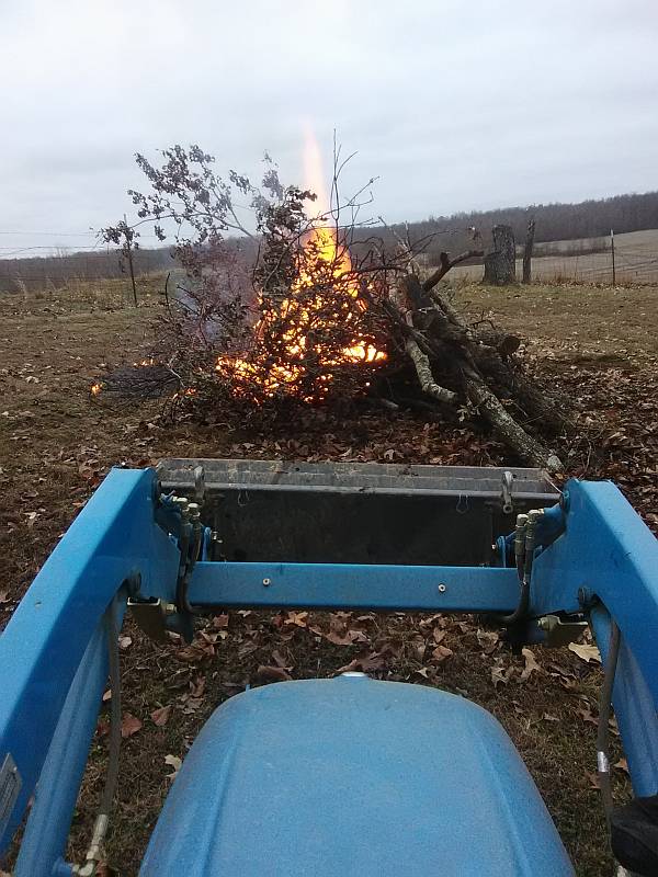

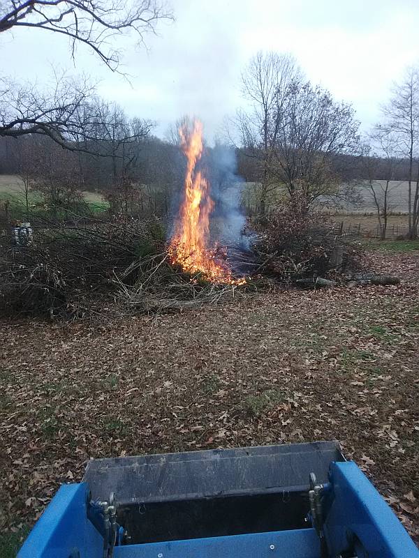

Forced the machine to witness the execution of a number of perfectly innocent trees, then aid me in disposing of the remains.
And today, the cremation:
