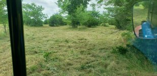

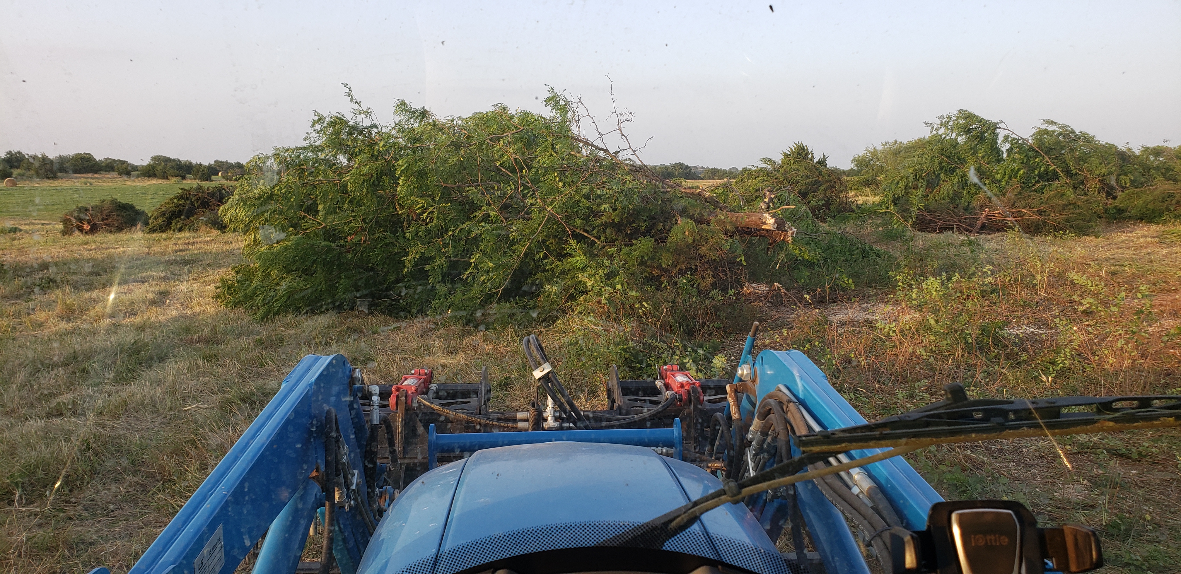

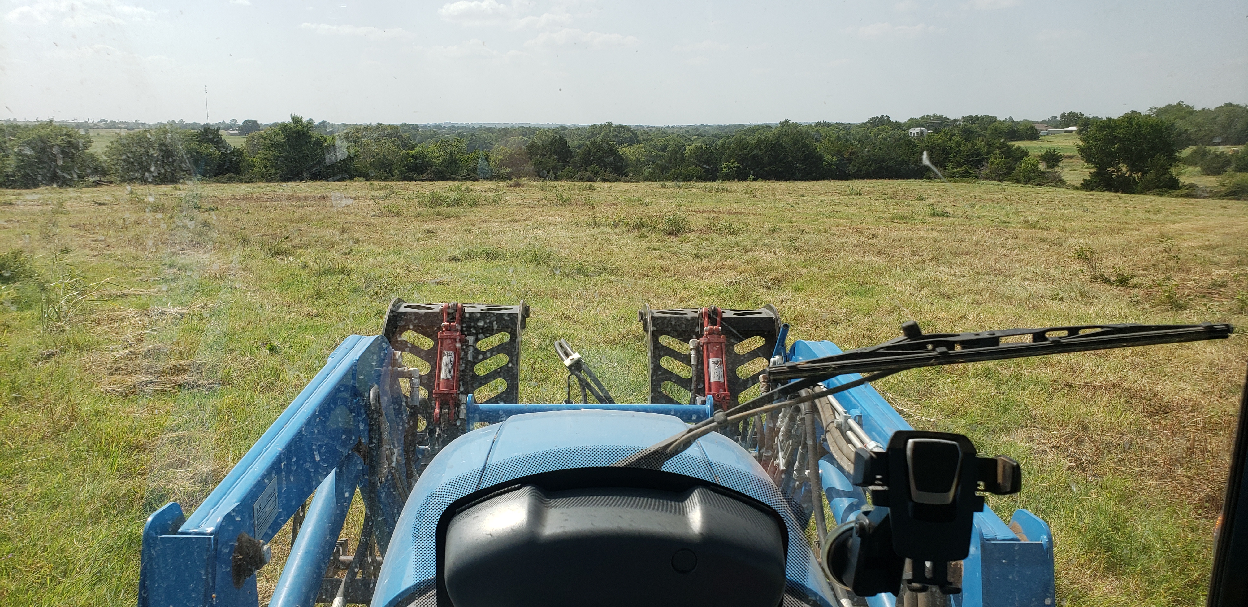

Reclaimed another 5 acre field on a long term project. The field was cleared by first running a rotary cutter over to cut the grass/brush to reduce the fire danger, then using the 3 pt. Dougherty TurboSaw to lay all the cedar and acadia down, then finally using the Wicked Twin to haul everything off the field to some handy ditches.
Here is a before shot.
After the rotary cutter:
After the TurboSaw:
And a competed shot:
Here is the approximate run time on each piece of equipment. Stopping every 2.5 hours or so to clean the radiator.
Rotary cutter: 3 hours
TurboSaw: 5 hours
Wicked Twin: 7 hours

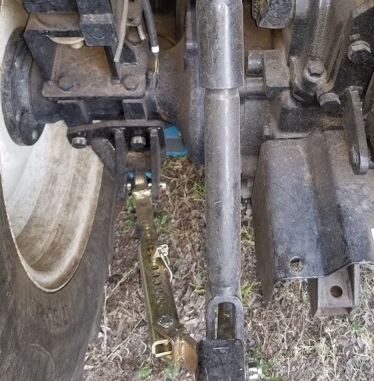

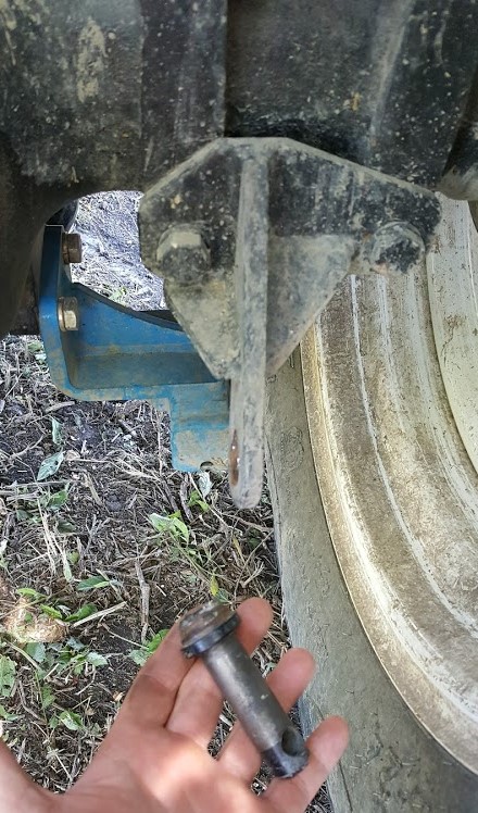

Dealer ordered.
Hope they are right ones. I didn稚 get to talk with him (sent email) and will query as to warranty. He delivered my tractor 1 year ago tomorrow.
Yes, it should be under warranty and ask them for both sides. This happened to me also and the new design is much stronger.
Old style that broke:
New style:
