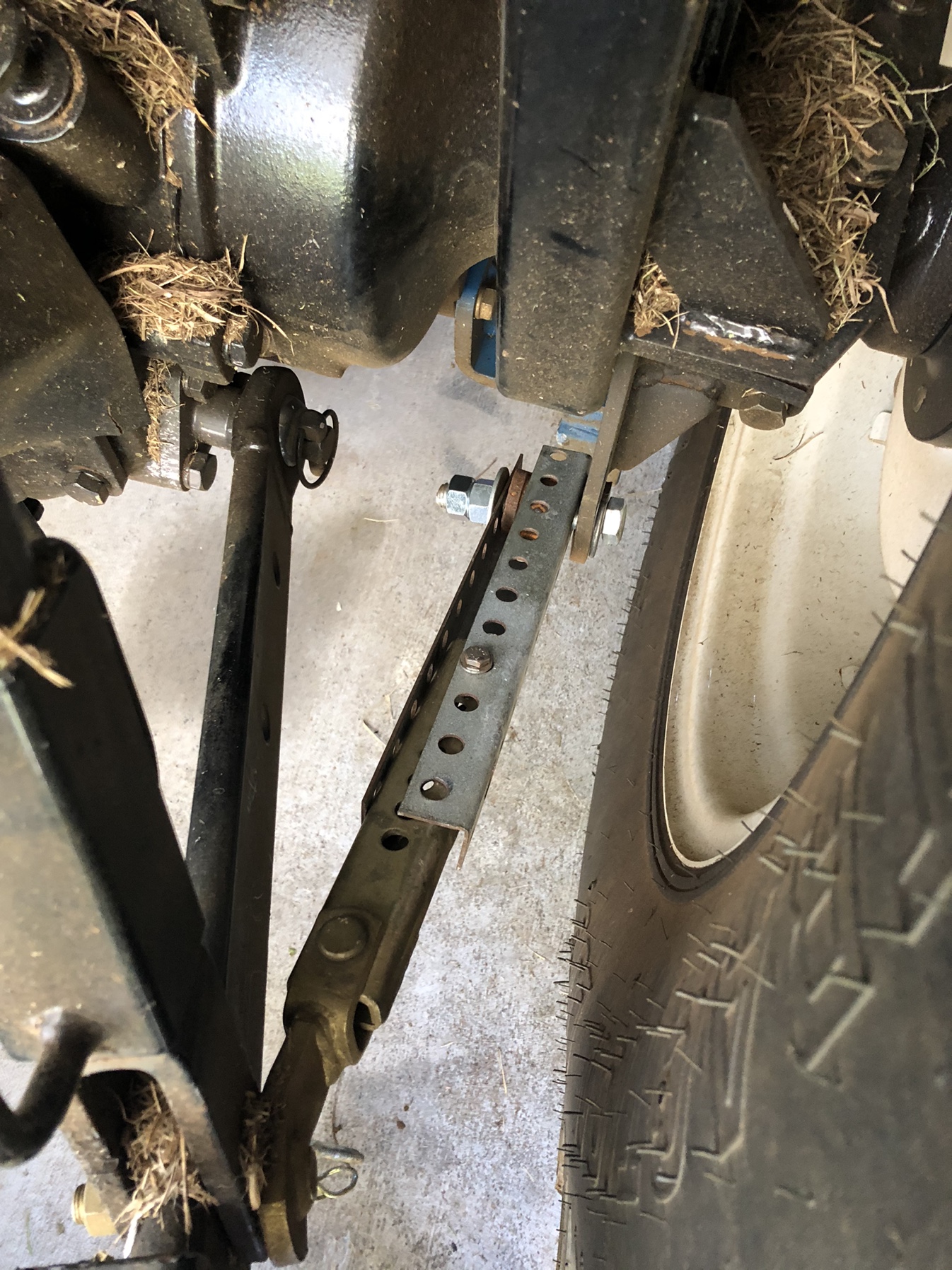

Interesting find. Managed to break the attachment point for the 3pt stabilizer.appears to have broken the weld.
I remember hitting a rock in a rather weird way, saw the cutter make a violent lurch, but slip clutch seemed ok and didn’t break the shear bolt so kept mowing. Imagine my surprise to find the stabilizer resting on the lift arm when I quit.
View attachment 661671View attachment 661672
Yikes. Guess you were on fairly level ground? Surprised the cutter did not move into the tires a few times.

And I observe the mower via my rear camera so didn’t notice anything unusual after the rock strike. The stabilizer on other side likely prevented extreme movements.
I had a similar issue with my attachment bracket. There are two styles brackets: a welded pin on single clevis or a double Clevis with a slide through pin. The double clevis is a redesign for a more robust bracket. LS sent my inquiry to a dealer for warranty determination But I was out if the two year period. Make sure to replace the bracket with the new design. Mine was a simple bolt on attachment with hardened bolts. Sorry but don’t know how to link to my thread...
