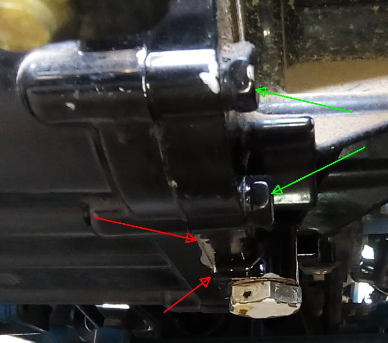

Found one at the hydro drain plug. I think. Noticed that area wet. Wiped it all down yesterday. 'Nother drip off the plug this morning. At the 50 hour, I went ahead and did a fluid change rather than mess with trying to save it during the filter change. Plug came out and went back in fine, but I used the same copper washer. Wondering now if I should have changed it. Plug is tight. Reefing on it with a 30mm socket wouldn't make it budge.
Fluid level is OK on the dipstick, so it isn't much of a drip.
This appears to be something other than the crush washer. When I wipe it all down and let it set, then dab around with a clean blue shop towel, I get moisture along the seam of the case parts, just above the drain plug. Hard to describe and I'll try to get pictures later.
Wondering if I should try to tighten any of the bolts that hold those case parts together.

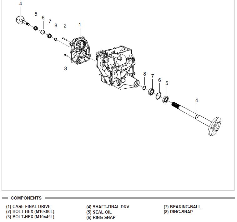

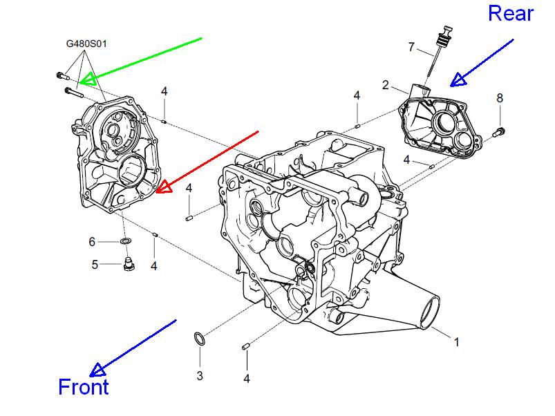

That's looking in from the rear at the right side of the axle housing. Red arrows show where I think it's coming from, but can't be certain. Green arrows show the bolts I'm asking about.
This diagram is viewed from the front. Item 5 is the drain plug shown in the picture.
   / What did you do on or to your LS Tractor today? #1,325
If you can find the torque spec for those bolts I'd break them loose one at a time and resnug them,
carefully and gently, is that a cast iron case or aluminum?
   / What did you do on or to your LS Tractor today? #1,327
Like Lou said, just break them loose and re-torque them. Maybe loose already? The case is cast, not aluminum.

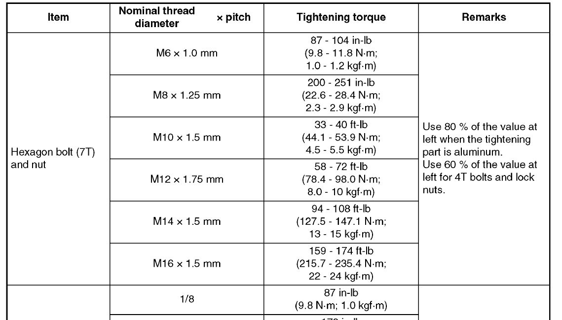

Items 2 and 3 are both ID'd as M10s and the chart says 33-40FtLbs
   / What did you do on or to your LS Tractor today? #1,329
Yes, the chart would be correct, just break them loose first, then retighten so the torque specs are correct.
