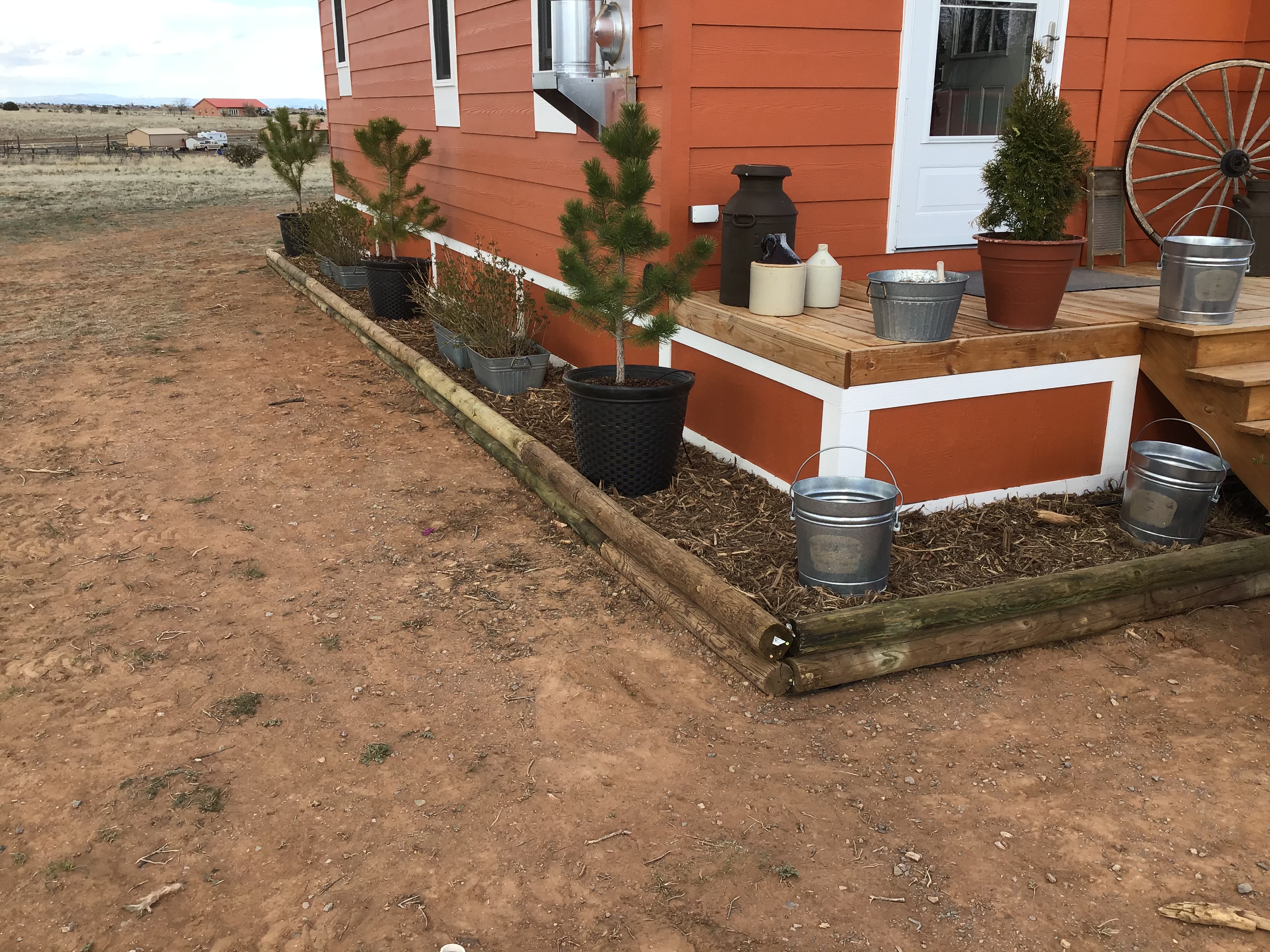

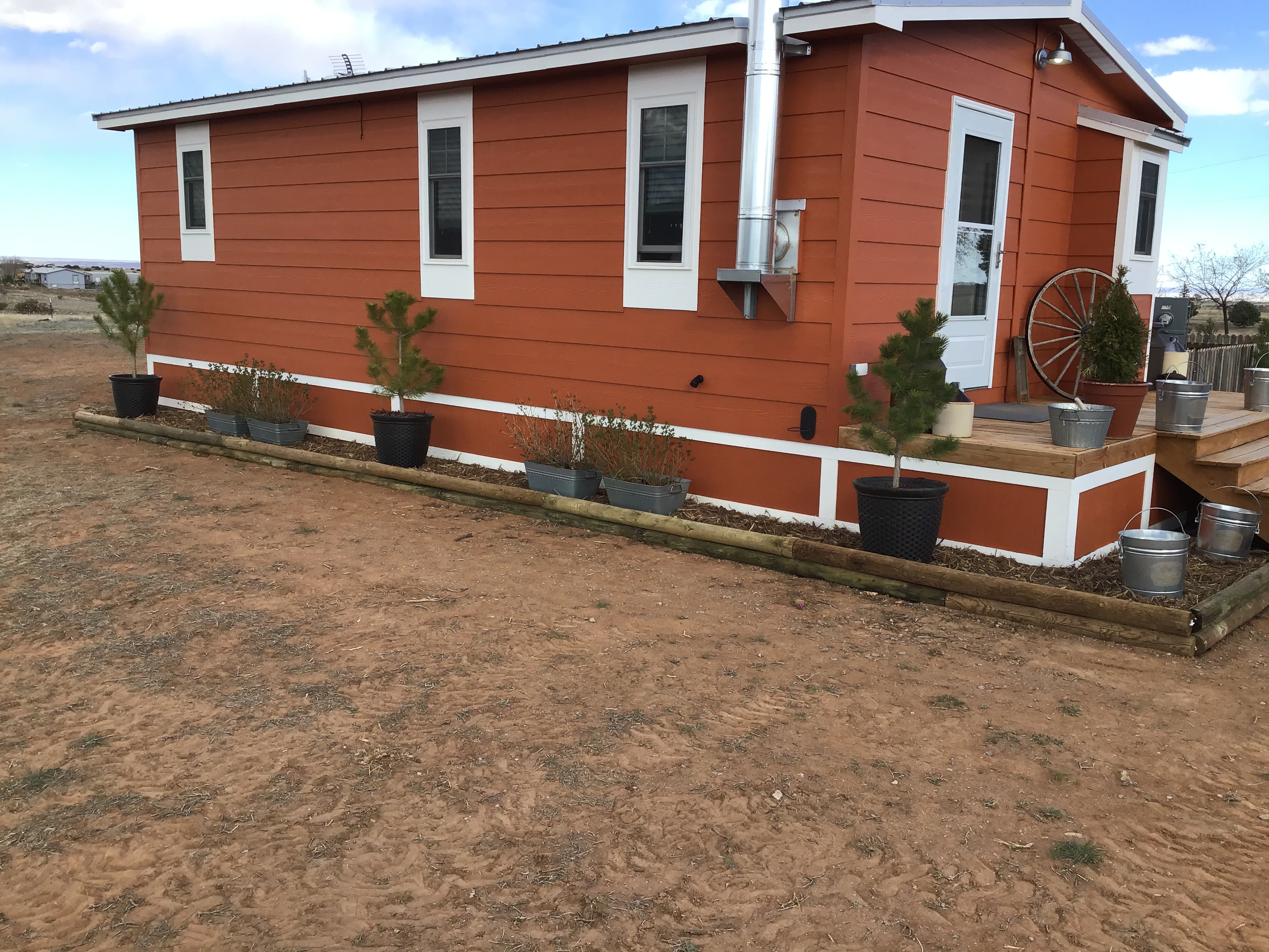

Did not do a lot, but used the loader to lift and place the big brown planters in a new landscape bed. Then got 6 bucket loads of mulch to finish it off.

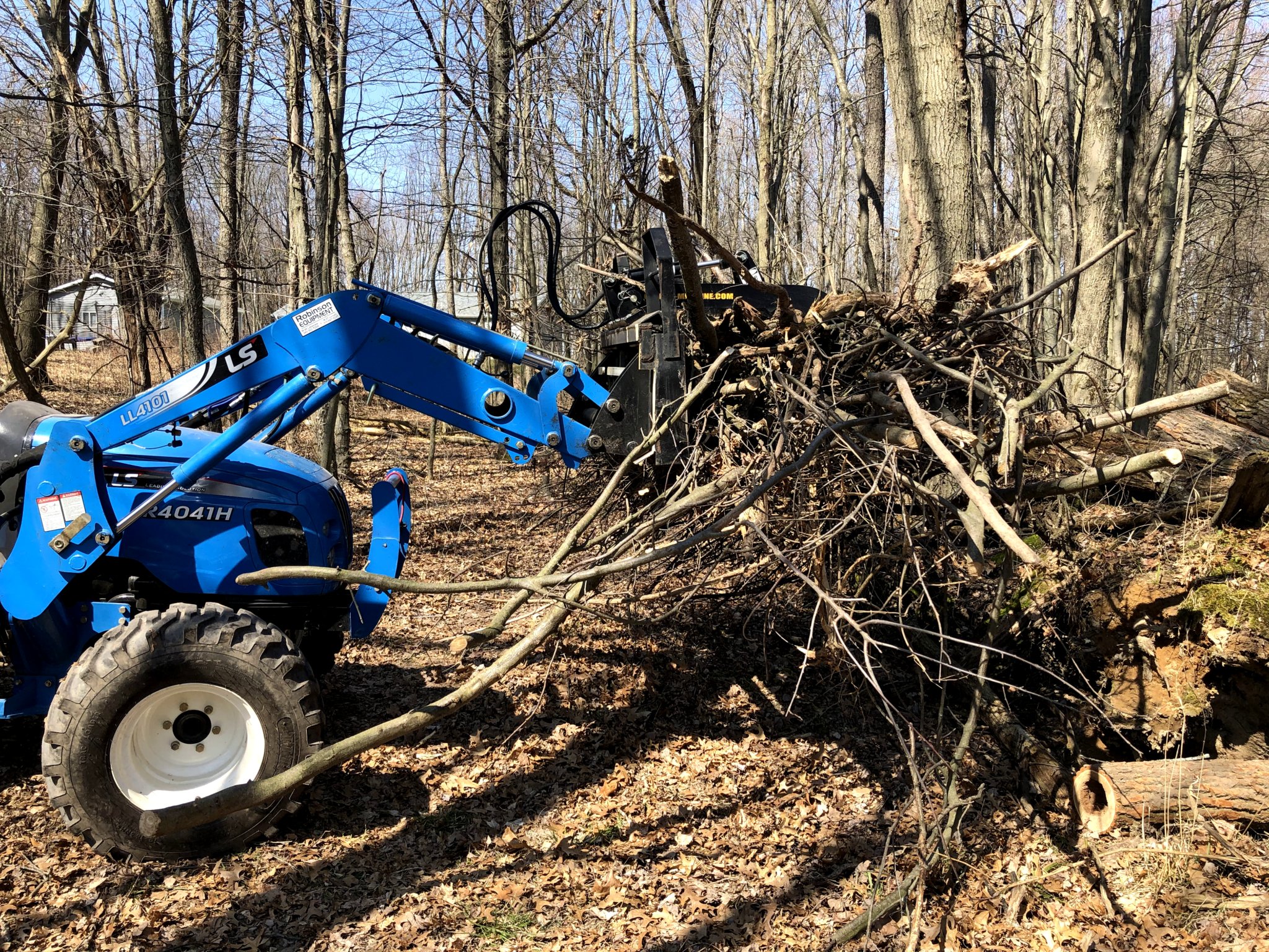

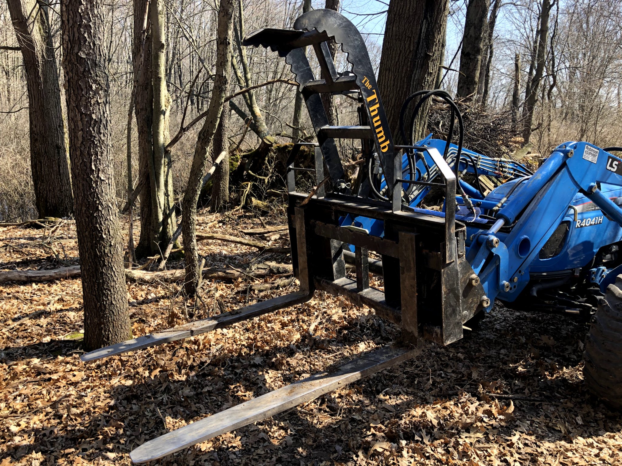

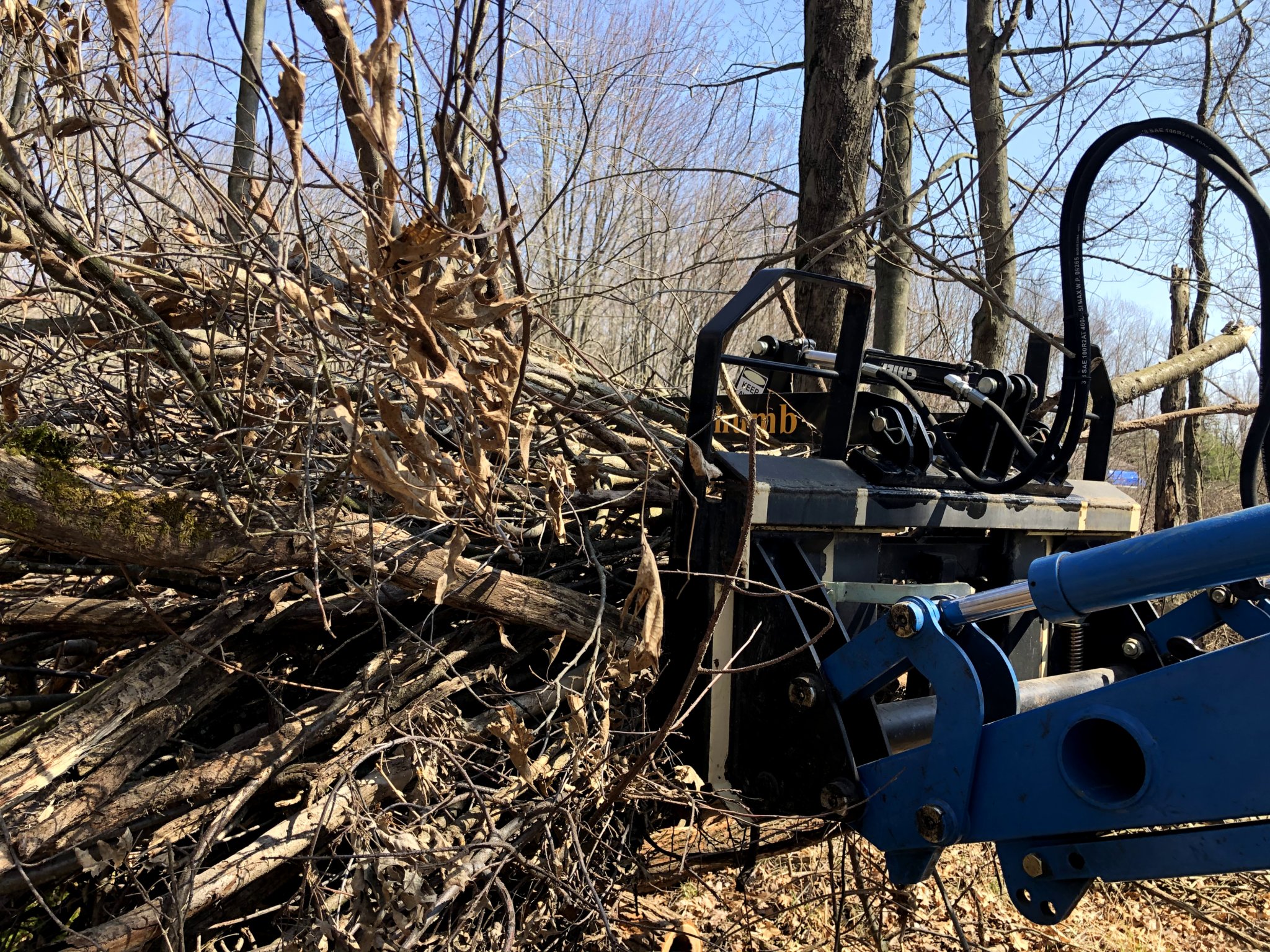

Very interesting setup. It looks to work very well. Kudos
   / What did you do on or to your LS Tractor today? #1,134
Looks like it works just as well as the rich mans grapple! That was a bunch of debris!
Thanks, works pretty good except for the little stuff has to be picked up by other means.

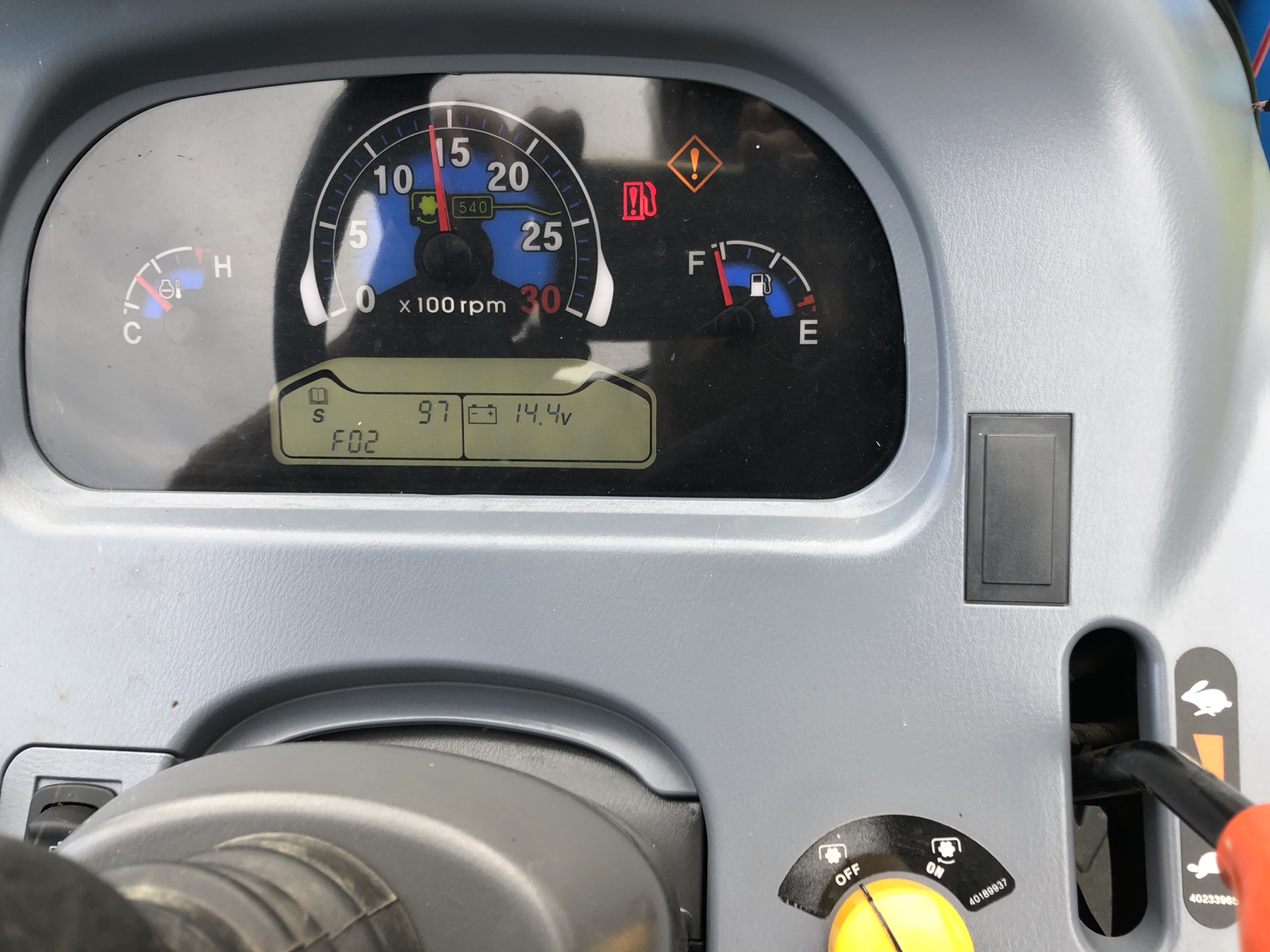

Had been experiencing the S97 F02 error code
Water in fuel.
This was not a consistent error, didn稚 happen every start and often went away.
So today I replaced both the Fuel filter and the water sensor assembly.
I am curious that the sensor may be OK, just clean it up.
Anyone else with this experience?
Thoughts?
Did you drain the filter first because if your getting wet fuel it will just happen again mine did it at about 200hrs i drained the filter and its been fine since! In your humidity area i suggest always keep fuel tank topped off less are space less condensation! And keep extra fuel in a place that dont change temperature best you can keeps condensation down some!
   / What did you do on or to your LS Tractor today? #1,138
Not until I changed it. Better understand how it works now which leads me to believe the sensor is still usable. I’ve cleaned up the old one and placed in the bag the new one came in.
When replacing the fuel filter intself I think next time I will attempt to prefill with diesel before installing to reduce the amount of hand pumping.
   / What did you do on or to your LS Tractor today? #1,139
I go through periods when I get fuel with water in it. Filter will get full and throw code. Drain filter and clean off sensor and keep working. After a couple of times doing this, the v fuel B is b cleaned up and I can go several tanks with no problems.
   / What did you do on or to your LS Tractor today? #1,140
Good to know. Thinking I may even dry out and keep the filter for emergency. Assuming dealer changed at servicing so only about 50 hours.
