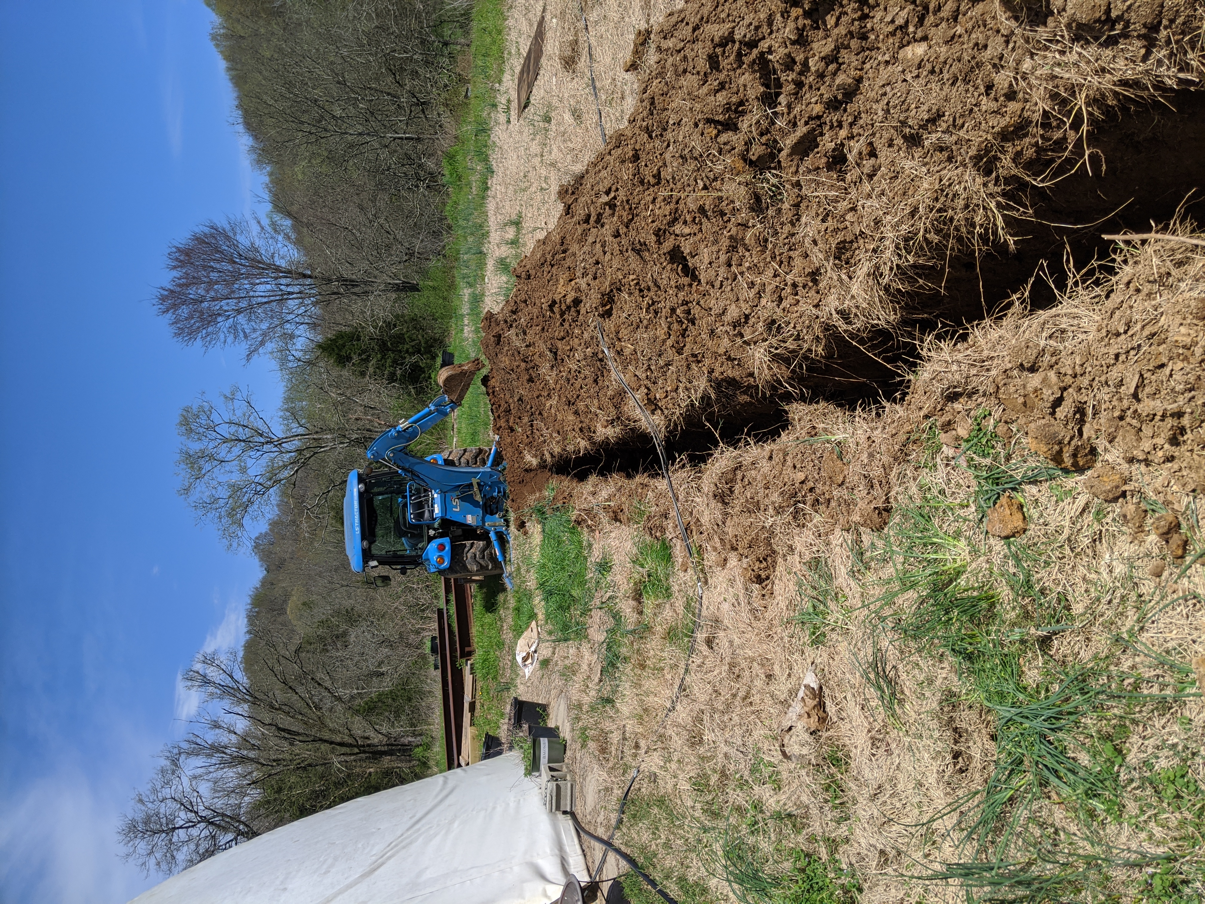

Working on 1500 ft waterline.

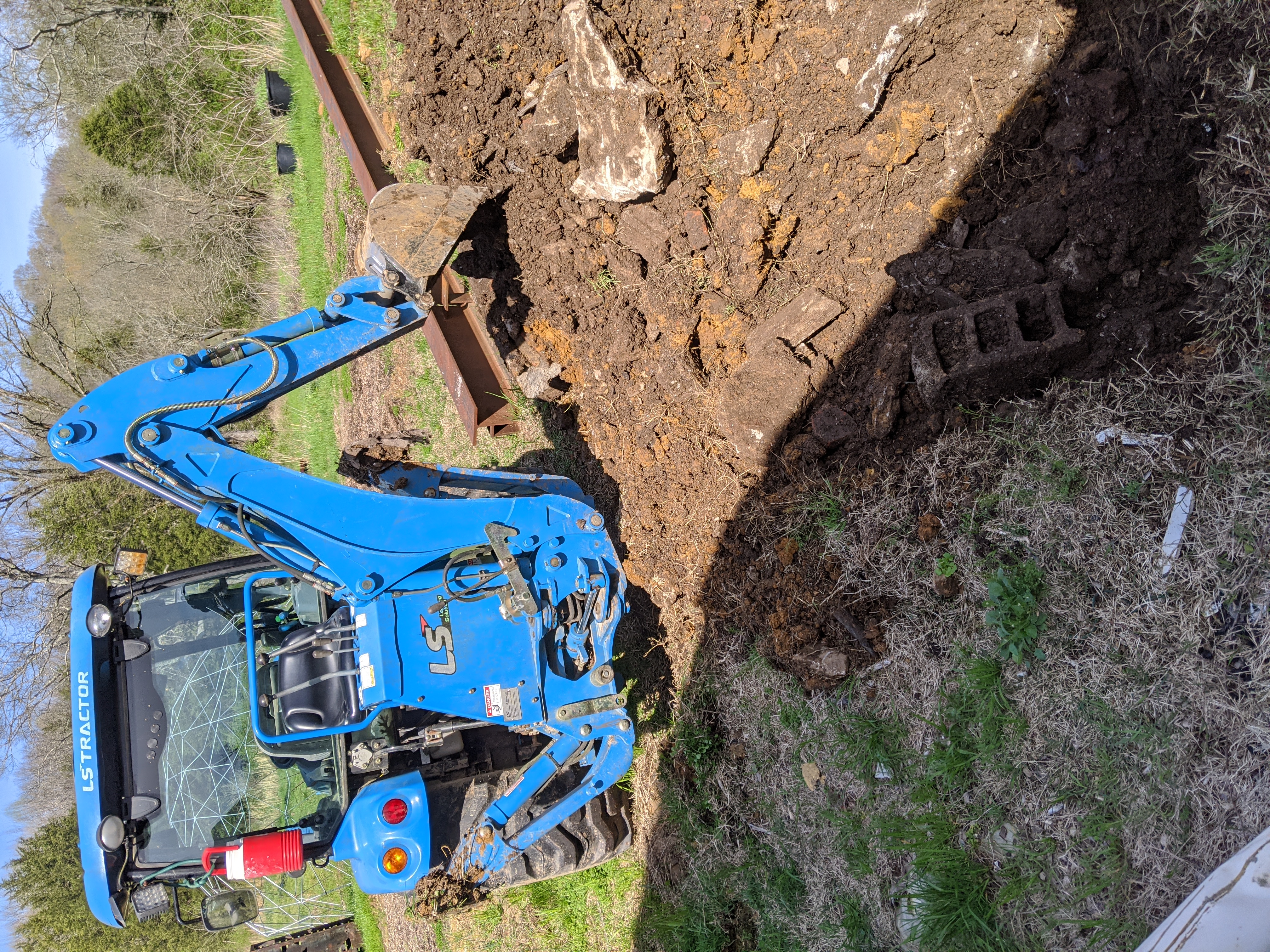

How do you find operating a BH on a cab tractor, compared to open station?
Does the back glass ever get in your way?
I致e got an XR4155HC.
It's a real pain in the arse, hop on, dig 5ft, hop off move 5ft, hop on dig 5ft.....lather, rinse, repeat. BUT it beats all the heck out of a 70 grand machine, that can't ever till, bush hog, plow, or drag the hay trailer at halloween.
To be fair, I had a driver / Beer assistant so I never left the hoe except to pee in the hole.
Same is true even with open station. Years ago I had a 300+ft trench to dig. Painted a red line, lined it up, wife drove tractor and I did the backhoe. Actually it was quite efficient.
You did good 🤙

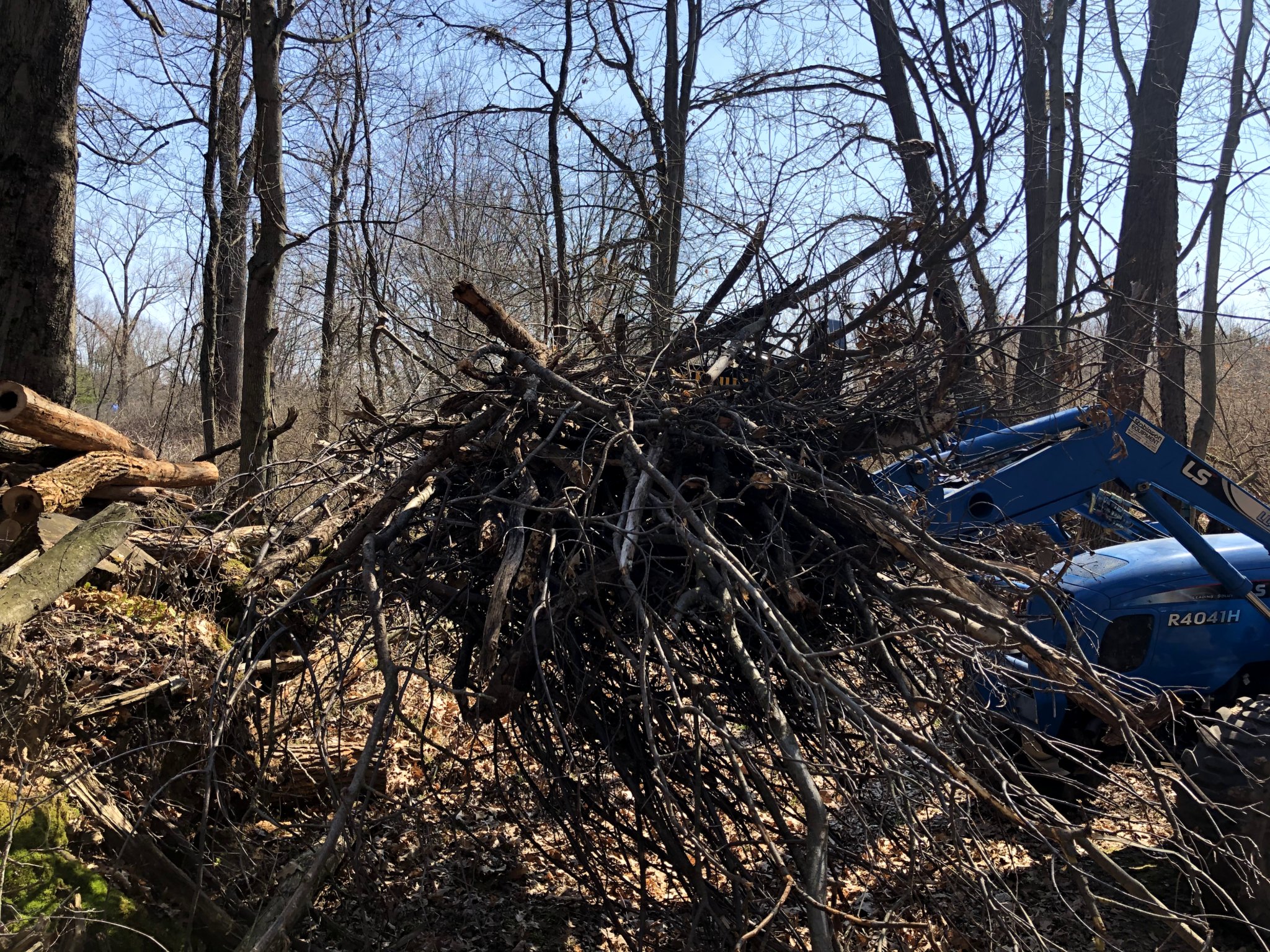

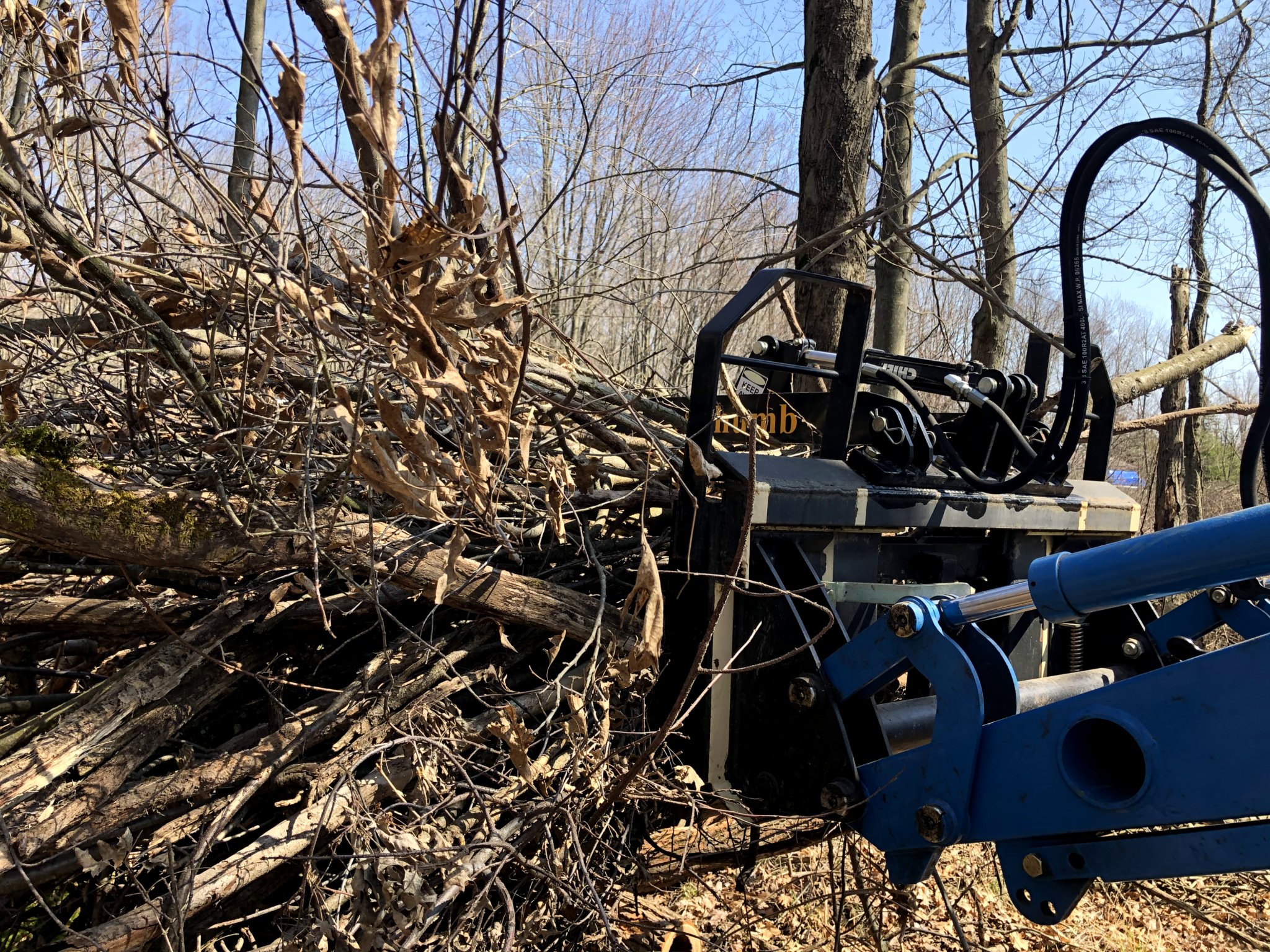

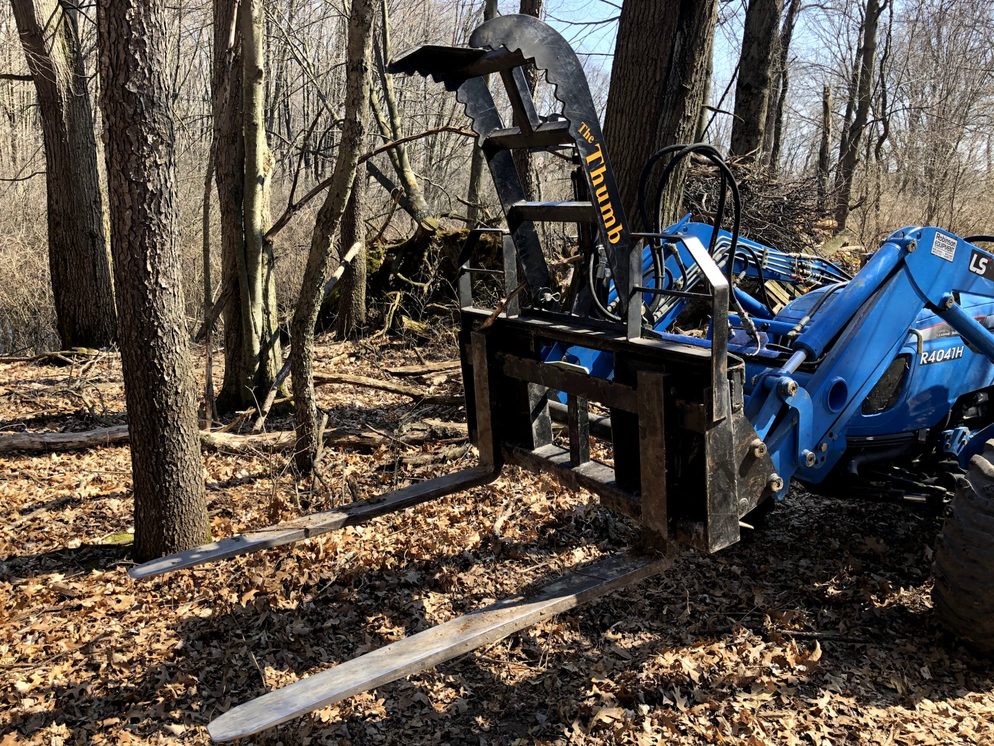

Spent the last two days clearing some land and hauling brush with my "Poor Man's Grapple" .
2020-04-03_15-06-05_534.jpg 2020-04-03_15-04-33_056.jpg 2020-04-03_15-04-19_097.jpg
