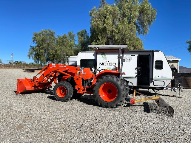

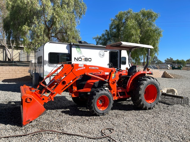

Finished up a little grading project I started yesterday involving some culvert maintenance and gave her a rinse.

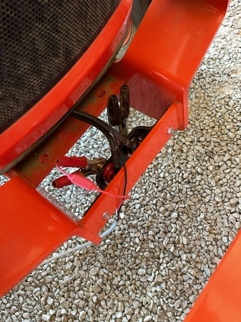

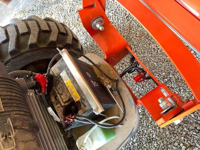

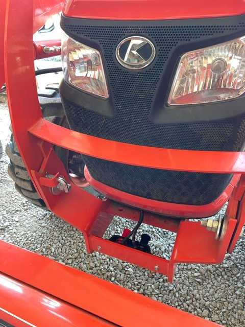

AMazon brought my remote battery terminal kit. While the 'kit' was a bust I ended up using the terminals and making 4g battery cobles to hook it up. Then tested em using the re-fuelign pump. Success.

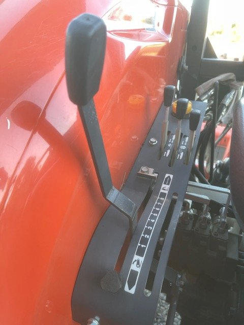

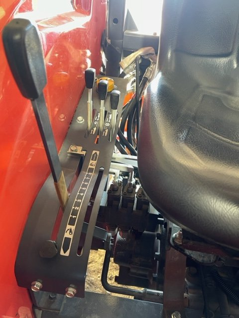

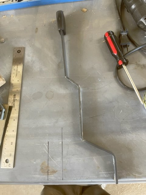

Started my control modifications. Having moved the seat up a little helps but exaggerated the need to improve the 3 remote and bucket control levers.
Dear Kubota putting shrinkwrap over the end of a piece of flat stock is not a handle! Handles on order.
added 2 or 3 bends in the draft lever for more knee room when twisting around in the seat to see backwards... more to come.

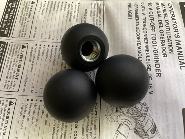

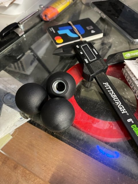

Got the first of the new control knobs. These little fellers will go on the 3 rear remotes. They measure 1" diameter. The insert thread is 1/2 by 13.
Thinking about racking them up short to tall left to right in the order the most Used (Top, Tilt, Rippers). Top = tallest and furthest away from the seat.
