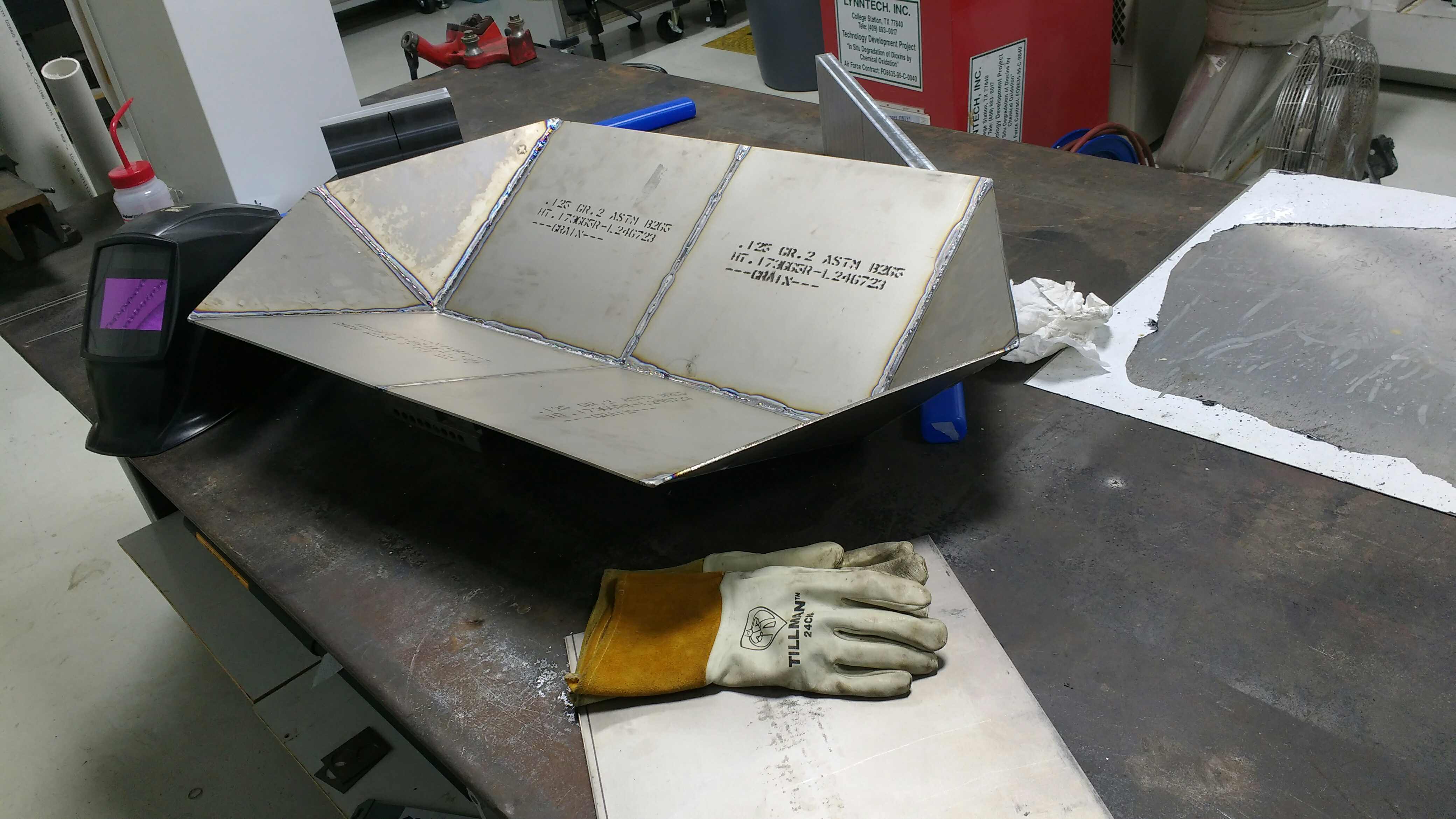

What is the end result of this fire pit going to be, is it something to cook hotdogs on? probably the only project here made with titanium.
That is what is so cool about this project... :cool:
I've engineered titanium in structural applications in my day job but haven't actually worked with it so I'm quite curious on hearing Kyle's perspective.

I just want to see how it works with fire in it. How it radiates. How it holds up. I'm using some left over stock from a project that was finished about 5 or 6 years ago.

I made a skirted spool for a spinning reel out of a Ti alloy. (Ti-6Al-4V) Got a little careless with speeds and feeds and the birds nest of chips caught on fire and burned violently. It burns like magnesium. White hot and quickly.
Former employer had to change the way they dry blasted their medical implants cause the ti particles would settle out in the exhaust duct and catch on fire.
   / What did you do at work today? #118
yes, fine threads or shavings can catch fire. Old Kodak flash cubes had titanium filament in them. Usually, plate Ti does not catch fire. I will be sure to place it away from any building.
