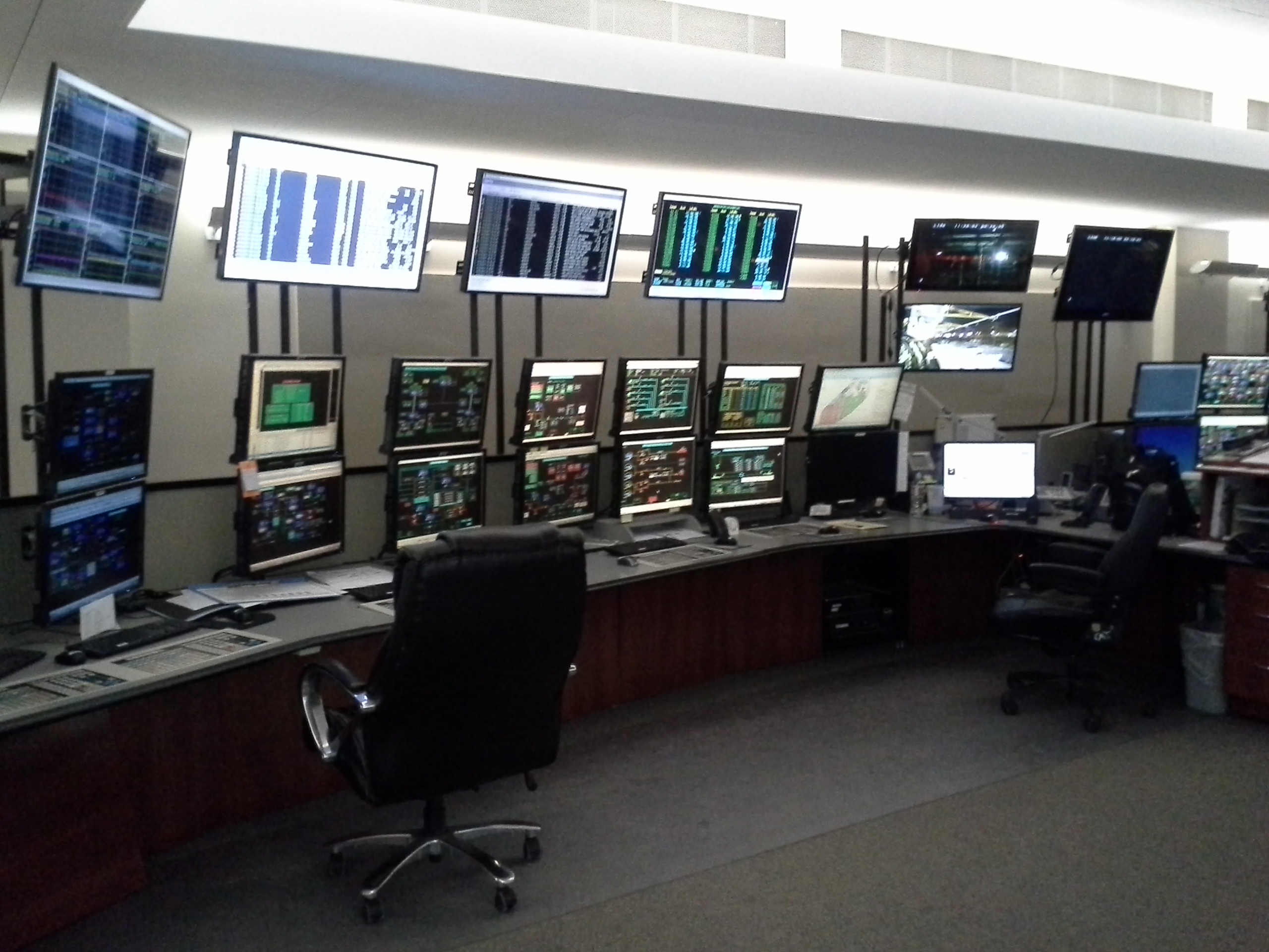

I am still doing my work thing. We, the whole refinery are getting ready to start back up. Had some crude issues beyond our control. This picture is my control board. The PC is currently on the TBN site doing this posting.:laughing:View attachment 499074
Man, when does the rocket take off?
