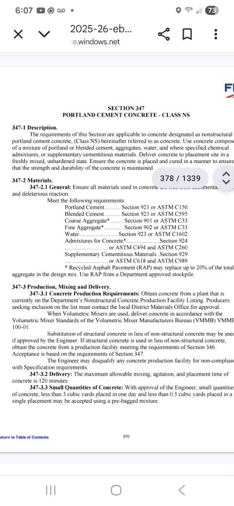

FDOT Type-I Non-structural concrete (NS) has a min 28 day break of 2500 PSI. It often breaks at 4000+. Used in sidewalks, driveways, ect. It's also a fairly old school concrete, and although every batch plant has its own mix design to meet the spec; it's more or less just Portland cement, sand, water, and gravel. Less fly-ash, and other ad-mixes than most other "commercial" 3000 psi mixes.
Sometimes simple is best... Not every mix needs super plastizier, or calcium, or whatever, and often, those "fancy" mixes have draw backs for long term
   / What did you buy this week? #2,596
Wow, this went further down the concrete rabbit hole then intended; but i was just reading the 25-26 spec book, and RAP (asphalt millings) are now allowed to make up upto 20% of the aggregate in non structural Portland cement concrete. That's an odd choice....
   / What did you buy this week? #2,597
Wow, this went further down the concrete rabbit hole then intended; but i was just reading the 25-26 spec book, and RAP (asphalt millings) are now allowed to make up upto 20% of the aggregate in non structural Portland cement concrete. That's an odd choice....View attachment 4047518
that's how I would prefer it to be used in Hot Mix, as aggregate with no asphalt value.
I prefer virgin mixes with no rap. I feel that assigned asphalt content in RAP is often rated too high, leading to dryer mixes.
