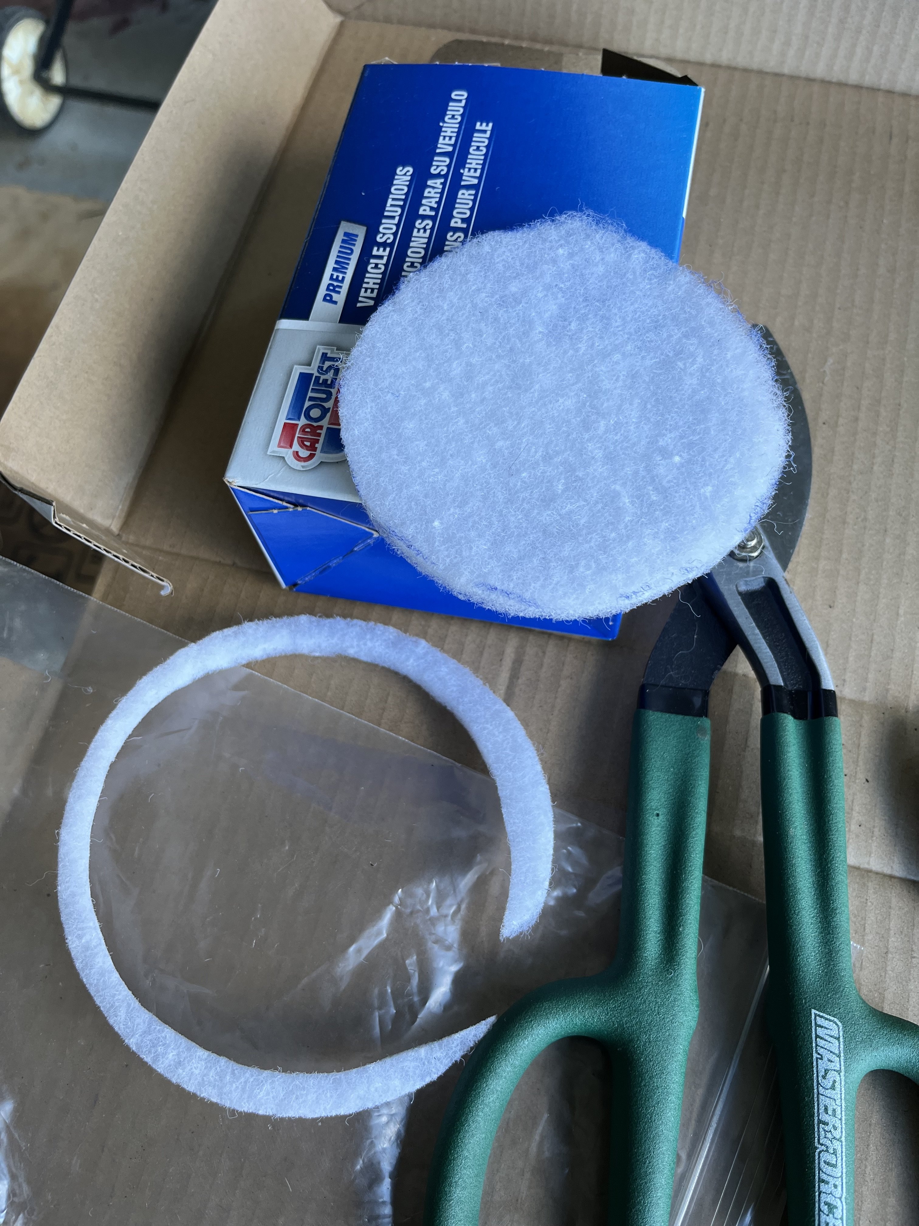

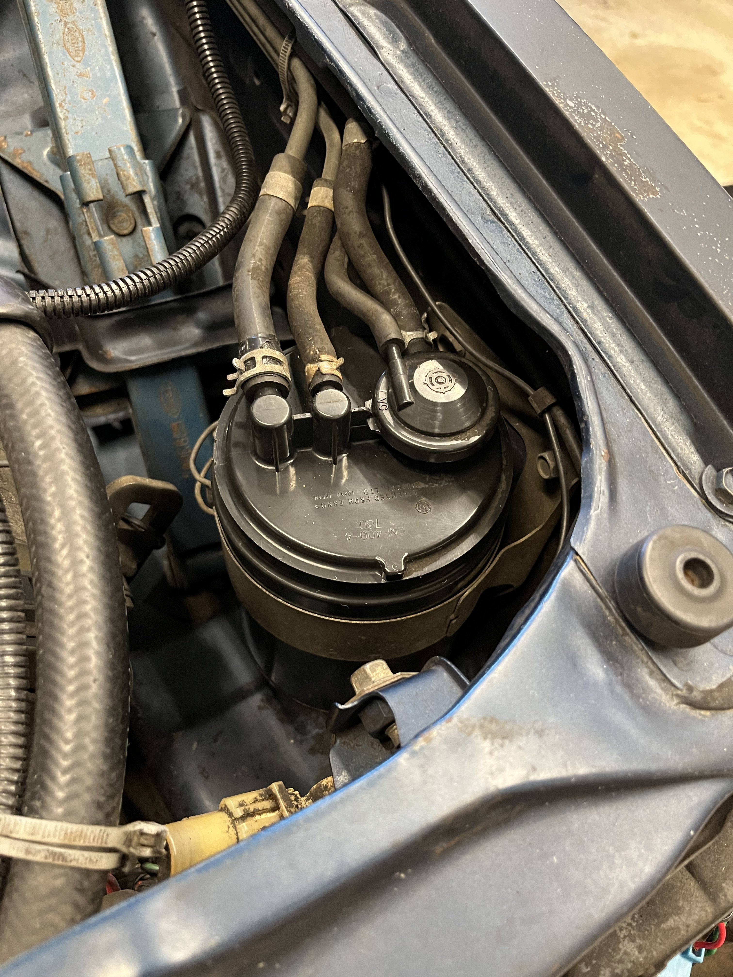

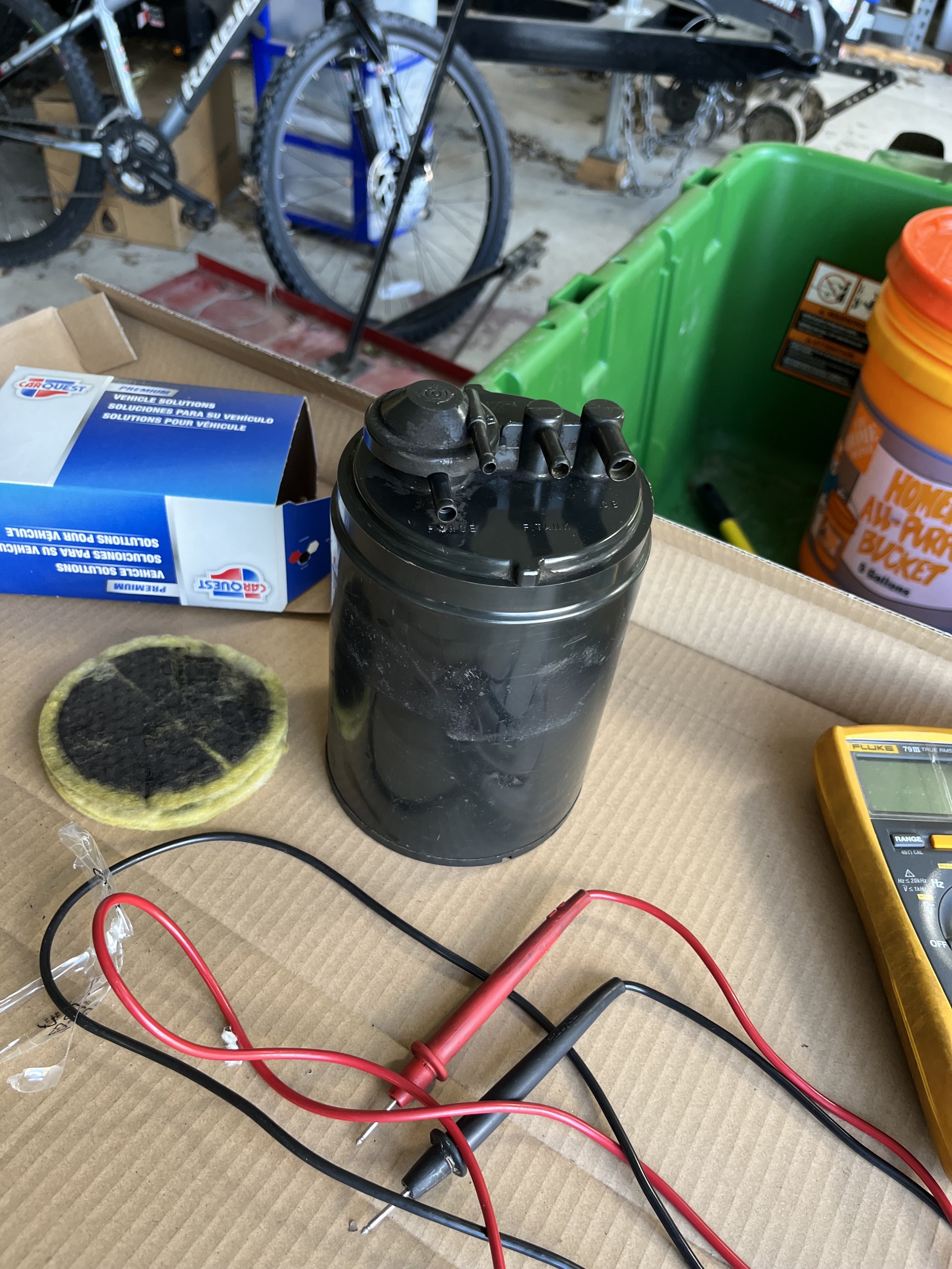

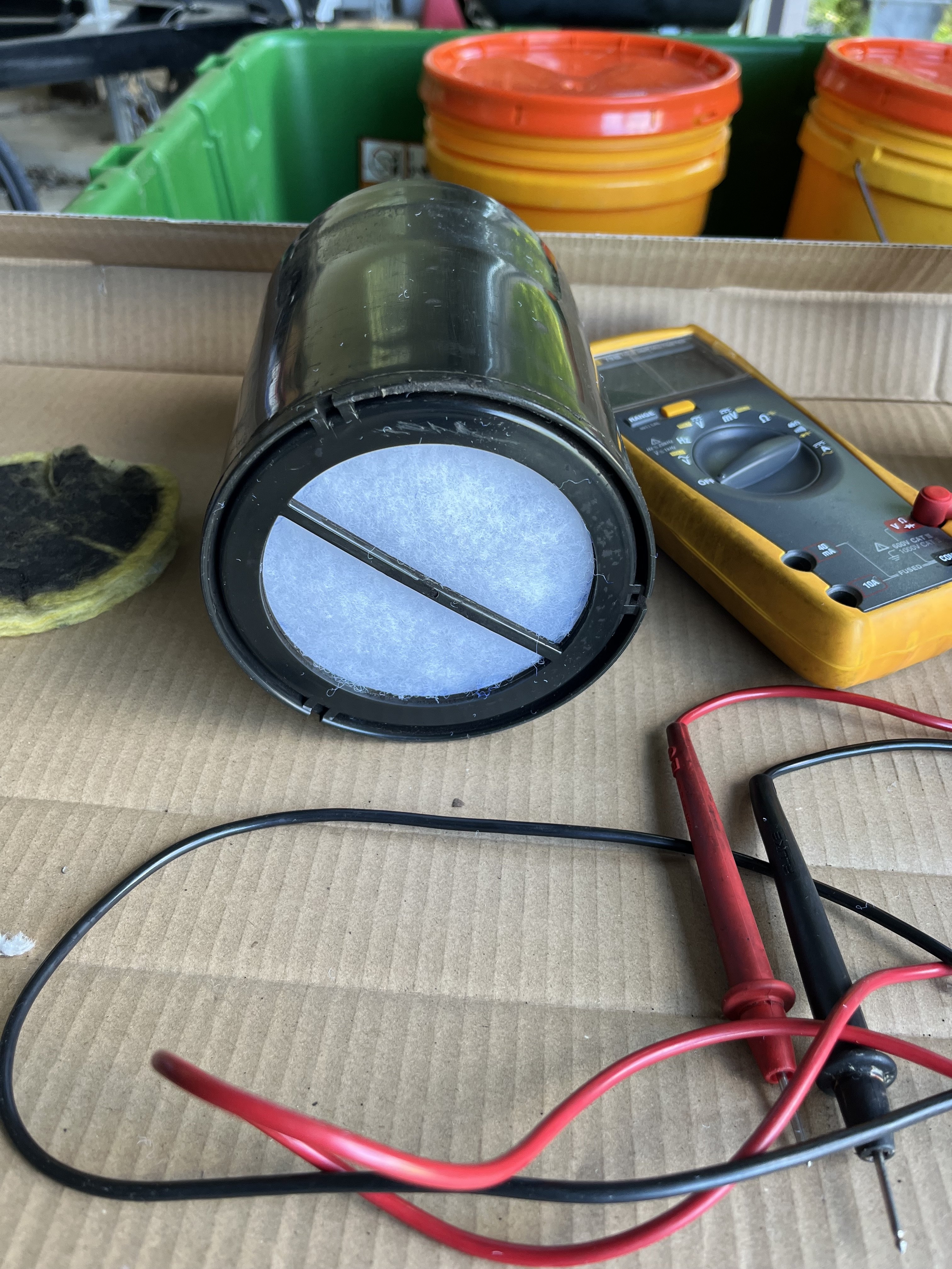

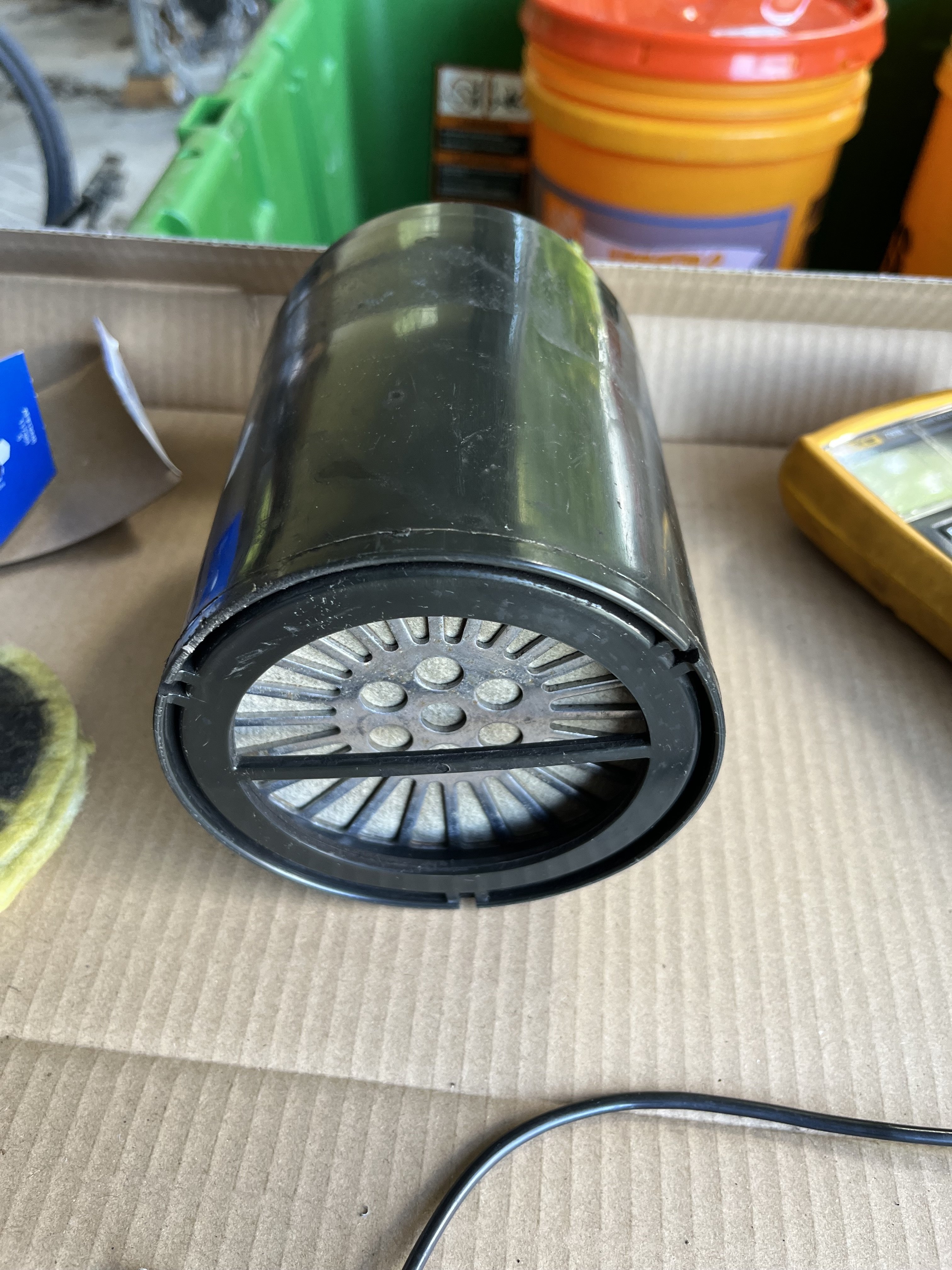

Vapor canister filter for my Brat. Best $2.50 spent at Advance Auto Parts. Hopefully the fuel odors after shut-off and hard starting will go away.

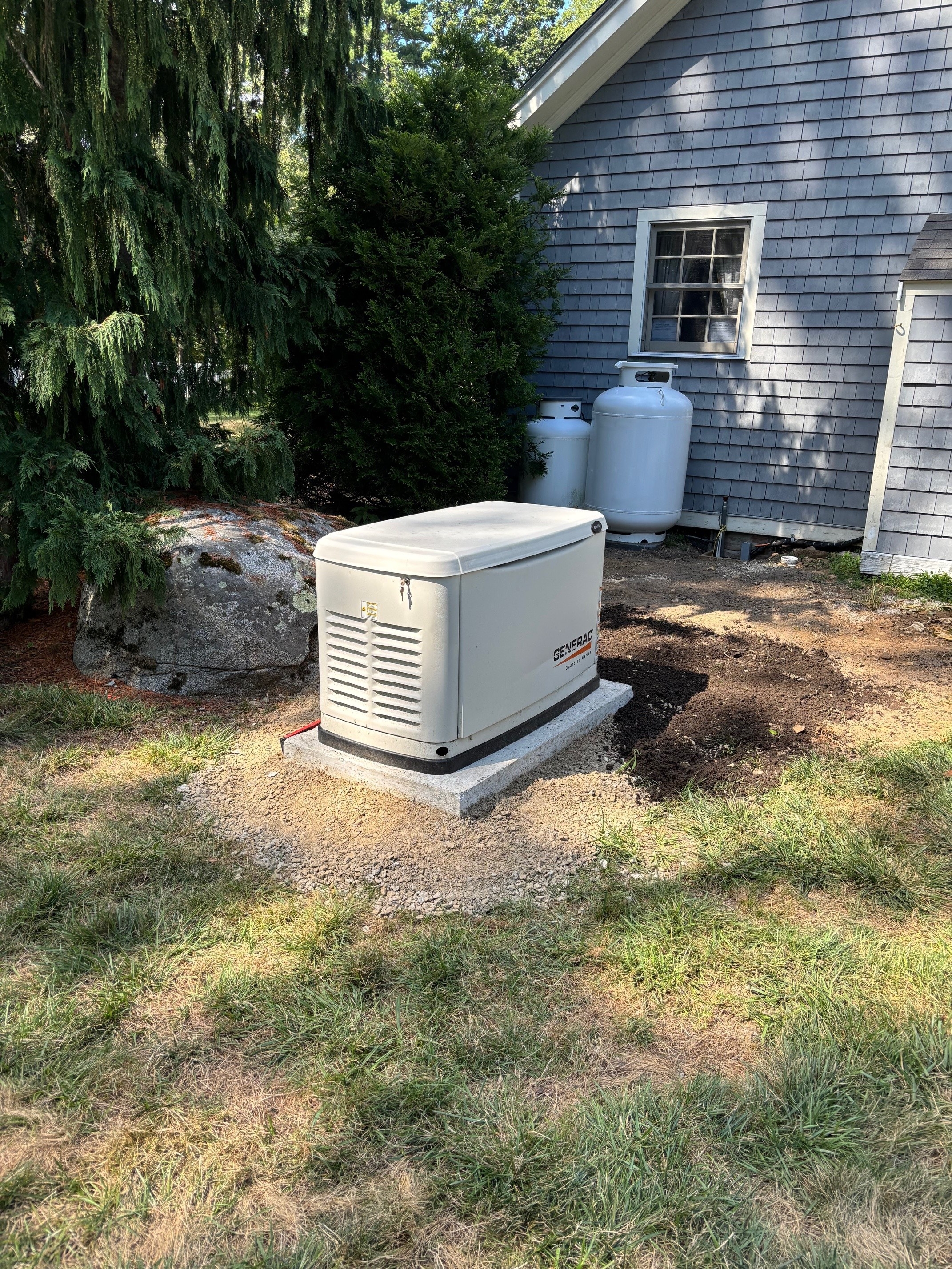

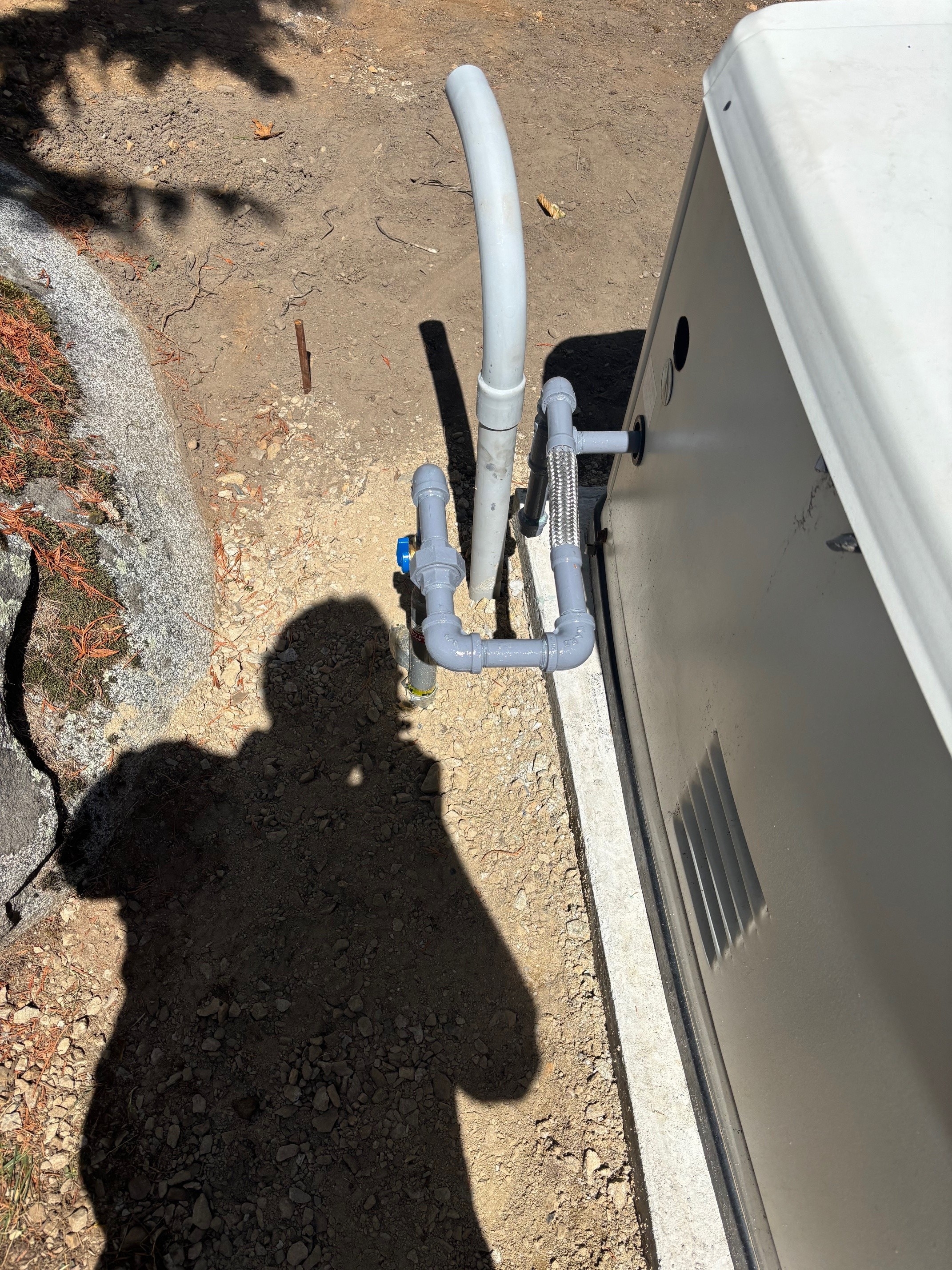

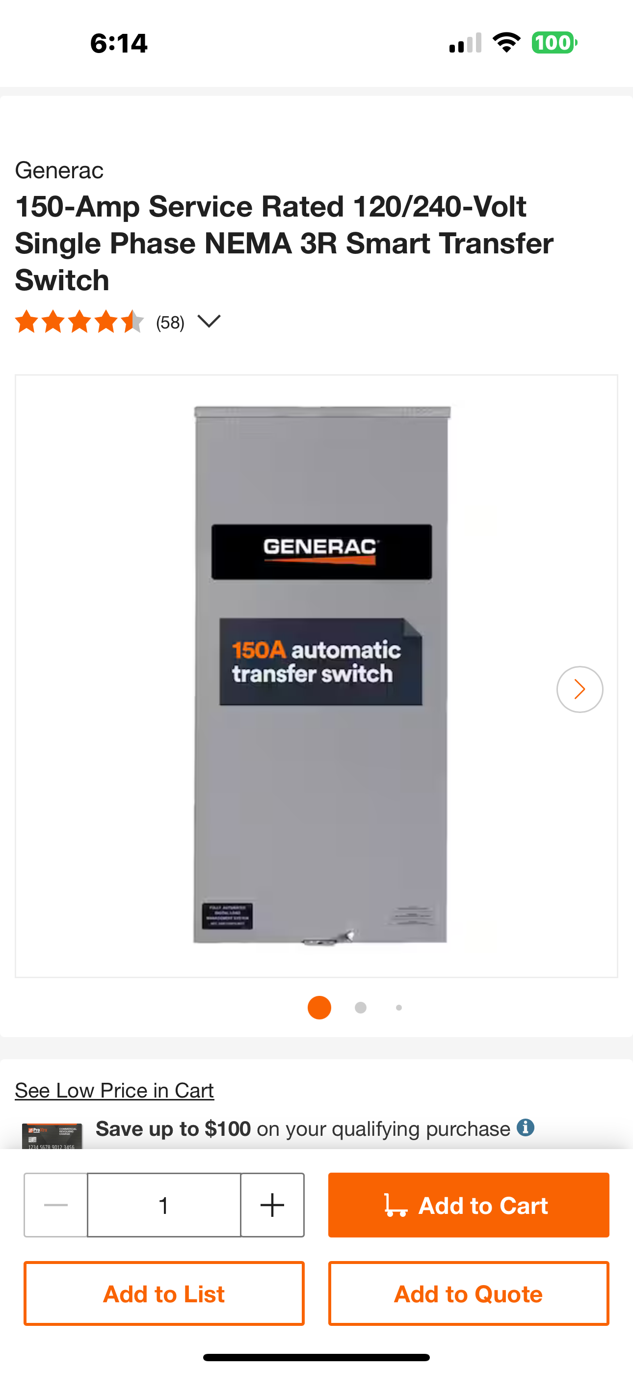

The ATS for the new to me Generac Generator I am installing - it has 180 hours so just broken in. Got the gas line done and conduit all in ready for electrician now once we have the ATS delivered.

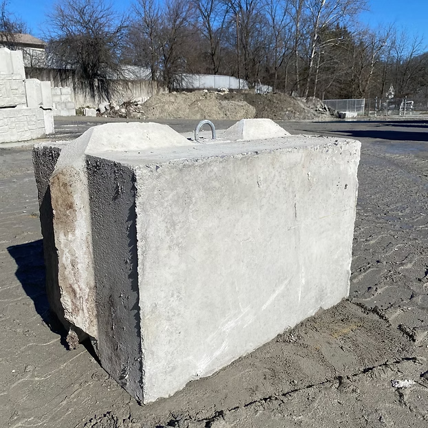

Bought 34 of these 4' x 2' x 2' concrete retaining wall blocks for $50 each delivered.
That's just over $3 / cu ft! I couldn't mix the concrete myself for that price, even if I had the form.
A local concrete supplier makes them up from left overs in their delivery trucks.
Around here they are running $150 plus delivery for the 2x2x6 which weigh about 3600 pounds each.
