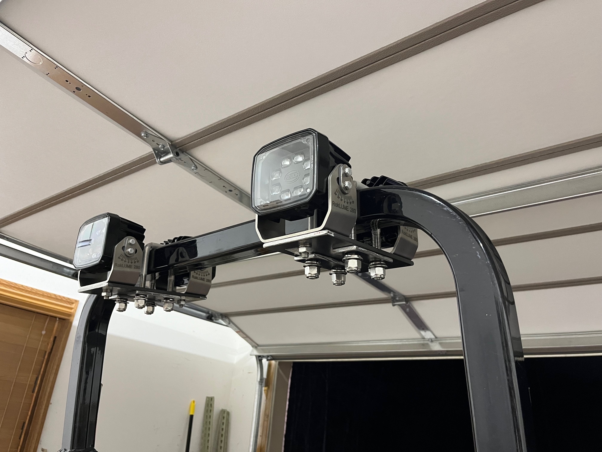

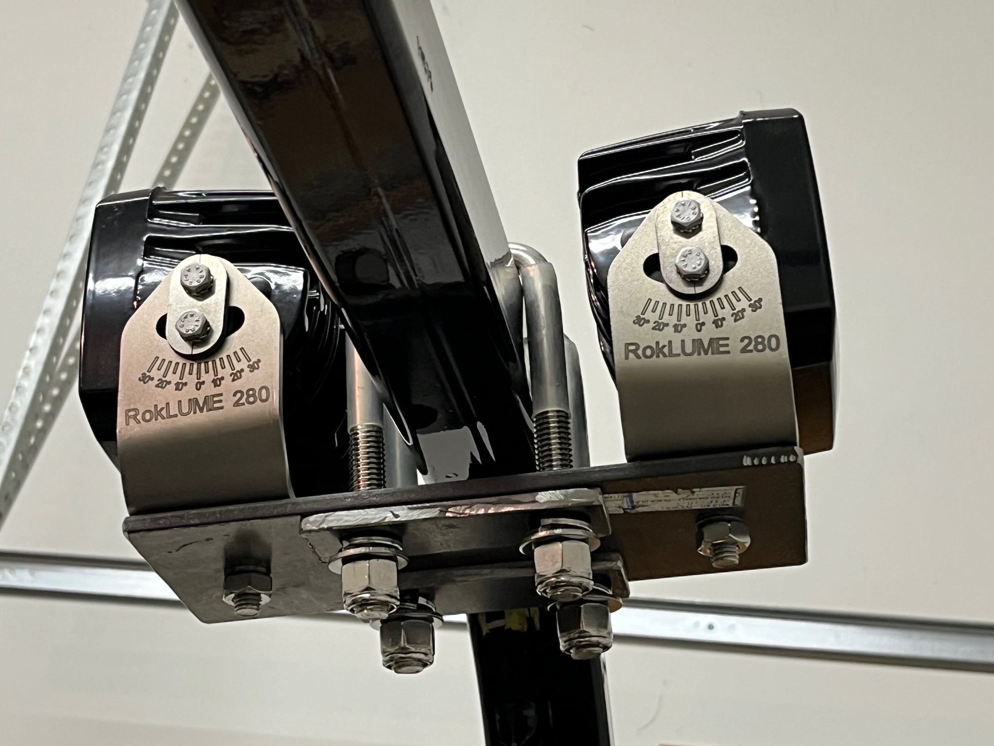

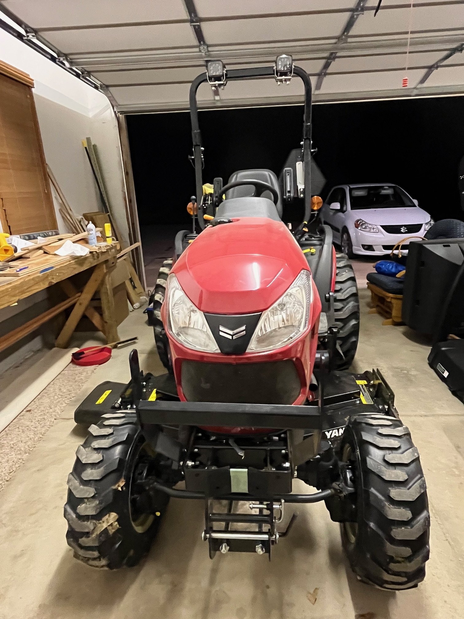

Purchased another pair of Hella lamps. Found some time to construct brackets for the front/rear lights. Used heat shrink wrapped hefty SS square u-bolts with and 12" X 4" X 1/4" steel plates, shortened a bit. A couple of mock up pictures attached with loose brackets. Will disassemble to prime/paint the mounts, secure the lamps and figure out the wiring.
Just a recommendation but I would hang them inverted below the top of the ROPS. One good branch sliding across could remove all four of those lights.

Thank you; good point. Have been thinking about the actual mounting. The Hellas can be mounted three different ways. I could also mount them on the sides of the ROPs. They will be aimed suitably. Have primed and painted the brackets. Should be dry and ready to install today. Will figure out wiring after mounting has been firmed up.
