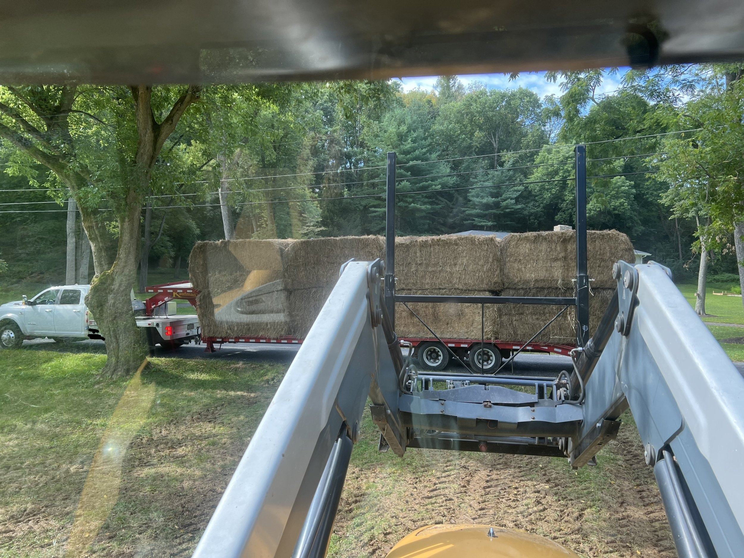

Show me a Ford doing this and I’ll pay attention.
That’s 48,500lbs right there.
