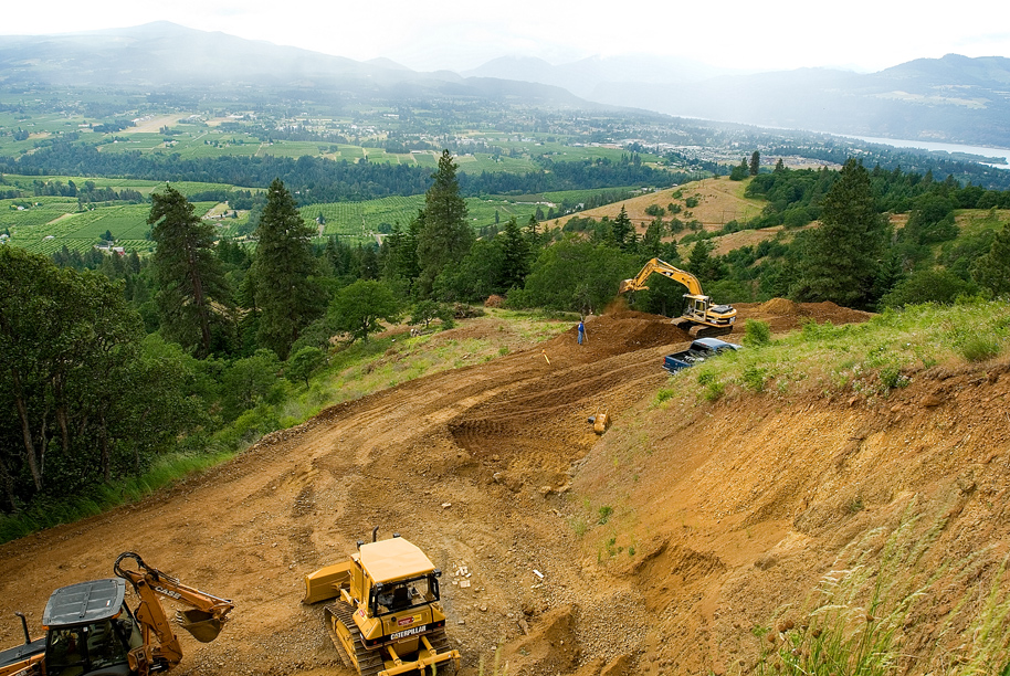

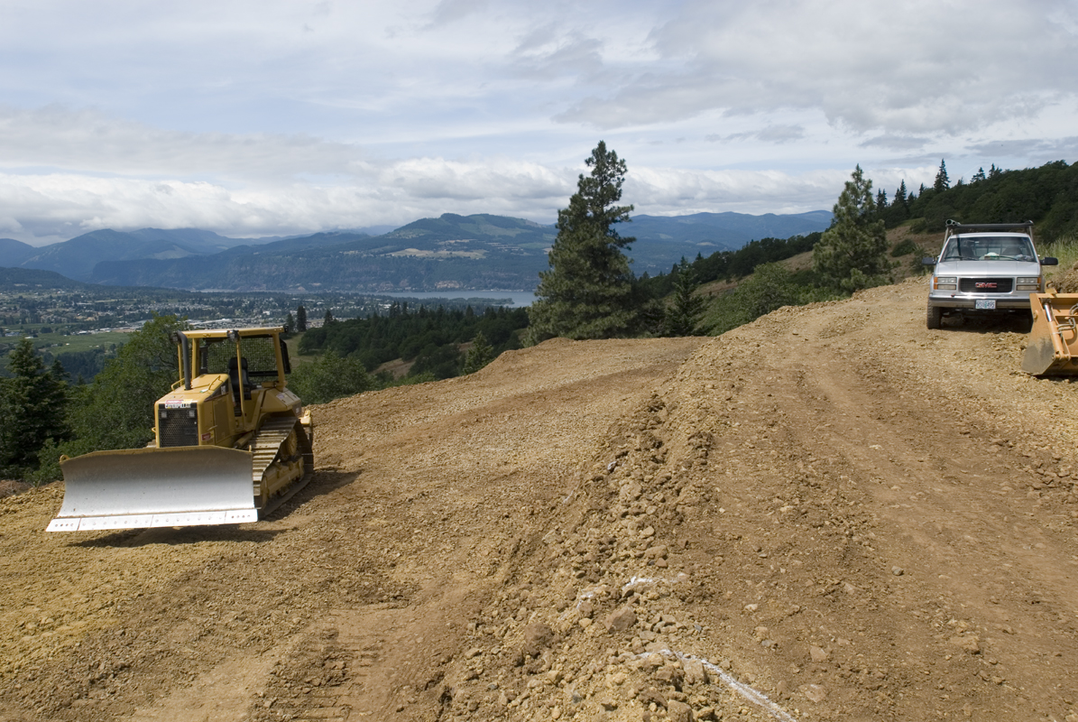

Here are some picts of the build site. This week we broke ground. The excavator crew move a few thousand yards of dirt to create a driveway. I now have to have a 120' x 12' high retaining wall built to keep the driveway from falling into where the house will be.

WOW looks like a dream site there. Must be nice to have access to money printers. An old co-worker of mine retired to that same area, he just finished his house and has a nice view of Mt Hood.
