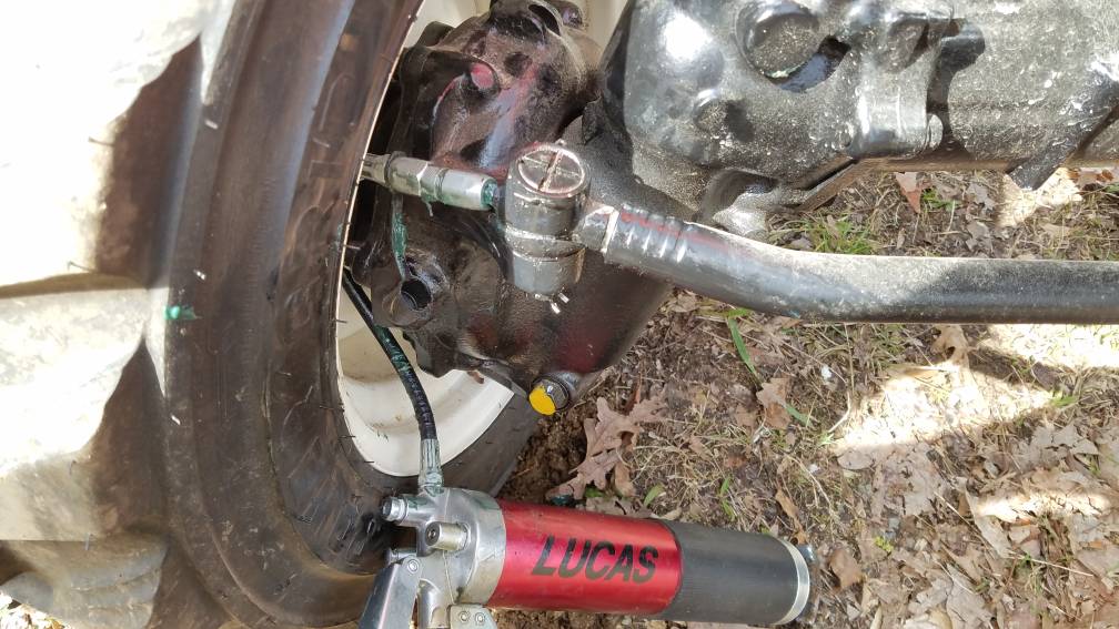

Okay Yanmar, forget everything else I've mentioned in my previous post. Just fix the location of this grease zerk on the 424 steering linkage. Sheesh. Points straight to the inside of the rim regardless of your steering direction, making it a REAL pain to seat your gun (poorly), even the bendy kind like mine. If anybody has a trick or tip for this one I'm all ears! 20180408_154507.jpg

Well surely they meant for you to jack up the front end, remove the wheel, apply grease, reinstall wheel and lower.
Isn't that in the manual ? :D

Amazon.com: Lincoln Lubrication 5883 Slotted Right Angle 9 Degree Coupler: Automotive

I think you're joking but I might actually have to do that!

No, Not joking I have all sorts of grease gun ends It works better when you get the grease in and not all over the place and your clothes:D

"Joking": Sorry, should have replied with a quote to TNAndy who suggested I pull the wheel. I thought he was joking, but I might have to do that. I'll look into those grease gun ends, I think you have the solution. Thanks!
