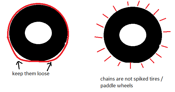

keep the chains loose. allows the chain to spread out in more of a ( vs | shape as the tire rolls over it. creating a much wider area of grip. also it lets mud that will get packed in the grove of tires and chains to fall out. so ya don't end up with a balled tire look (pure mud tire) that is slipping in mud. and it helps keep the chain from being lost within the treads of the tire.
if you wanted paddle wheels, then they would make metal flat bars that would wrap around our tires. but they make chains that are flexible. is there a reason for it beyond allowing a chain to fit multi size tires?
let the tire tread and chain contact the ground, and not holding the tire off the ground via the chain thickness
