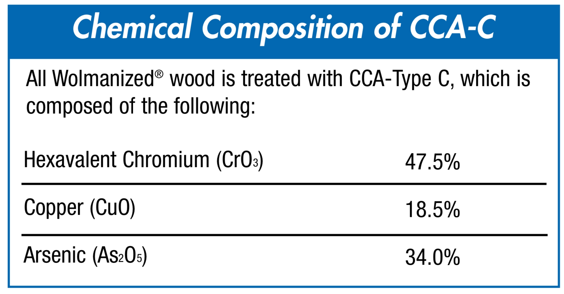

I can remember a treated wood called Wolmanized (sp?) but I think it had cyanide in it or some other toxic substance. That seemed to be the downfall of the good treated lumber.

It was about 20 years ago when they started f ing with the proven treatment chemistry. (CCA)
IIRC the first rendition was corrosive to common fasteners and aluminum flashing. I'm not sure how many changes since then but I don't think the current version is (or maybe as) that was.
In my little bit of checking I was told or read that "timbers" were still allowed to use CCA. What dimension constitutes a timber I don't know.
Yes, it is banned in many areas due to the hexavalent chromium in it (close to 50%). ("CCA-C")
There was another commonly used product that was pentachlorophenol. Also not very healthy for humans, and quite persistent.

Wolman is a company that is big in pressure treated wood. One of the first, I believe. Wolmanized was just their brand name for it. The industry reformulated all PT to get away from the arsenic compounds close to 20 yrs ago. It wasn't just them. They cranked up the amount of copper which costs a lot and was what made all the regular galvanized fasteners disappear in no time due to galvanic corrosion. Developments since then have allowed them to reduce the copper content quite a bit but it is still pretty corrosive thus the need for triple dipped galvanized or SS stuff.
There are still some arsenic based treatments available but they are specialized and not easy to get.
