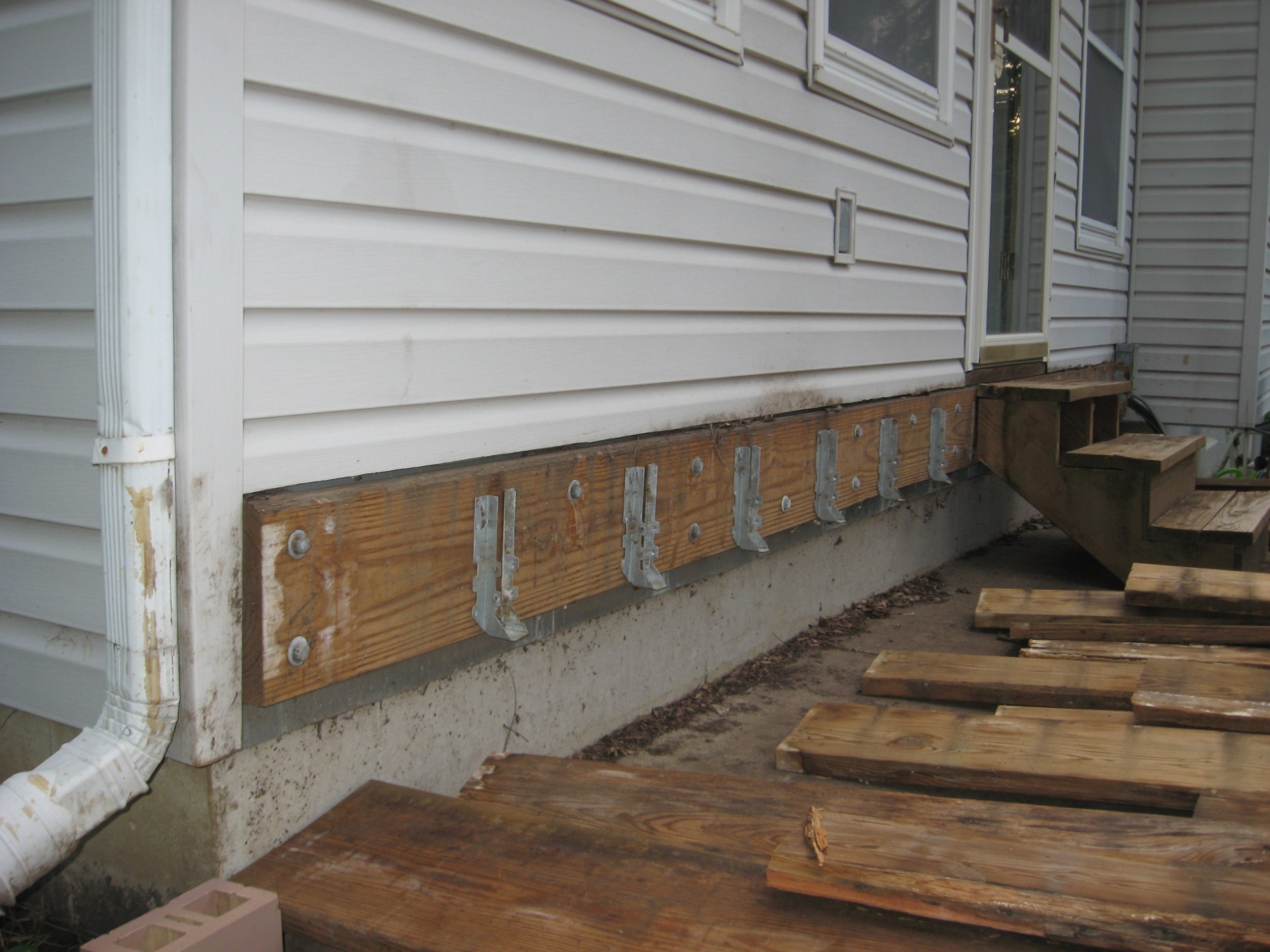

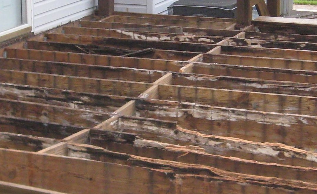

OK, I'm one to own up to my mistakes. However, after looking at this I still don't think that lack of ventilation is the cause of the problem. Look at these two pictures. Notice the blocking between the joists and the ledger board. The blocking is made from the cut off ends of the joists and the ledger is also from the same brand/batch of lumber.
All of the blocking and the ledger board are still in perfect condition, while the joists right next to them are completely rotted. The only difference is that there are no screw penetrations in the top side of either the ledger or the blocking. Also, the ledger and blocking are not even discolored like the joists.
Therefore, I believe the cause of the rot in the joists was water intrusion through the screws from the top of the member. I don't know how this could have been prevented, perhaps using lumber with a treatment process that would have resulted in better penetration (like maybe lumber rated for total water submergence, etc.) or maybe the stick-on tape/membrane applied to the top of the joists. Maybe someone makes a floor board anchoring system that does not rely on screws from the top.

I don't believe the screws caused the rot. IMO, the moisture from above and below got trapped between the deck boards and the upper portion of the joists where there was little to no air circulation.

Thanks for all of the pictures of your deck and the debriefing on the possible causes of the deck failure(s). I do think that you did a great job on the deck and I'm sorry that it failed before it's time.
The joist rot is what the butyl joist tape is supposed to prevent. The idea is that moisture can't wick along the fasteners, nor can it pool on top of the joists. Perhaps it is just the camera angle, but I do seem to see some whiteness (mold?) on some of the blocks, so I tend to think that the penetrations may have caused the failure, but the speed of the failure was at least somewhat accelerated by high(er) humidity under the deck. If it was just water pooling on top, the blocks would be as bad as the joists, and they clearly aren't as bad.
After our deck rotted, I have come to the conclusion that wood decks are not permanent and will need replacing sooner or later. As I wrote above, the alternatives to a wood deck (concrete, steel, or aluminum) for us were several times the cost of a wood deck, and I have made peace with the need to replace the deck at some point in the future. However, the local fire codes have been revised here and a wood supported nonflammable deck, such as composite or metal, no longer qualifies for the highest rating, something that wasn't even being discussed when our current deck was put in. So that's a "win some, lose some" for us, as we will need to build steel or concrete underneath next time.

Over the years, I've been under quite a few decks here in East Texas. We get pretty warm in the summer, but our humidity is what really causes everyone to suffer that lives here.
The humidity causes condensation, under the decking. It's kind of random where it's at. I've seen areas that where totally black from mold growing on the joists, and two feet away, it's clear of mold. Everything that I'm seeing in your pictures looks just like what I see under those decks. Usually the client will agree to add more vents to their skirting, but a lot of the time, they don't like the look of vents, so they don't do anything.
I've never seen a deck with any mold growing under it that was open on the sides. Those decks always fail due to poor design and construction. In my opinion, almost nobody understands the basics of construction when building a deck. But in your case, you got the basics right and I don't see anything wrong with how it was built except for the skirting.
As for the quality of pressure treated wood that is available today. I agree that their are issues. But I also know that everyone was saying the same thing about treated wood 20 years ago. It's a common thing to blame the wood, and never how it was built.
The issue with todays treated lumber is the amount of water used in treating it. All that water takes a very long time to leave the wood. When this happens, the wood shrinks. You never know how much it shrinks, so gaps between decking can be inconsistent. 45's on railings will open up and leave huge gaps in a few months. Staining has to wait until the wood is dry, which could be six months later. Cupping on decking is more pronounced, no matter which way you install the boards. 5/4 decking is now a very bad idea, it's shrinks like crazy. 4x4 posts twist too much to use, but they where always a bad idea and should never be used for supporting a deck. Nails should never be used on anything that exposed to the elements, they will loosen up over time. And the biggest thing that people get wrong is not using beams to support their joists. This is probably the most common reason that a deck fails, and I get hired to build a new one. I've never seen a deck fail because of the quality of wood.
