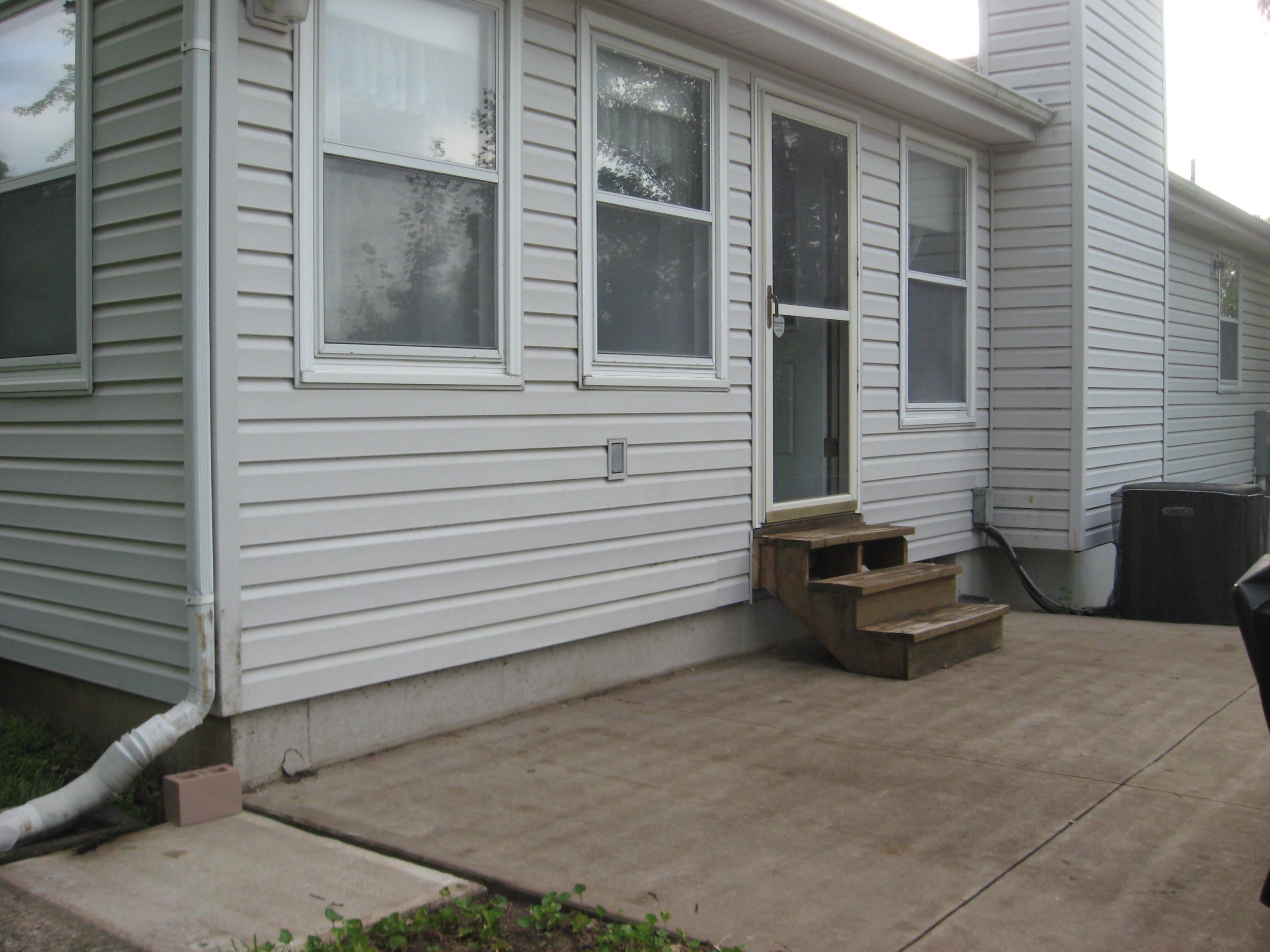

It would be helpful to see a picture of the patio area like post #41 after everything that's been cleared off.
Stairs would be less intrusive if the door could be relocated to the area where there's a window next to the chimney chase.
If you could scale down the size of patio furniture, that might help, too.
Very true, having the door/stair near one side of the slab instead of the middle would have been much better. I would just add that to the list of about 6 million other things I would change about this house if I could....

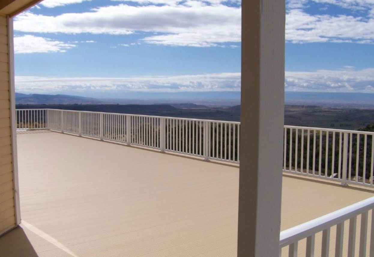

My treated wood deck rotted off 10 years after I built it. I replaced it with extruded aluminum planking:
It's waterproof and creates a dry space underneath.
After 18 years, it looks almost the same as it did when installed.
At 3x the cost of treated wood, it's pricey but it will never have to be resurfaced, repainted or replaced.

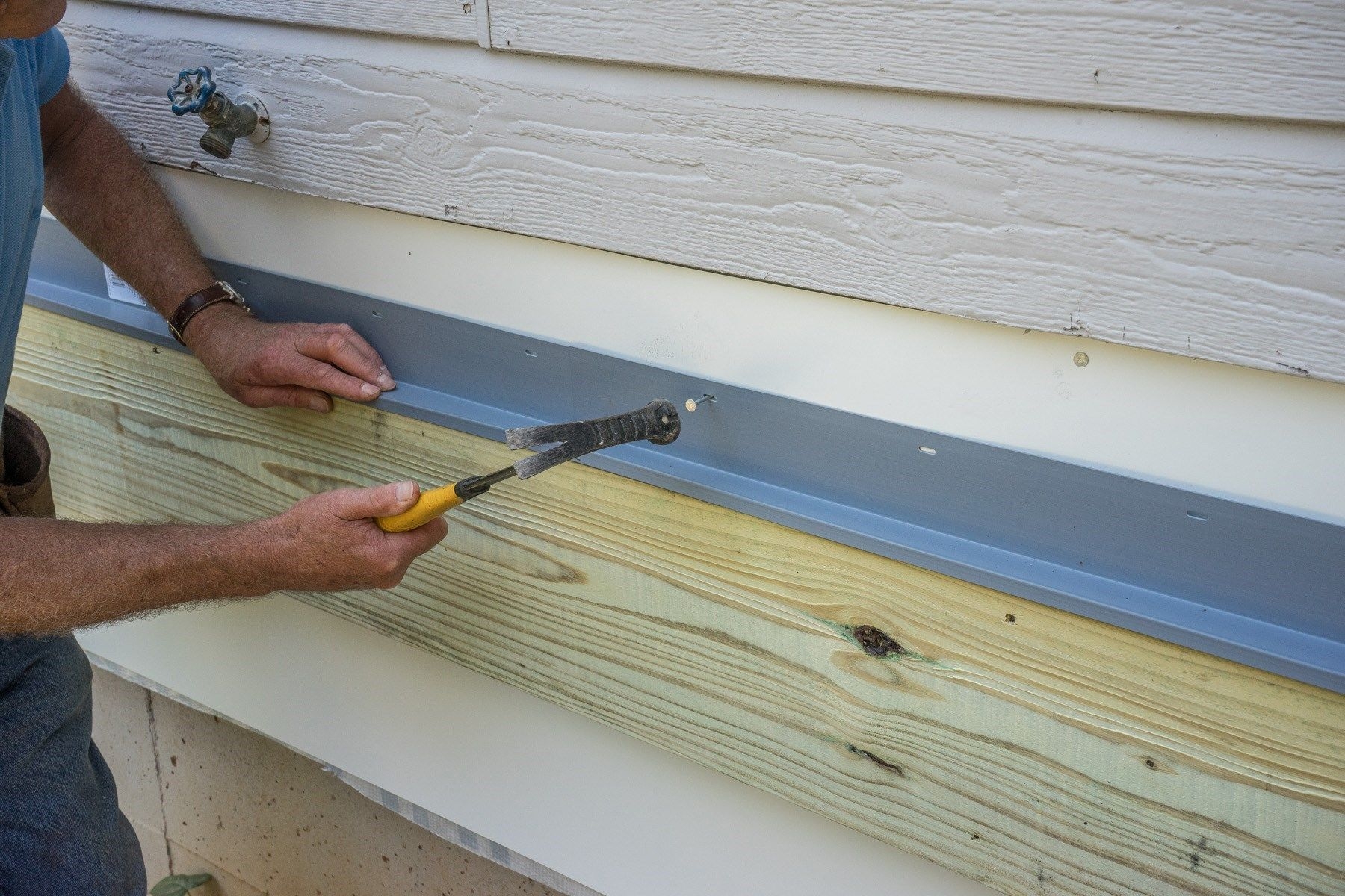

Z Flashing is usually used to protect the ledger board
