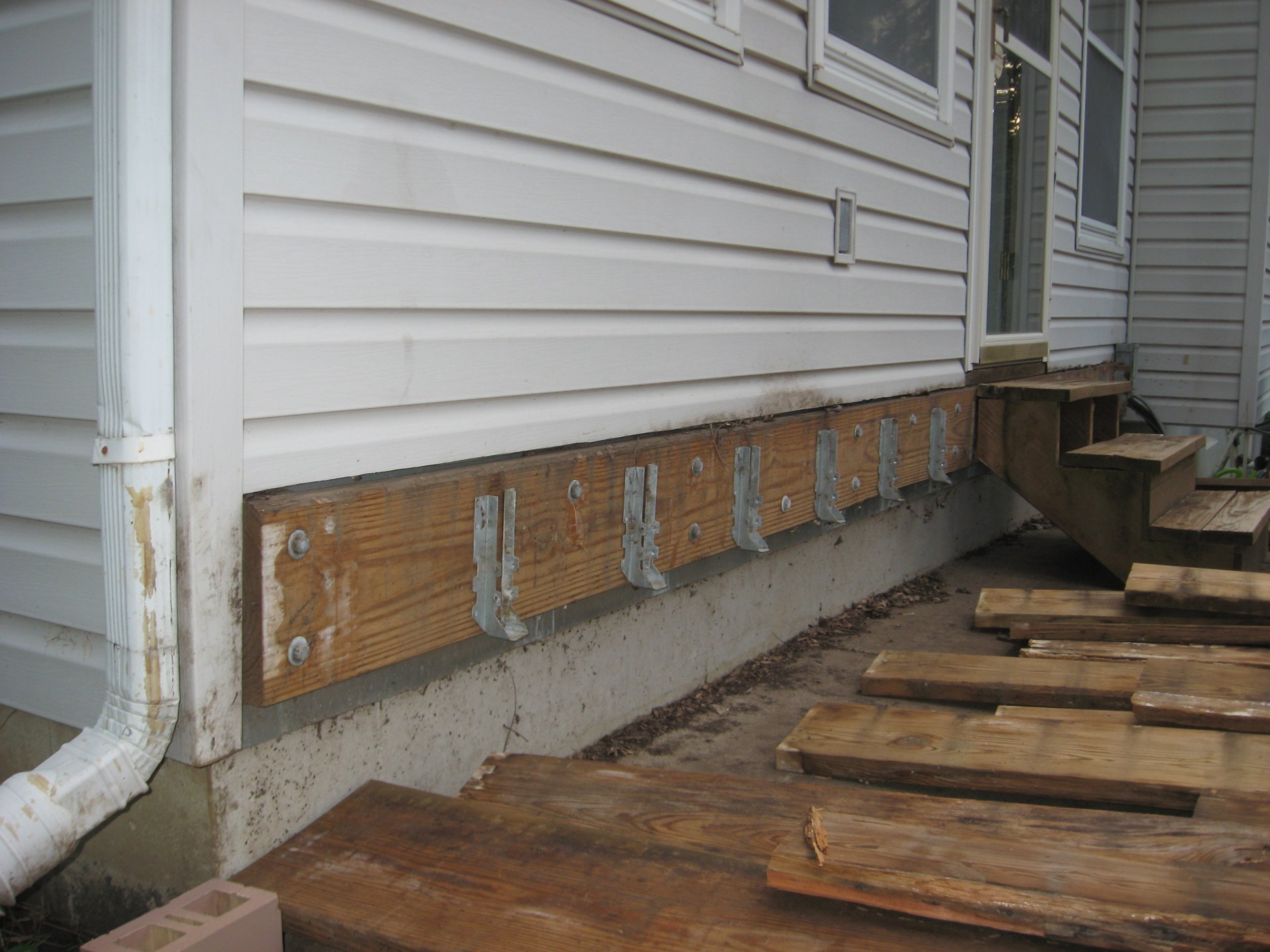

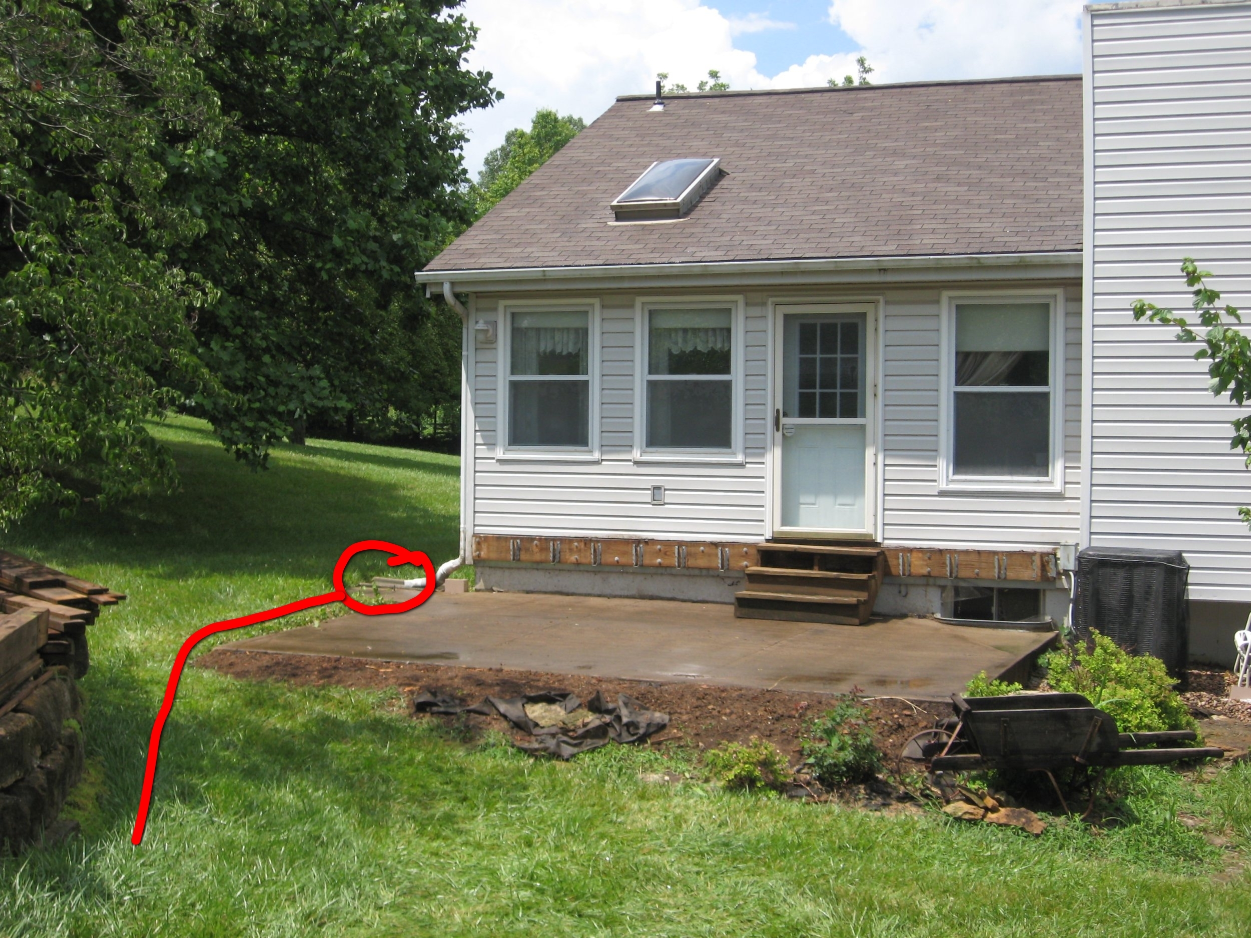

I really thought I had this one figured out. No part of the structure touches dirt. The beam is sitting on concrete piers, 6" above grade (no posts in the ground) and the rest is 15" above the concrete.
I never in a million years thought that enclosing the area underneath could cause this kind of damage. The idea was to keep the trash and animals out from under there and make it look better. Oh well, live and learn.....
If I had to do it again, I probably would just use some kind of galvanized mesh screening mounted in a picture frame type arrangement for the skirting.
At this point, I just want to get this garbage out of here and get back to a patio. The hardest part will be fixing the siding I had to cut to install the ledger board. I have some extra siding from the original install, but not sure it I have enough. The siding has been on there for over 20 years, so not sure I'll be able to find a match if I have to buy new.

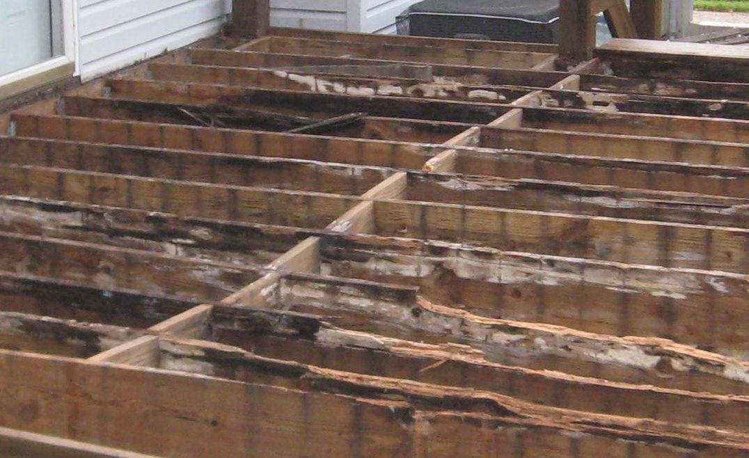

A deck needs air flow. Adding vents to an enclosed deck will not provide enough air flow to keep the deck dry.
Most of your moisture under your deck is from condensation. This also what causes water to from inside metal buildings that make it feel like it's raining in them, and leaves the concrete floor wet in the morning. There might be some water from rain when that happens, but moisture coming up from the ground isn't happening unless you built it over a spring.
Just like in the attic of a house, when the air temperature drops to the point it cannot hold moisture vapor, it becomes solid, and forms water. An attic has vents in the lowest part of the roof that allows air to enter the attic, and vents at the highest point that allows air to exit the attic space. When the air gets hot in the attic, it rises, and creates air flow. An attic has to be hot for this to work. The air flow dries off the morning condensation that forms under the roof.
Your deck trapped the air under it. There was not a path for air to flow so it could dry off the underside of the deck. Warm temps, moisture, and the nutrients in the wood created the perfect place to grow mold. The treatment in the wood wasn't able to stop this, and the mold quickly ate up your wood. Treated wood cannot remain wet all the time unless it's specifically treated for underwater use. It's not that the treated wood you bought was bad, it's that you used it in a bad way.

I would have thought the concrete slab underneath would be somewhat of a moisture barrier?
Yes, and no. Rainwater coming through the deck gets contained in the space, raising the humidity and increasing the speed of the corrosion and rot. As other have written, decks need free air flow with as coarse a screening as you are comfortable with.

I think you're right. I notice the joists where the rot happened is also where all the screw penetrations are. The blocking between the joists (and where there are no screws) have almost no damage at all. I'll bet this product would help that situation.
The butyl versions are very good at resealing around the fasteners. I use butyl tape everywhere now, as flashing, under metal, etc..
