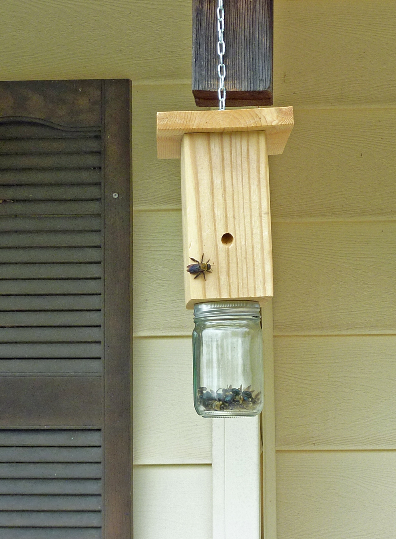

At the risk of derailing the OP's thread, try one of these traps:
Swat one and put it in the jar as bait. Hang it in a sunny area near where the bees are active.
BD, feel free to "derail". Those things are eating the rafters of one of my barns too, so this is of interest to me. How does the trap work?

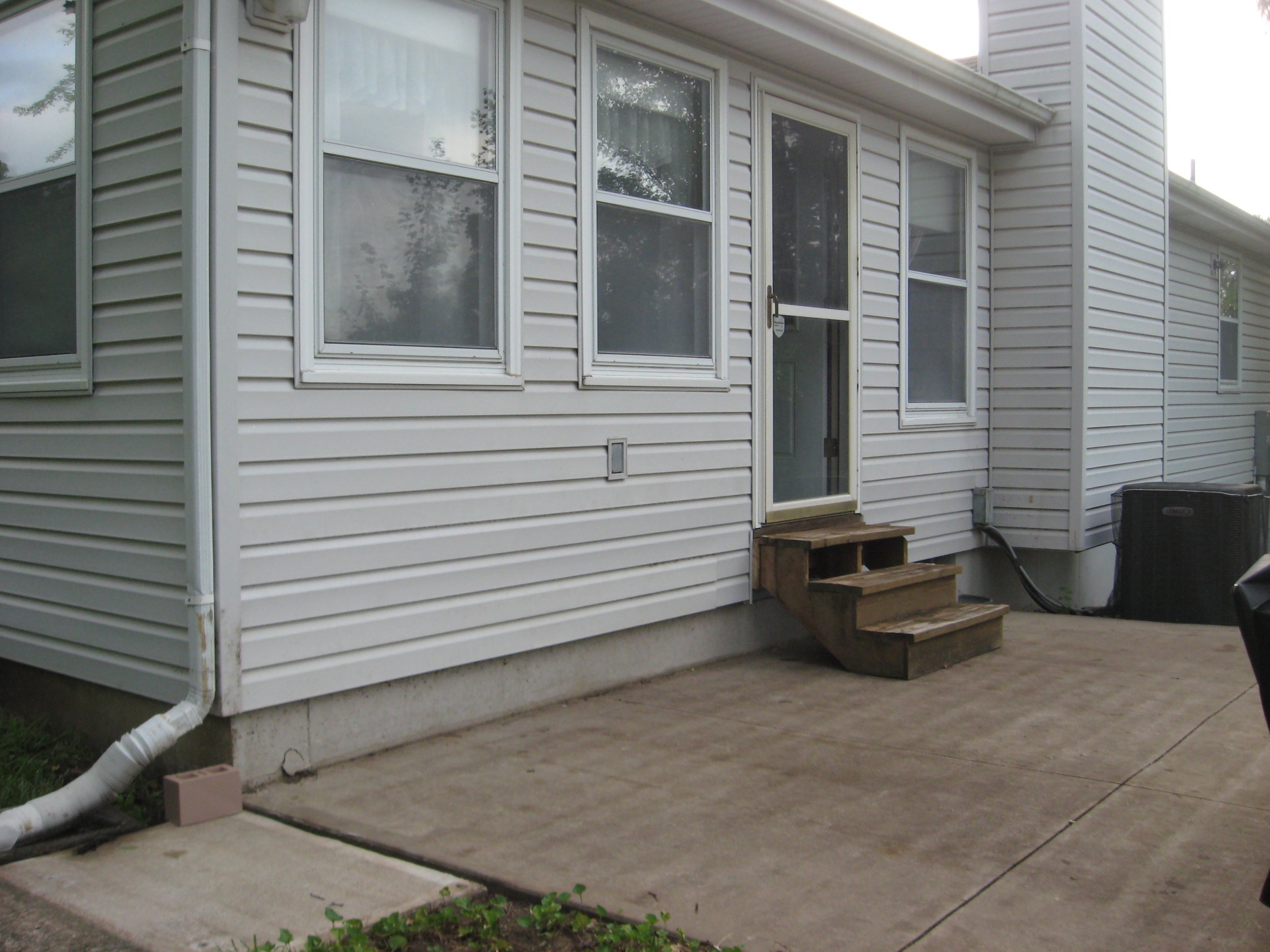

Replaced the missing siding yesterday and this morning the deck went bye-bye in the dumpster. Next will build a little more permanent stair/landing. Going to try to re-use some of the good pieces of lumber reclaimed from the old deck (yes, there actually were a few, mostly deck boards and guardrail pieces).
Discovered another occupation I don't want to be - siding installer...
Looks good

Thanks. I was able to cheat because I still had all the original pieces, including the insulation and starter strip. So, I just lined up the old nail holes and didn't have to do any leveling. Just had to cut a couple of new pieces to length and re-use the old ones.
They work very well. The bees are drawn into one of the holes and see light below. The light attracts them and they can't find their way out. I have to empty that jar twice a season. In three seasons, I have almost eliminated them all.
As I said, the trick is to place it in a sunny area near where they are active. A dead bee in the jar is also good bait.

They check in, but don't check out.

I have several of these. Problem is, they fill up in no time. I have found it works best for me to spray the wood with high yield 38

Yeah, they can be a pain to empty if they're not in a convenient location. I can easily reach mine from my elevated deck.
