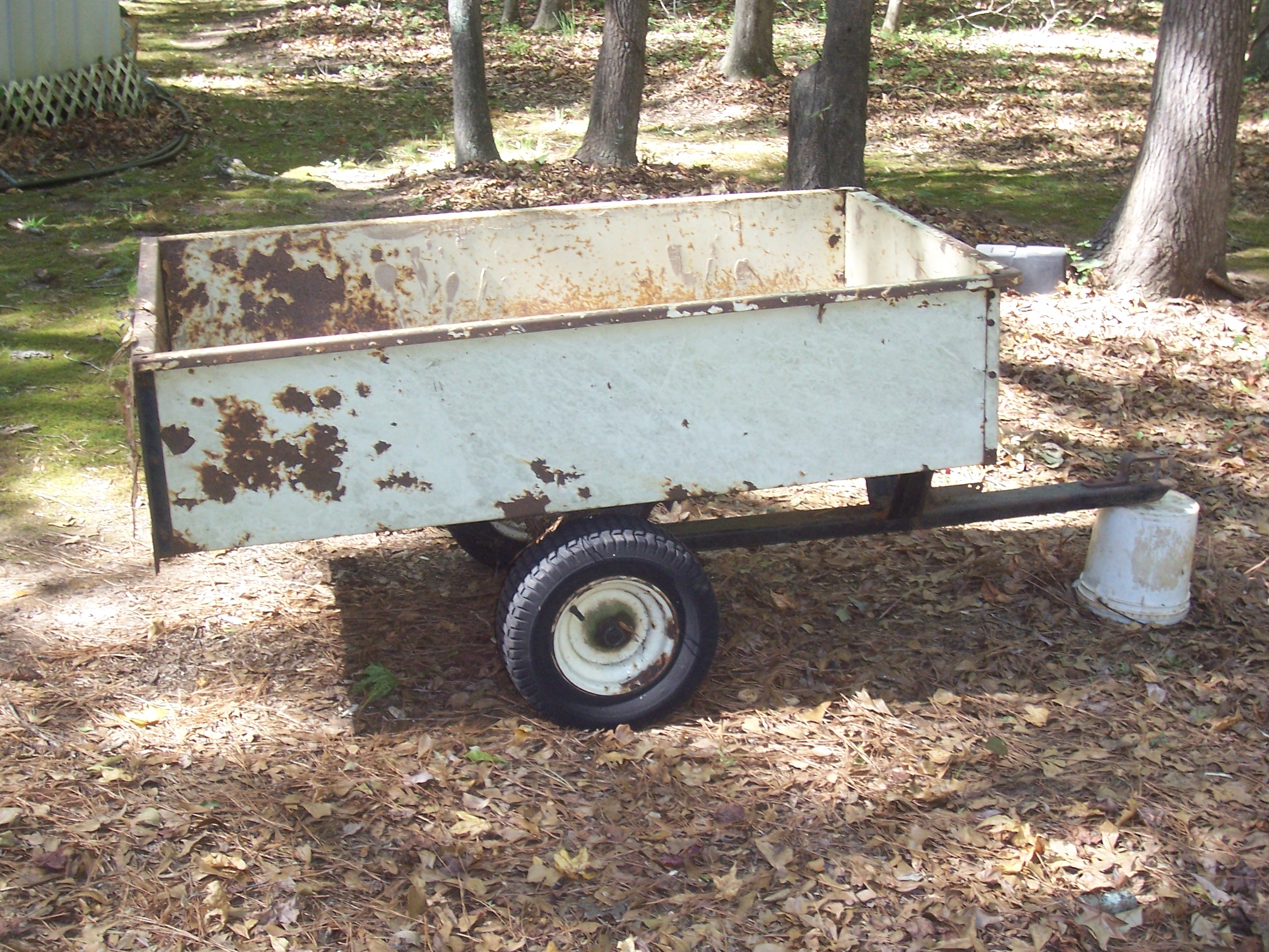

Down force or Tongue weight is the only thing that will keep the 3Pt. arms down on my Yanmar. You can get into a bad situation easy. Not all tractors are like that. Single axle trailer notorious! I've dumped this one serval times.
