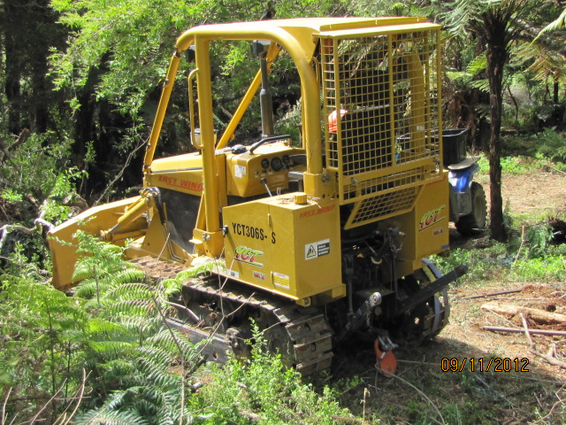

A tractor isn’t a good tool for land clearing. They’re not durable enough for that work. Usually a dozer and excavator is the go to tools for land clearing. But I’m assuming burning probably isn’t allowed there. A mulcher might be the best solution.
Also the most expensive probably. requiring some experience on one. There's a reason why skid steer mulchers aren't cheap and readily available for rentals.

Four choices:
1. Pile and burn
2. Masticate
3. Sell for bio-mass chips (where markets exist)
4. Crush on site and wait for decomposition (usually done with a small dozer)
I do #1 in the winter and #4 in the summer if it's to dry.

Personally imho I think there are no magic attachments for any tractor to do more than ones capabilities, experience helps allowing you to do more than others on a smaller tractor. I've been humbled a few times buying attachments thinking they'd be the magic unicorn I needed. It eventually came down to more experience and hard work to get done what I needed to do.
