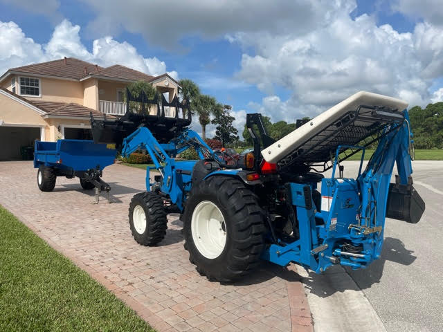

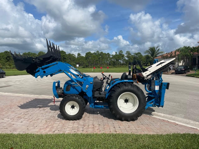

The winch it's installed at the tractor's front, between the bumper and the "blue hood", and the position to spool the winch cable in when the loader is down, the bucket's teeth are anchoring the tractor on the soil and the front tires raised. The backhoe stabilizers could be dropped if needed.
I reinforce the tractor's front frame welding across 3/4" x 4" flat steel bars.
At the back it has the backhoe subframe.
I already tested when some neighbors lose their trees in some storms.
   / What attachments should you use on a tractor to clear land. #59
Is that a luggage rack on your awning?
   / What attachments should you use on a tractor to clear land. #60
Correct, and it's very handy with the cargo net.
