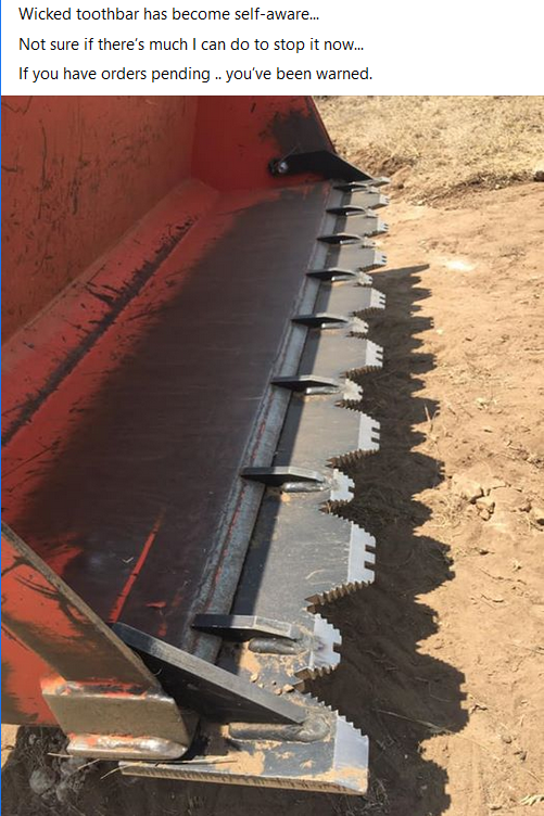

Good deal, looks like that is a easy add on to the bucket.
Yeah, it's very simple! Two bolts.
