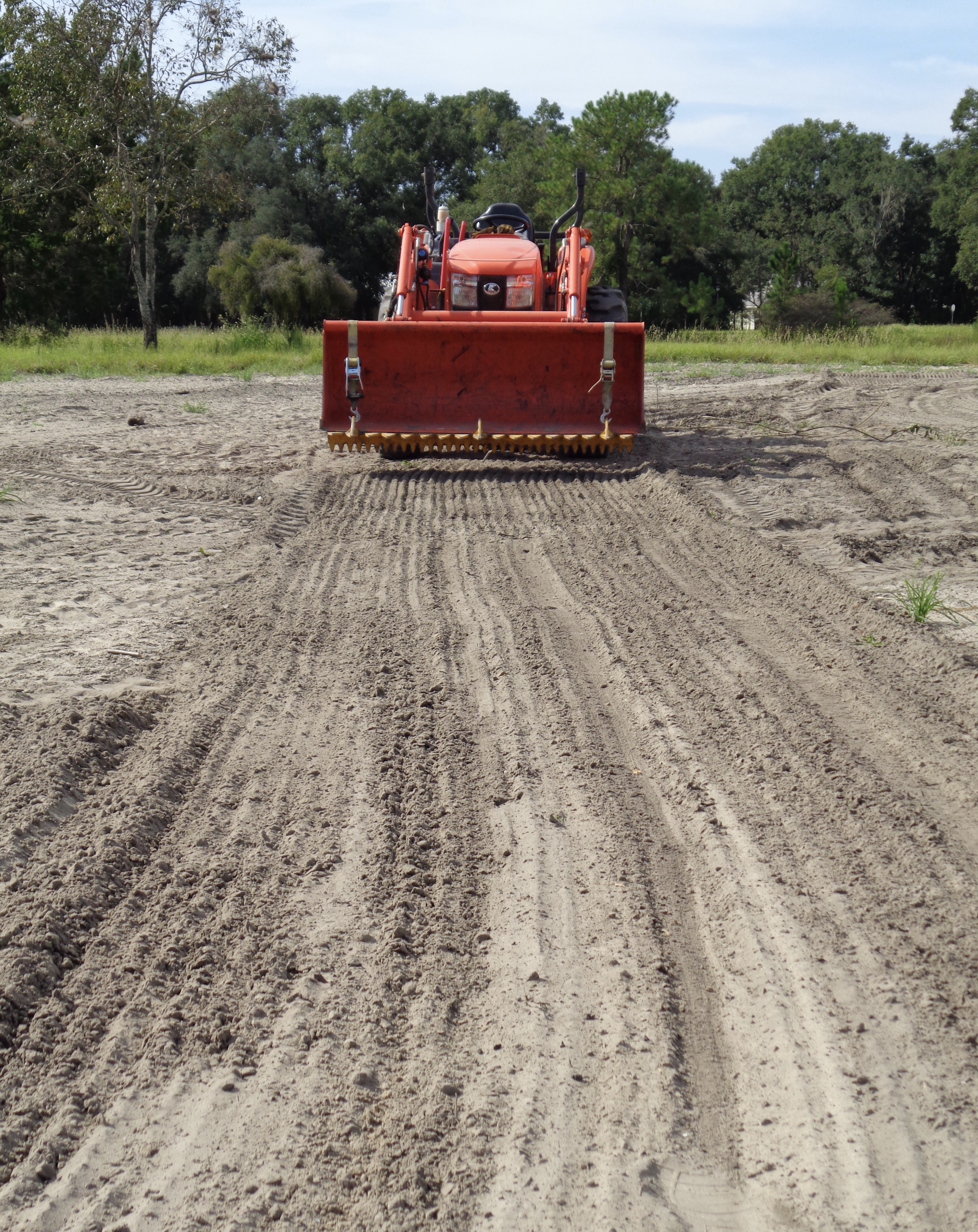

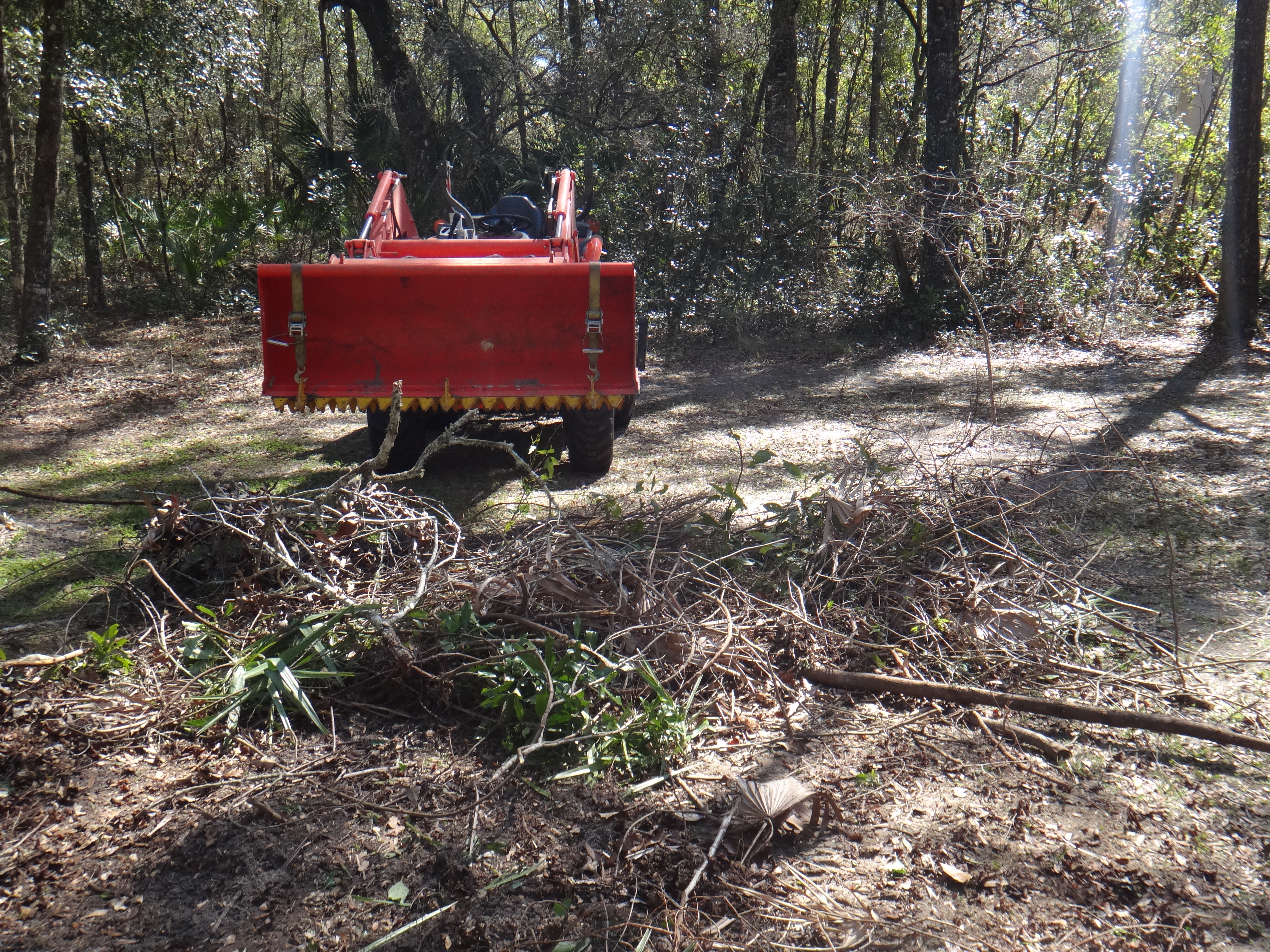

Box Blade is a good implement if dirt is loose. More of a learning curve than you would expect.
As you have a Backhoe, perhaps the best of all counterbalances for FEL work, consider a Ratchet Rake bucket attachment in parallel with a Box Blade.
Much cheaper and intuitive in operation, relative to a Box Blade. Can rake off sod, which a Box Blade is less adept at. No need to remove the Backhoe. Minimal storage issues.
VIDEO: RATCHET RAKE GRADING - YouTube
WEB SITE: Ratchet Rake, LLC - All Terrain Rake, Bucket attachment, Loader, Landscape rake, Brush remover, York Rake, Harley Rake, Rock Rake, Tractor rake attachment, Construction attachment, New Holland, Fire safety, Home fire safety, Fire prevention, tractor implement

are the ratchet rakes really that good? I've seen these before and have been interested.
