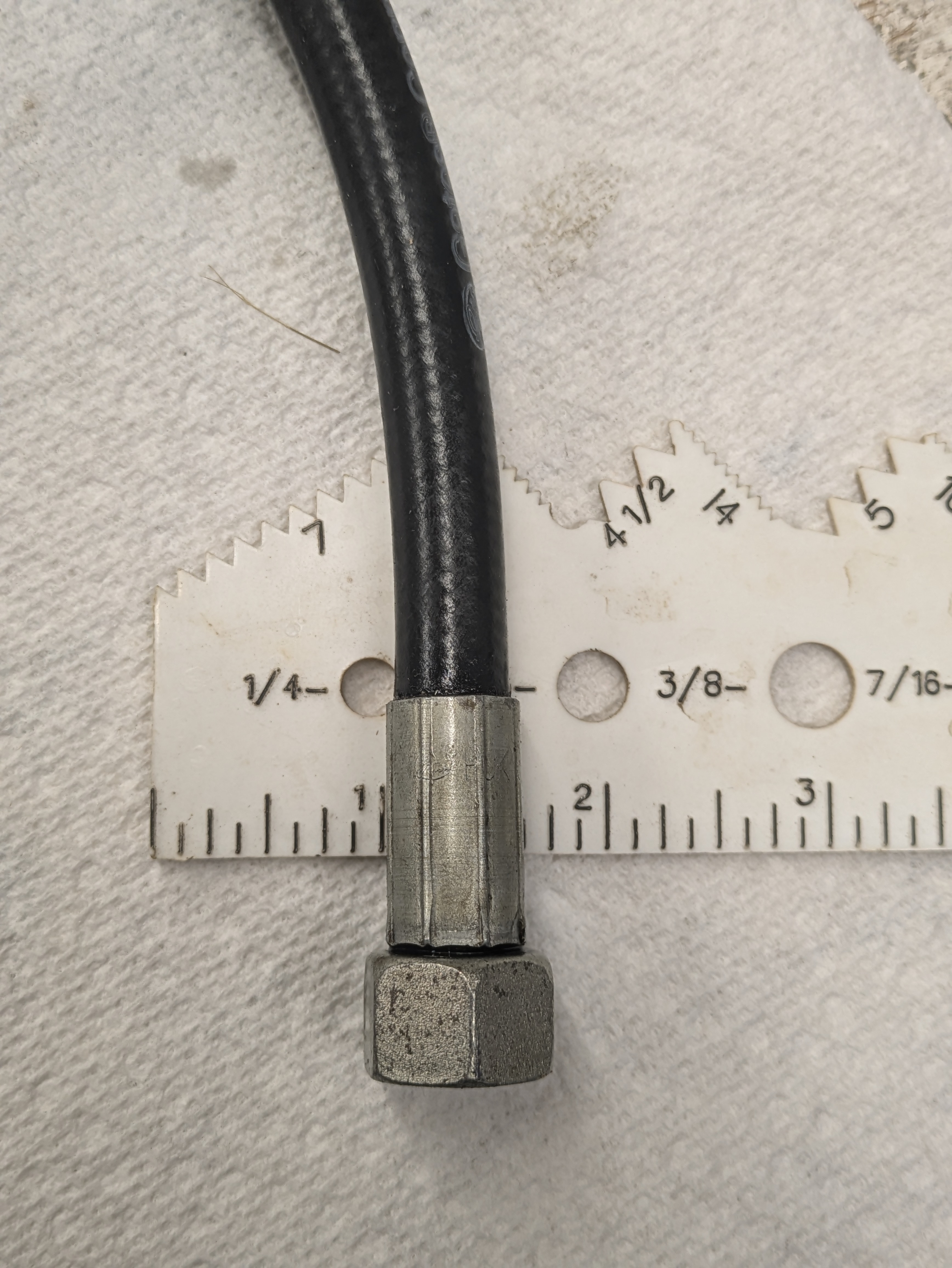

What are these hydraulic fittings called

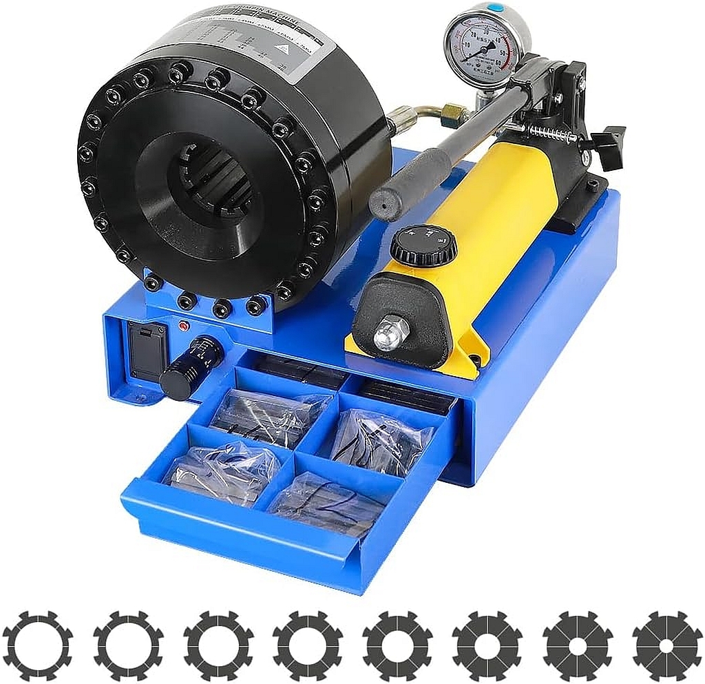

They look like BSP (British Standard Parallel Pipe,) fittings to me! I use them quite a bit! Especially if your machine is English made!
Or Chinese made. I have those on a hydraulic hose crimper I just bought. I'm changing the pump configuration so I can also use my air-over hydraulic pump. It's also using ~5/16" ID hose so it must be metric something or other. My guess is BSPP also. The male side looks like just a tube with a short taper on the entry side. The side that's being held in the OP's pictures is the female side.
Here's my new crimper with eight die sets. (Six of the sets are visible in the drawer.)

I had a hose made up at the hydraulic shop, $85. The invoice has some crazy part number so I still don't know what kind of fittings they are. He did say they don't use that style fitting with orings any more, they just ended up leaking.
   / What are these hydraulic fittings called #39
Google the part number with the words "hydraulic fitting" behind the part number. Somewhere you will be told what fitting it is.
   / What are these hydraulic fittings called #40
It is probably a common JIC connector, which has a 37-degree bevel and is suitable for hydraulic systems and has good sealing. If it is not a JIC connector, it may be a metric or BSPP connector.
