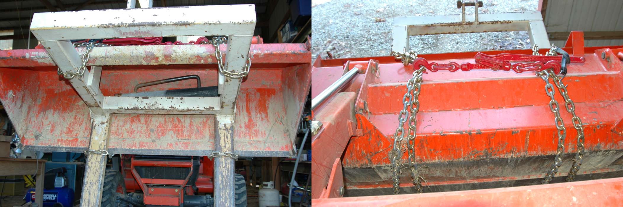

If you want a low cost, tough alternative to pallet forks, here's what I've done on the L3400.
Buy this:
King Kutter Incorporated
Set it in the bucket, use two, ten-foot sections of chain and a load binder to strap it to the bucket, one chain on each side looped around a fork and an upright, and behind the bucket.
If you don't need adjustable or thin forks, it works fine, and fits standard pallets. Works well for transporting brush and logs, too.
I can install in about three minutes. When not strapped to the bucket, makes a great carryall with a pallet on the three point hitch.
Do have any pics showing exactly how you chained it ? Looks like the low budget solution I 've been looking for.

Thanks Foodplot, I also thought about clamp on forks but they and your idea will push the load farther forward reducing they capacity of the FEL.

I'll take a pic. Yes it does move the center of the load forward. However, with the fork chained to the bucket, I can still lift my 6 ft. tiller into the back of the truck, and that extra forward thrust helps the load clear the bedwalls of the truck and fenders of my trailer when side loading.
I also welded up a frame to which the pallet fork bolts, and which replaces the bucket, mitigating the extra weight/reach issue. However, it's a pain to switch, I use the bucket a lot, and I don't need to reach the theoretical maximum lift.

Here's a pic of how I secure a 3-pt. pallet fork to my front bucket. Easy, and most importantly, fast.
