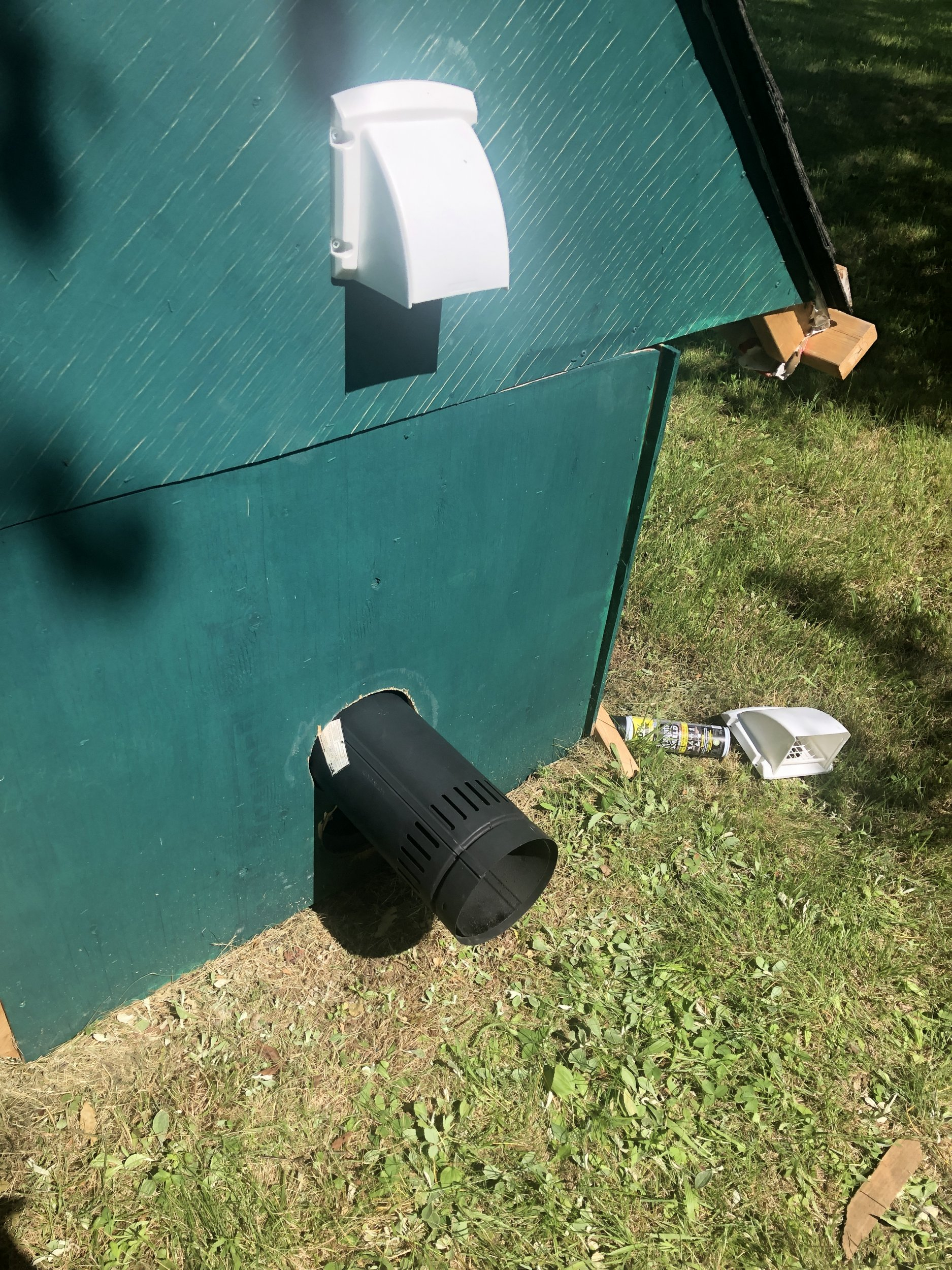

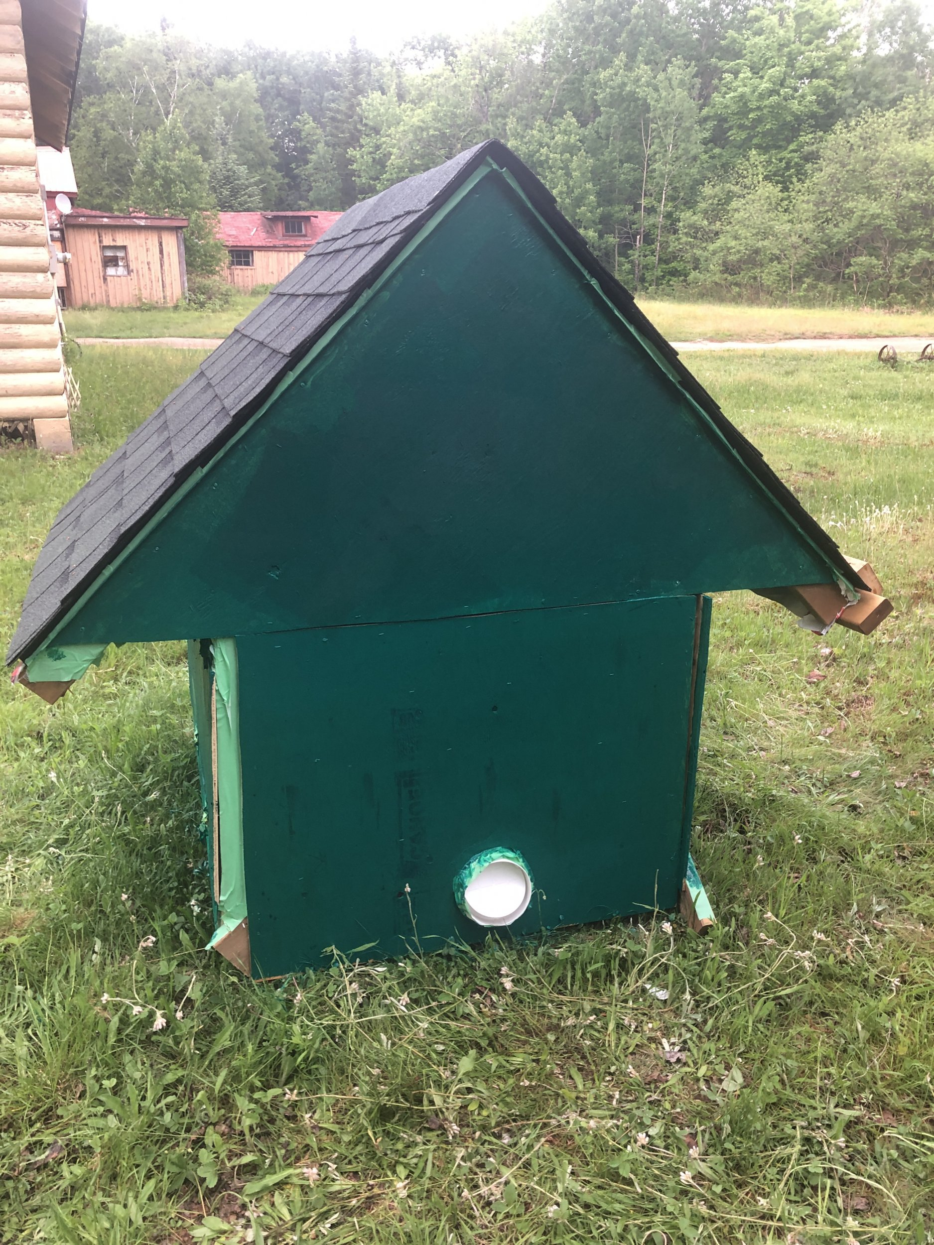

I have one of those Westinghouse WGN 9500s, and so does Daugen. He had problems with his switch, but I have not. Built a shed for it, and put a good amount of ventilation, plus stove pipe for the exhaust.
Looks very nice Genny shade.😂😂😂

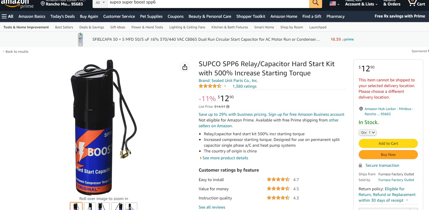

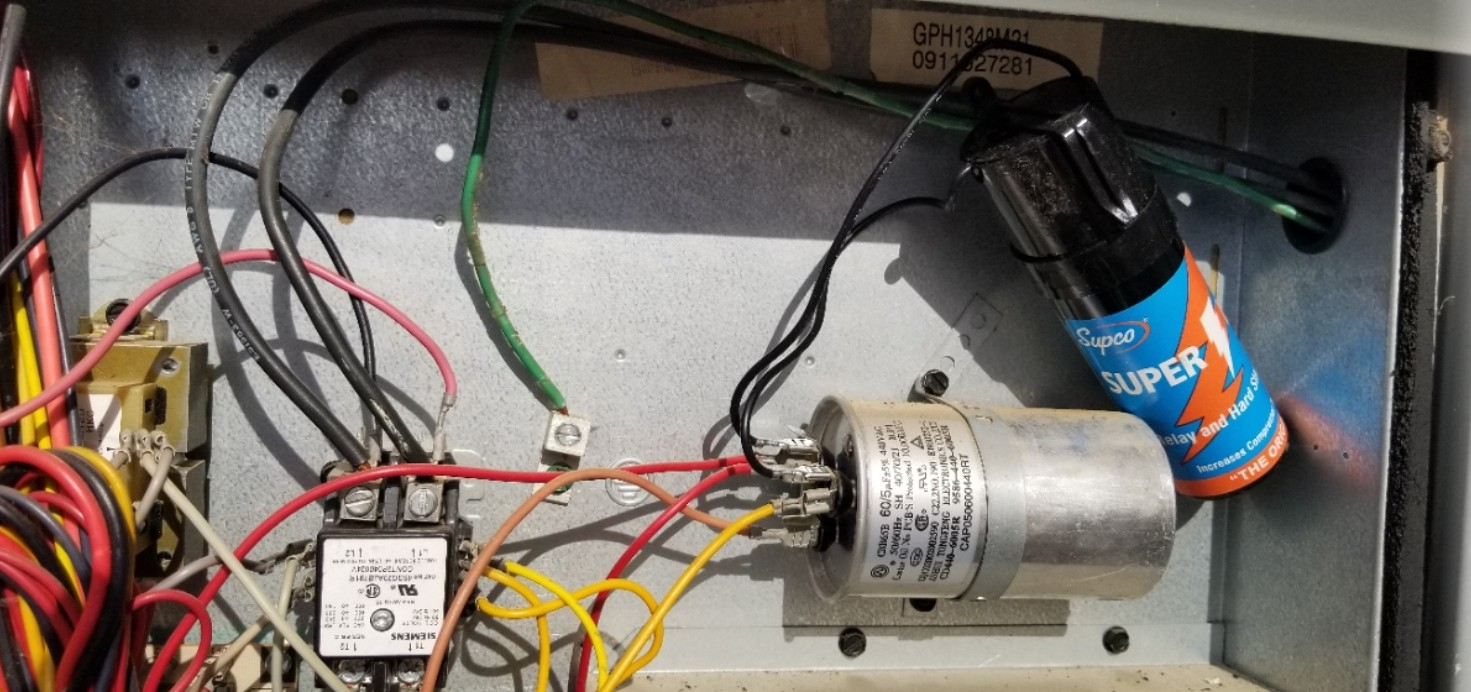

Recently, I installed a SUPCO SPP-6 Super Boost Start Capacitor on a 5 ton heat pump to easily start.
10 days ago, there was a power outage in my area, I tried to run It with the Firman generator.
But only one time was barely running with a super booster.
It makes me quite surprised. 😶‍🌫️😶‍🌫️😶‍🌫️
Also, I have a 2hp 220V well water pump system. It consumes a lot of wattage when it starts and runs.
That is the reason I replaced a slightly larger size generator. (More than that size of portable generator will be stationary that I don't want)
I haven't tried yet because there is no power outage..
Even if the new generator doesn't run AC, I will still be more comfortable than before.
Time will tell... 😜😜
First thing i would do is lose the super boost capacitor. Best way to damage unit. Go look here
these remove something like 70% of starting loads on ac units

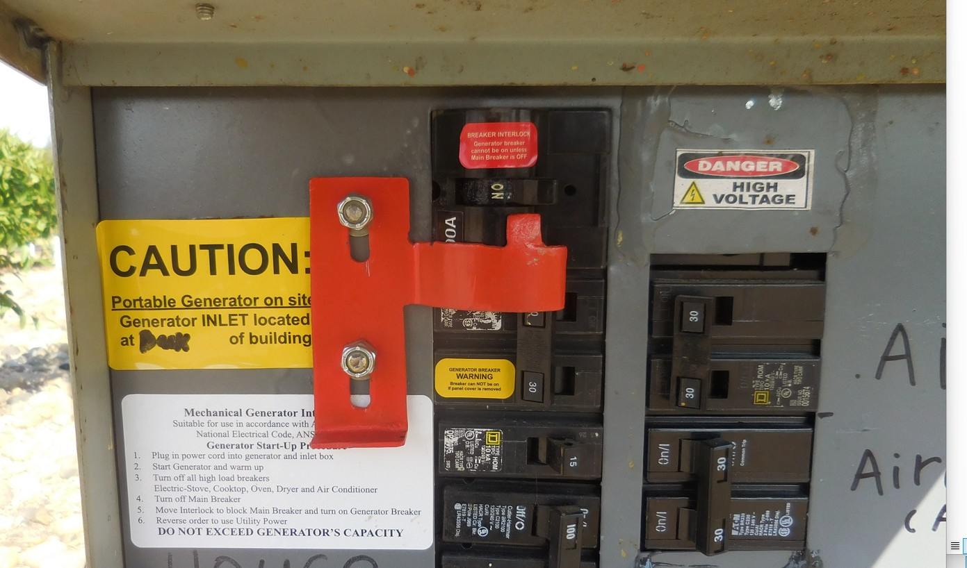

Actually pretty easy to wire your house for a portable generator. Lock out switch, breaker, Romex cable and the box.
I'm into mine for around 1500 and that's with the new generator
   / Westinghouse Generator Model No: WGen9500DF review
#20

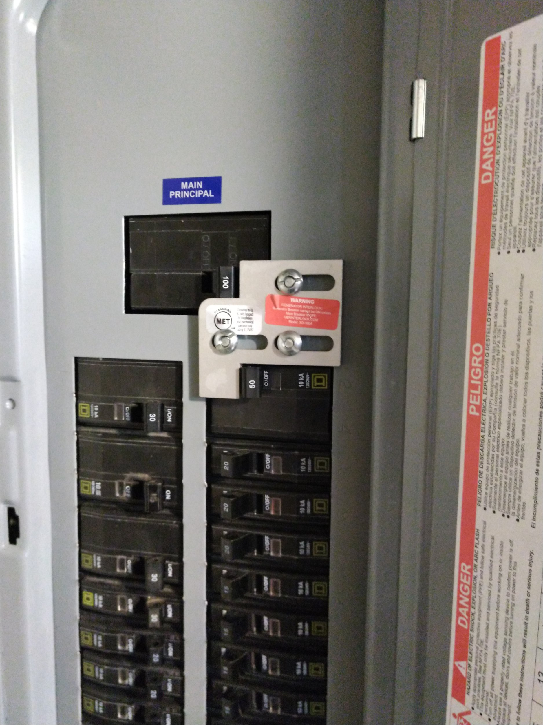

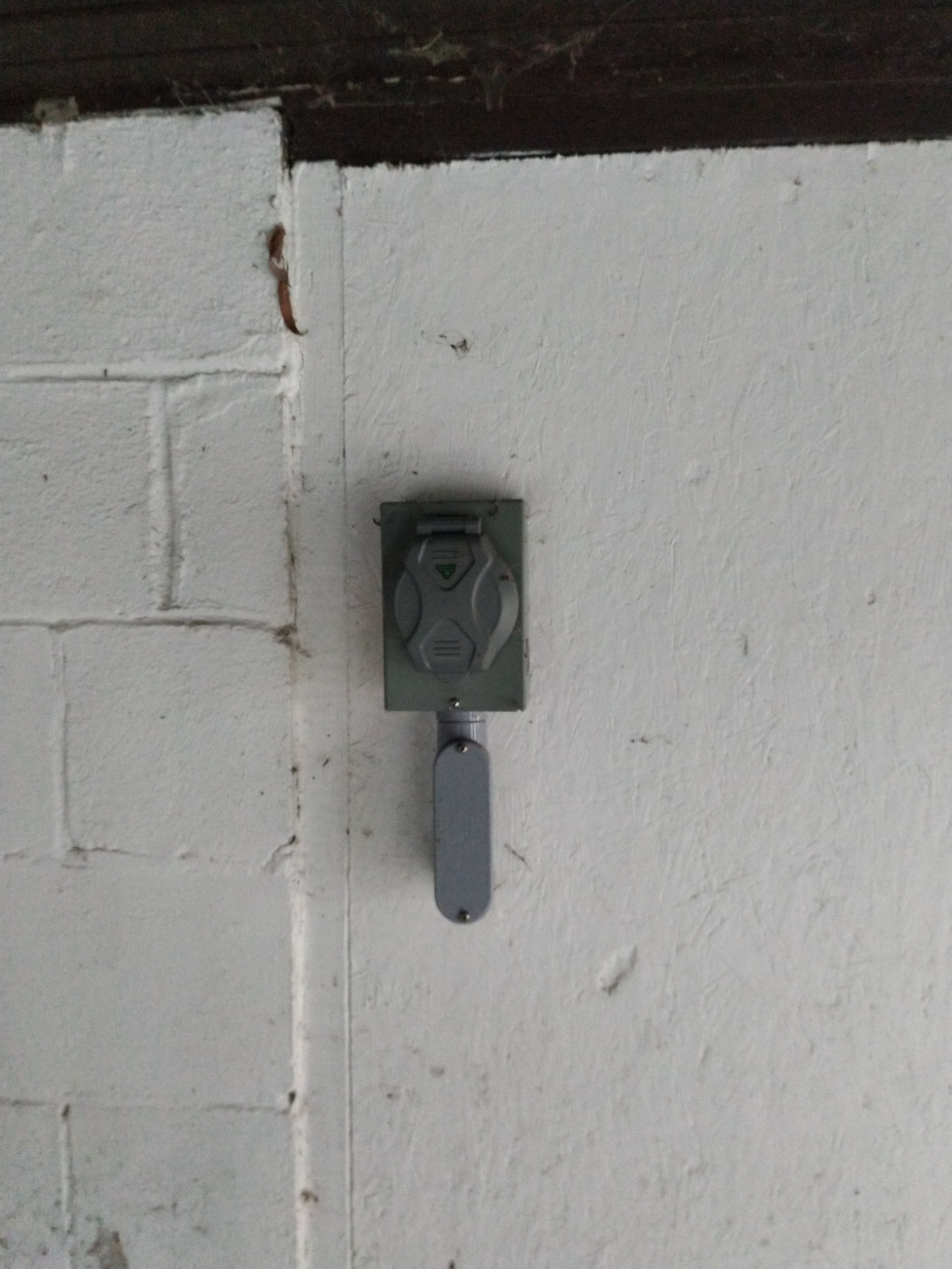

I made this interlock for the main panel because it is not available anywhere.

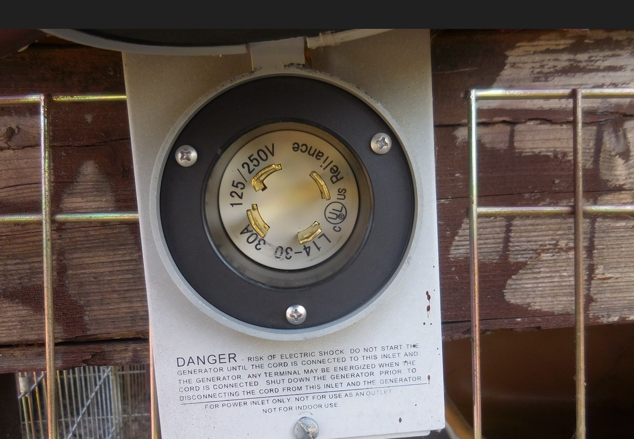

Also, installed this generator power inlet.
Works really well...
