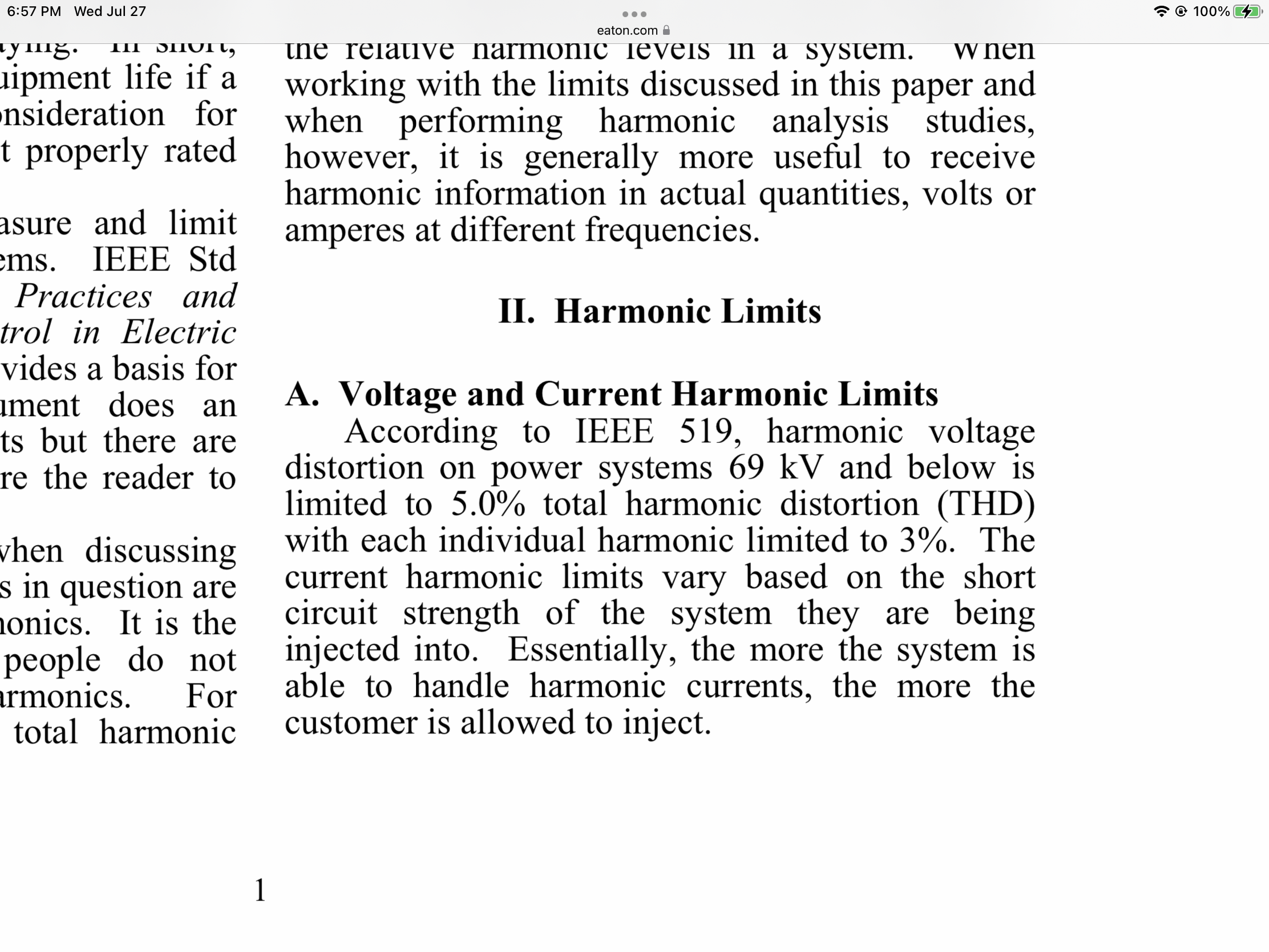

   / Westinghouse Generator Model No: WGen9500DF review #25
I emailed westinghouse to see if thats correct. Seems horrible to me. My briggs and stratton 6500 watt standard gas generator (non inverter) is rated between 3-6% THD. ANYTHING OVER 8 they say can damage sensitive electronics. My generac whole house is rated less than 5%.
mind you, even public utility power isnt free of harmonics.

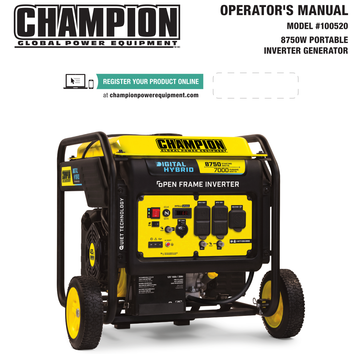

I have a Champion Model 100520 Open Frame Inverter generator, 7000W continuous / 8750 starting watts (surge) <5% THD
I patch it into the 240V house wiring via the 30A Locking (NEMA L14-30R) with an appropriate extension cord.
Runs the well, several refrigerators and a few electronics, including the internet equipment.
Never any problems with it, and I'm conservative with what I run on it. Ran the microwave once for giggles, but usually don't.
I switch off the electric water heater while using it, no need to torture it into submission. Nor do I use the AC.
Many of you have installed an interlock to safely switch between mains and generator power. Unfortunately, my electrical panel is rather old and uses cartridge fuses, so I have had to improvise. At least when I pull the fuse carts, I KNOW I'm disconnected from the mains!

only generators under 5% that I am aware of, not counting commercial or non portable are inverter based. my HF unit per the manufacture is <23% as well. without a measuring tool we can only guess.
   / Westinghouse Generator Model No: WGen9500DF review #30
The harmonics only effect delicate electronics. Using these units with power tools, etc have no issues. No immediate issues with some electronics, but has long term damage. Also, i know for a fact the effect high end heat pumps like Trane, whose electronics lock out at poor power input.
